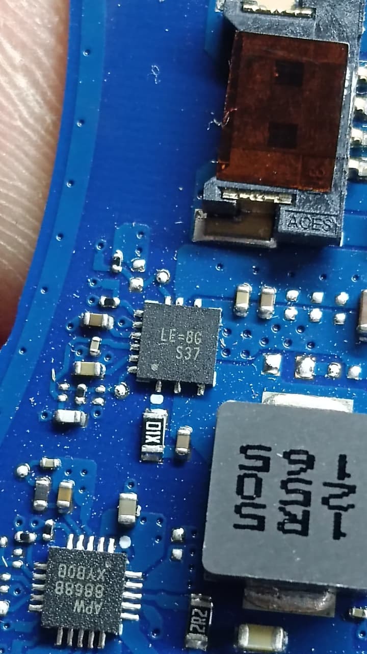

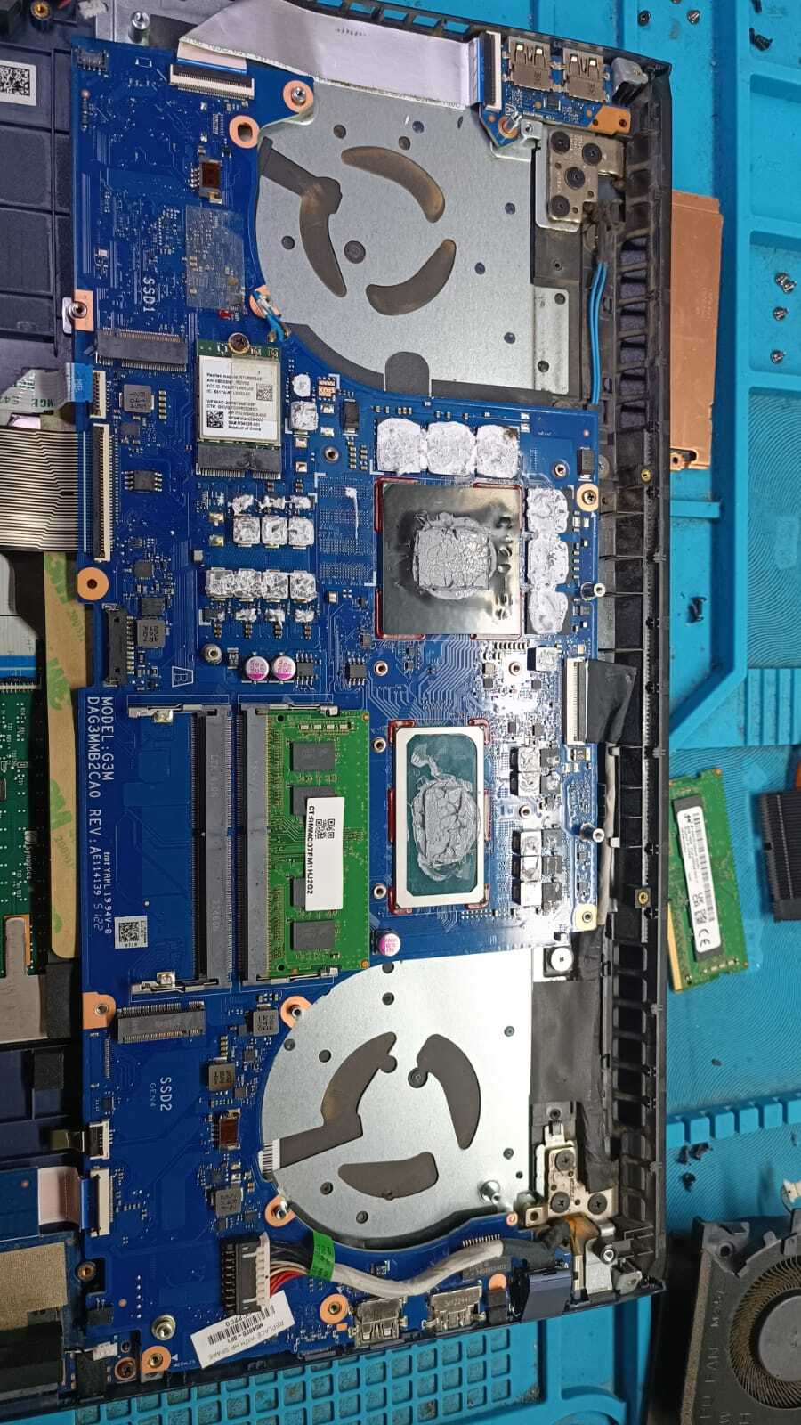

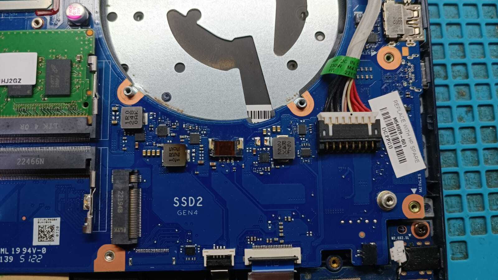

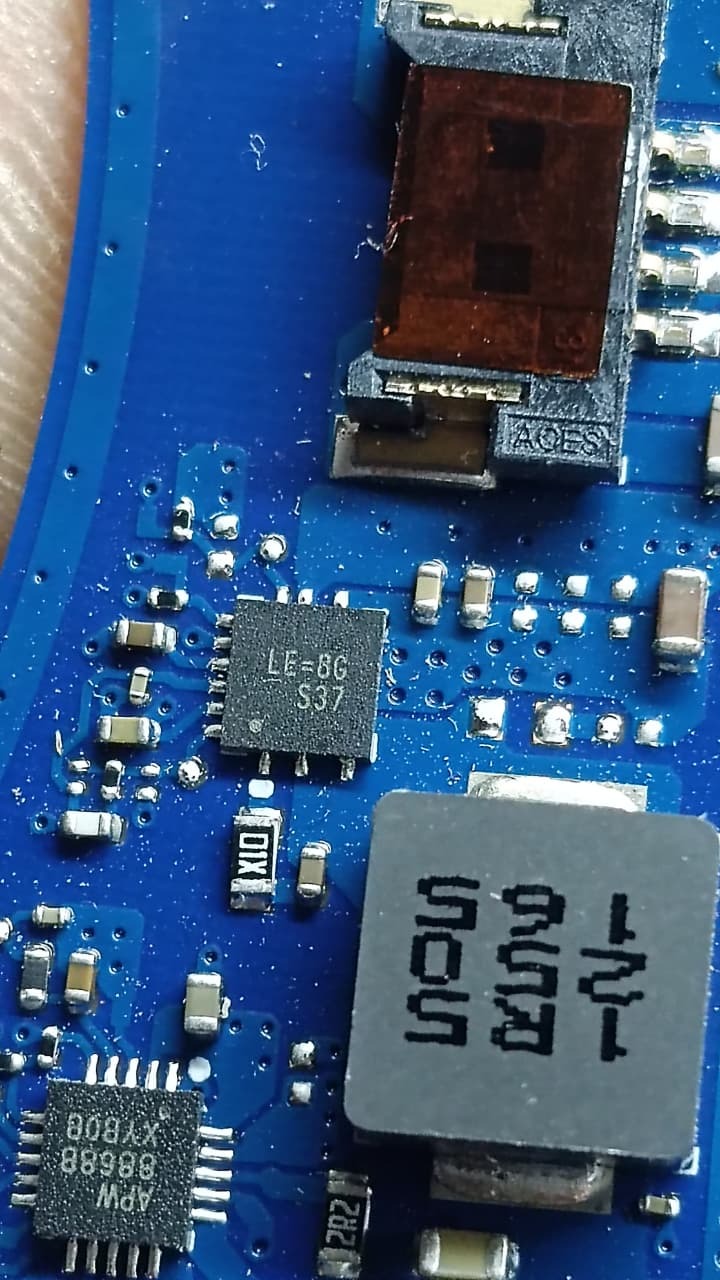

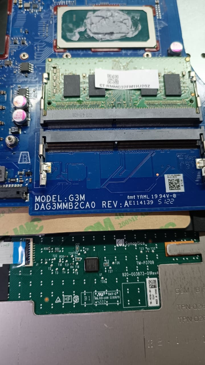

    Hi everyone, I have a big question. Could you help me? I have the dag3mmb2ca0 rev a motherboard, which we already repaired. We replaced a chip that was slightly overheating, and the thermal camera indicated which one it was. We actually had one of the same boards that was defective, so we replaced it, and the machine started back up. We've had a lot of experience with this machine. The charge controllers and GPU components always fail, causing them to burn out (very poor quality). However, I have no way of knowing what the chip is or how to buy it, as the screen printing doesn't indicate the part, just the batch. I need to know which chip it is so I can order it, but I can't find any information about it. I hope you can help me.

    LE=** RT6258B
    https://www.badcaps.net/forum/troubl...d-marked-le-8e
    Please write in english, you can use Google translete
