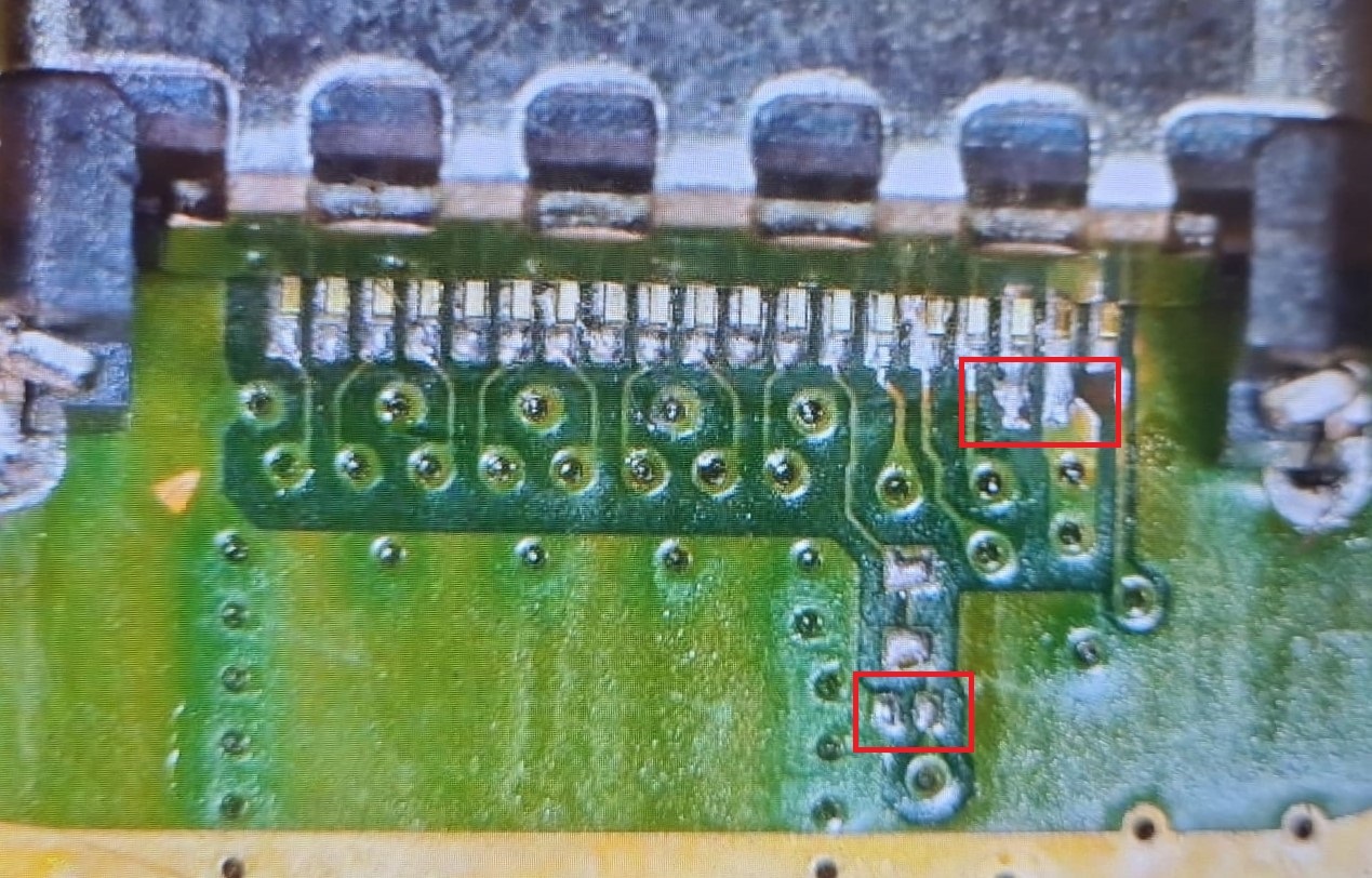

    PS5 Component identification EDM-032
    I recently got a PS5 with an EMD-032 board and someone before me “tried” to change the HDMI port. Unfortunately, a few SMD components are now missing, see image. the top one should be a 100nF cap. but what is the lower (0Ohm resistance?)
Name:	WhatsApp Bild 2024-04-21 um 20.04.43_22c173b7.jpg
  • redbaron1007
    • Jun 2021
    • 117
    Both are 100nf 0201 capacitors. The last ones I bought were 10V so anything in that voltage range should be more than enough.
