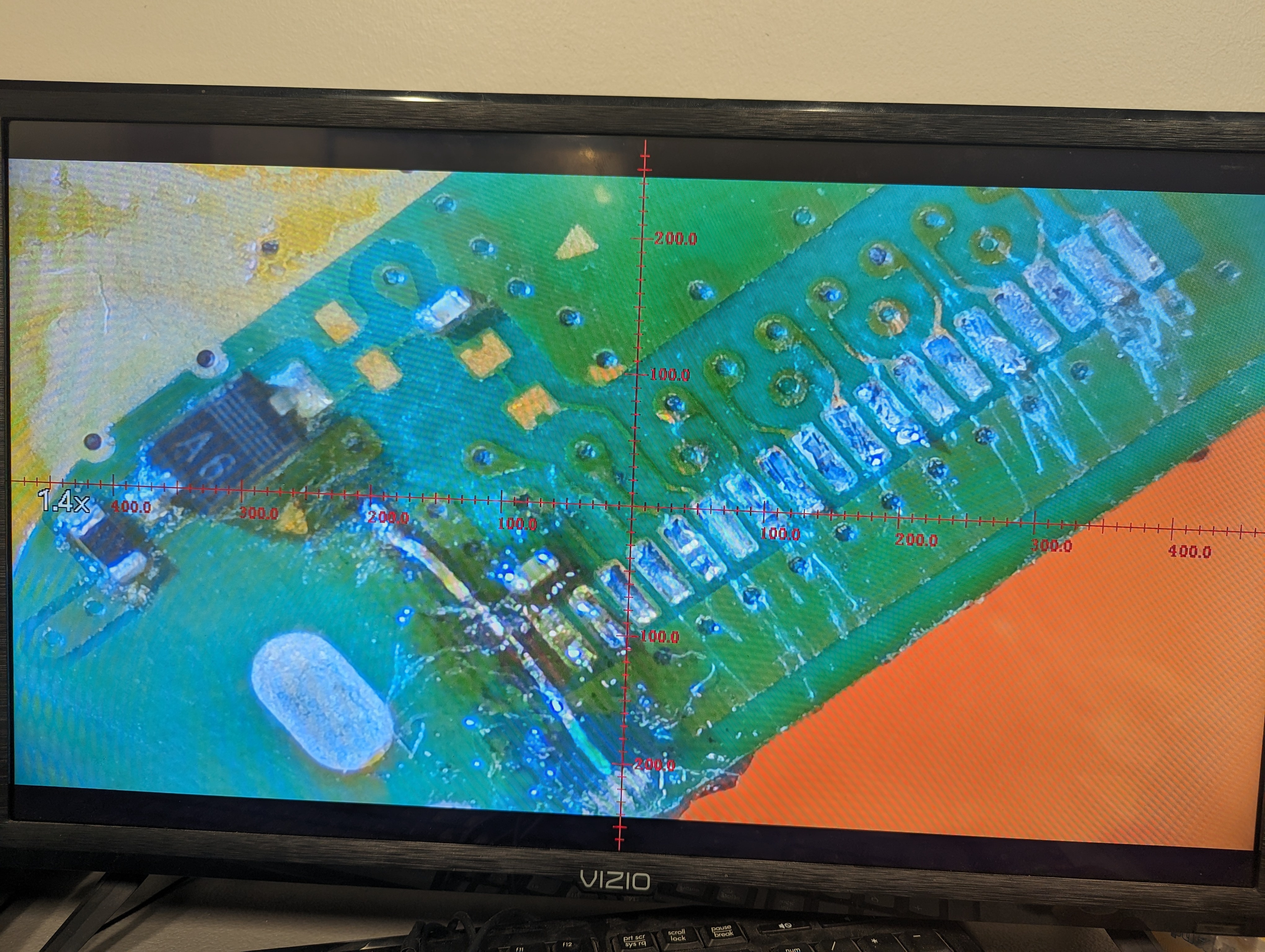

I did an hdmi port repair for a PS5 and I lost the small diode z71 SOD923 on the back of the port. I did a trace repair for pin 19 of the port as well. Without the diode I get no display at all. I tried replacing the diode twice but after I get flux on it the marking comes off so I can't tell if I have it on the right orientation. When I measure I get a reading of 1(open) and 923 in diode mode. Is 923 a normal reading for these and also which side should the reading be with regards to the arrow on the board?

Kindly check for any short to GND. Check in diode or resistence mode of the multimeter.. WITHOUT THE DIODE SOLDERED... & then inform us. There are so many photos of this diode placement on the web, you will easily know the direction of polarity. Or I might receive tomorrow or one of these days, surely will send you a very close-up photo. 1st is check any shorts to GND...
Dear., I am just asking you to leave alone the diode/voltages for now., remove both diode which I think you do not have on the board & then please check the resistance on the pads where the diodes are soldered. I just want to know that resistances readings, NOT THE VOLTAGES... I want to know whether you are dealing with a short before you place in the good diode. One thing I remember when I replaced the 1st HDMI port, 2 pin of this port got soldered accidentally next to the caps RHS near the connector, & when turned on I got NO DISPLAY. I knew something was with the connector, as before, display was present with shake & twice of the connector. Pls. check the pin carefully under the Microscope which I assume you have, Both Hot Air & MS are very important tools to get going & build up a good workshop.
Yeah about 3 of the legs were not soldered to pads on the board and were moving. I tried putting on the port again but still no signal. I have ordered a hdmi port breakout board and I should get it in a few days. I will test all 19 pins to determine the problem. I have a list of the correct reading for the pins. Photo is the pad I repaired before I cleaned the pads and put on the port. I put another diode on and I am getting a voltage drop of about 0.6v. These ports are made so you don't fix them easily, I guess, my first PS5 has been a hassle. My first attempt at an hdmi was on a PS4 like 2 months ago and that was so much easier.

so do I have a bad port? I am also getting a reading on both sides of the small zener diode on the back of the hdmi port I am getting a reading of 0.939 on the anode and 0.583 voltage drop on the cathode. So is the diode bad?
Measure resistances values NOT VOLTAGEs. You will clearly notice a SHORT to GRND on one of the above components. Install a New HDMI Connector & solder with Soldering iron NOT HOT AIR, I am sure some pins at the back are touching each other. Some people solder with hot air but I do not, as the Grd solder not easy to melt at a low temp. & what happens the HDMI connector plastic starts to melt. Remove the old HDMI port carefully. Now to open up the Grnd. holes, all you have to do is, take the hot air, keep it at 300 ~ 350 C which I do & once solder melts take a sharp stainless steel tweezers or anything stainless steel & poke in the holes. Keep melting the solder till you notice that the New connector can easily be inserted in these Ground holes. Then remove the hot air & later remove the stainless steel tool & you will see the holes open up. & one thing more tin the HDMI pins before as your are going to use a solder iron to solder the pins on the pads. It looks hard but all comes with experience. GOOD LUCK this time & hopefully all will work fine. USE A GOOD AMTECH BGA FLUX (WHITE) & you will see the CLEAN PRO result after the cleanup.

Finally got it to work after going thru 3 ports, 2 diodes and knocking off the .1uf cap as well. This has probably been the most challenging repair I've done. With the trace repair and everything that can go wrong on an hdmi port repair going wrong. Learned a lot of things on what to do and no to do for the next time. Thanks you all for the tips. Looks a lot easier on YouTube. 😂
