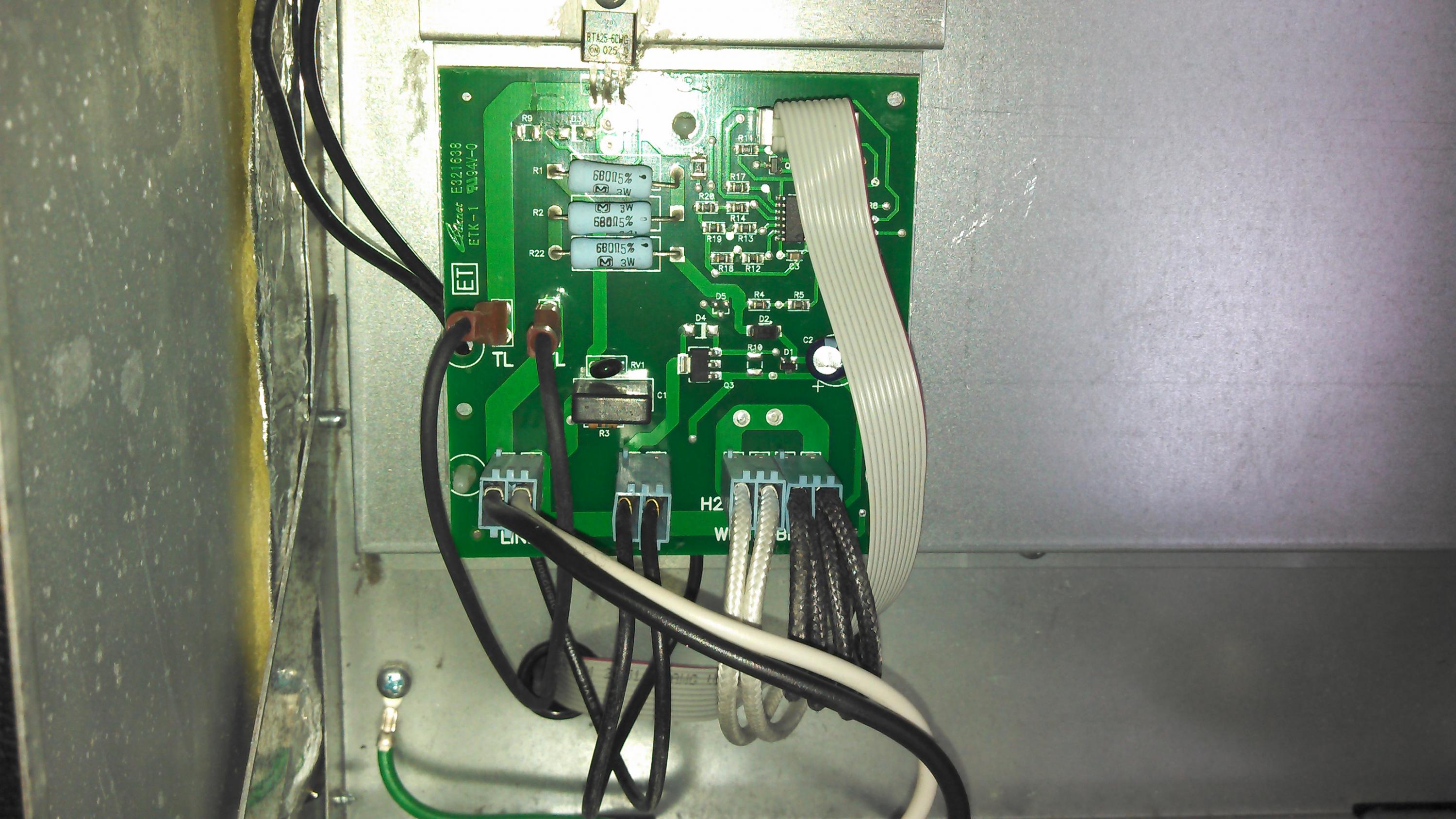

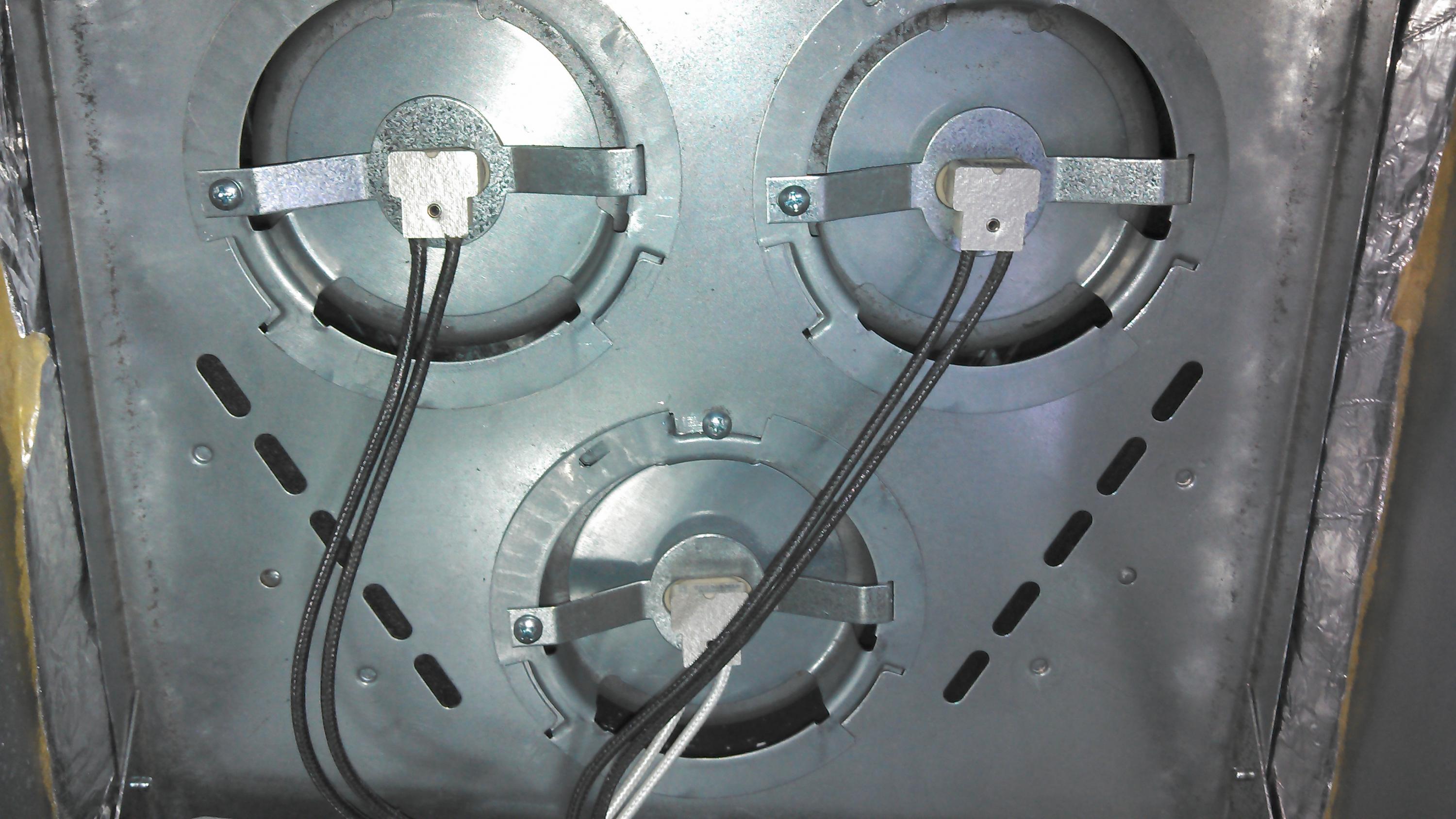

    I received a edenpure USA 1000 infrared quartz heater from my mother in law on the terms that "If I can fix it I can keep it." I took it apart and instantly went to the heating elements.. all 3 were bad, 2 of which were broken (glass tube). I ordered 3 new elements, installed them and the system ran like a champ for the past month. That is until this morning.
    Here are the new symptoms...
    I powered it on the normal LED's illuminate and the fan kicked on as it normally does after 15 seconds or so. The heating elements never heat up. I tore open the case, and ohmed out the elements. All 3 are within the 25-26 ohm range. So they all seem to be fine.
    I tested the wires to the elements, all of them passed the continuity test.
    I then unplugged the element wires from the control board. I measured 22 VAC on both of the jacks that the element wires plug into. (two of the three elements are wired in parallel).
    Long story short, it seems like there is an issue with the control board. Does anyone know of a way to hard reset the controller, or do I have to buy a new board to install??

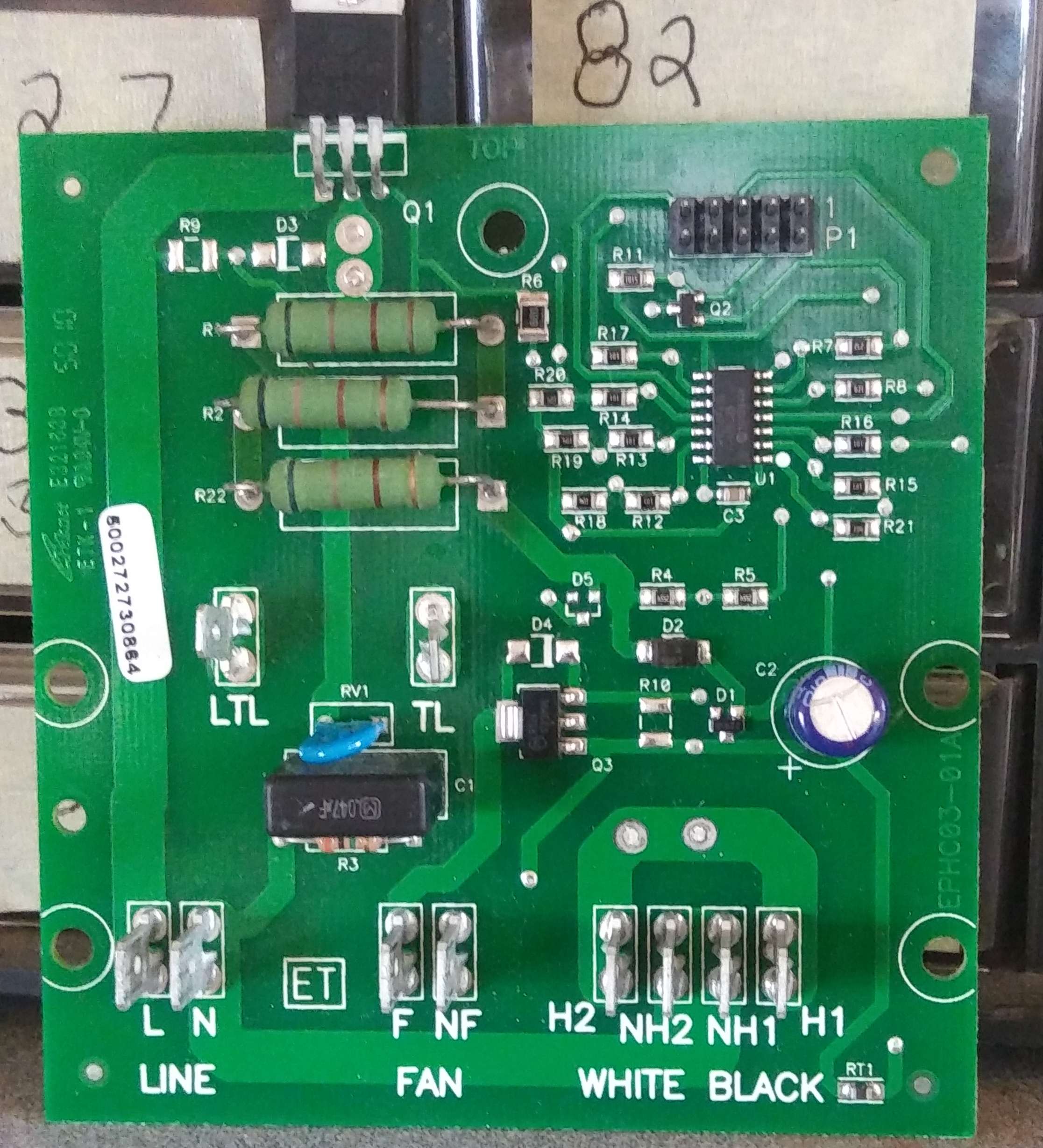

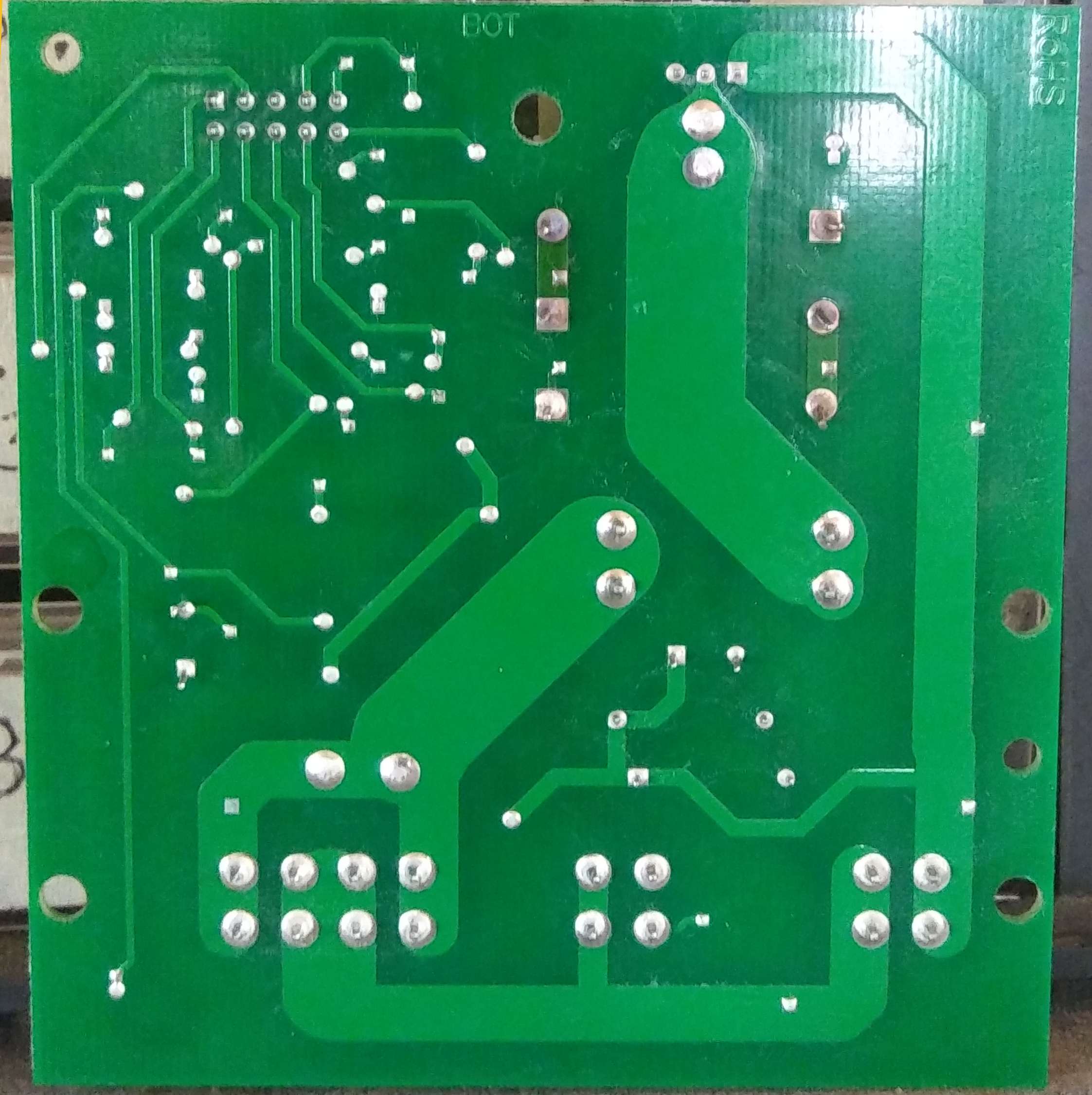

              This is an old thread but I can add some info and will post a pic of the back of the PCB.
              USA1000 model
              Line goes through the Triac and then through LTL to the normally closed thermal switch back to the board through TL to the heating element connectors H1 and H2.
              Neutral goes straight to NF, NH1 and NH2.
              No components on back side of PCB.
              C1 = .047mF
              D1 = ON Semi Z2W
              D2 = 4007
              Q1 = BTA25-6CWG
              Q2 = K1N X9
              Q3 = ON Semi RSN103MN
              RV1 = CKE 1502
              U1 = PIC 16F616
              • Blackcat314
                • Jan 2017
                • 2
                Re: edenpure USA 1000 infrared quartz heater
                There is no fuse of any kind.
                Fan is switched by Q3. uC pin 6 through R8 (621) to top pin of Q3 Line in on bottom pin of Q3 out to fan terminal F from heat sink tab(same as middle pin).
                R1,2,3,22 C1,2, RY1, D1, 2 are the low voltage power supply. 120V AC to low voltage zener regulated DC for uController and front panel circuit board.

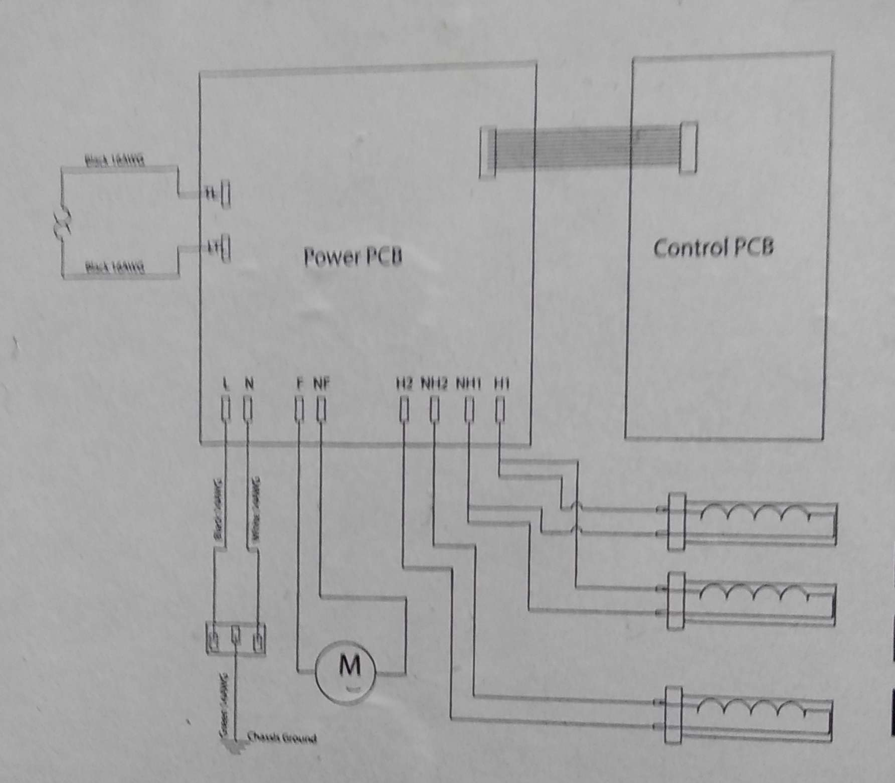

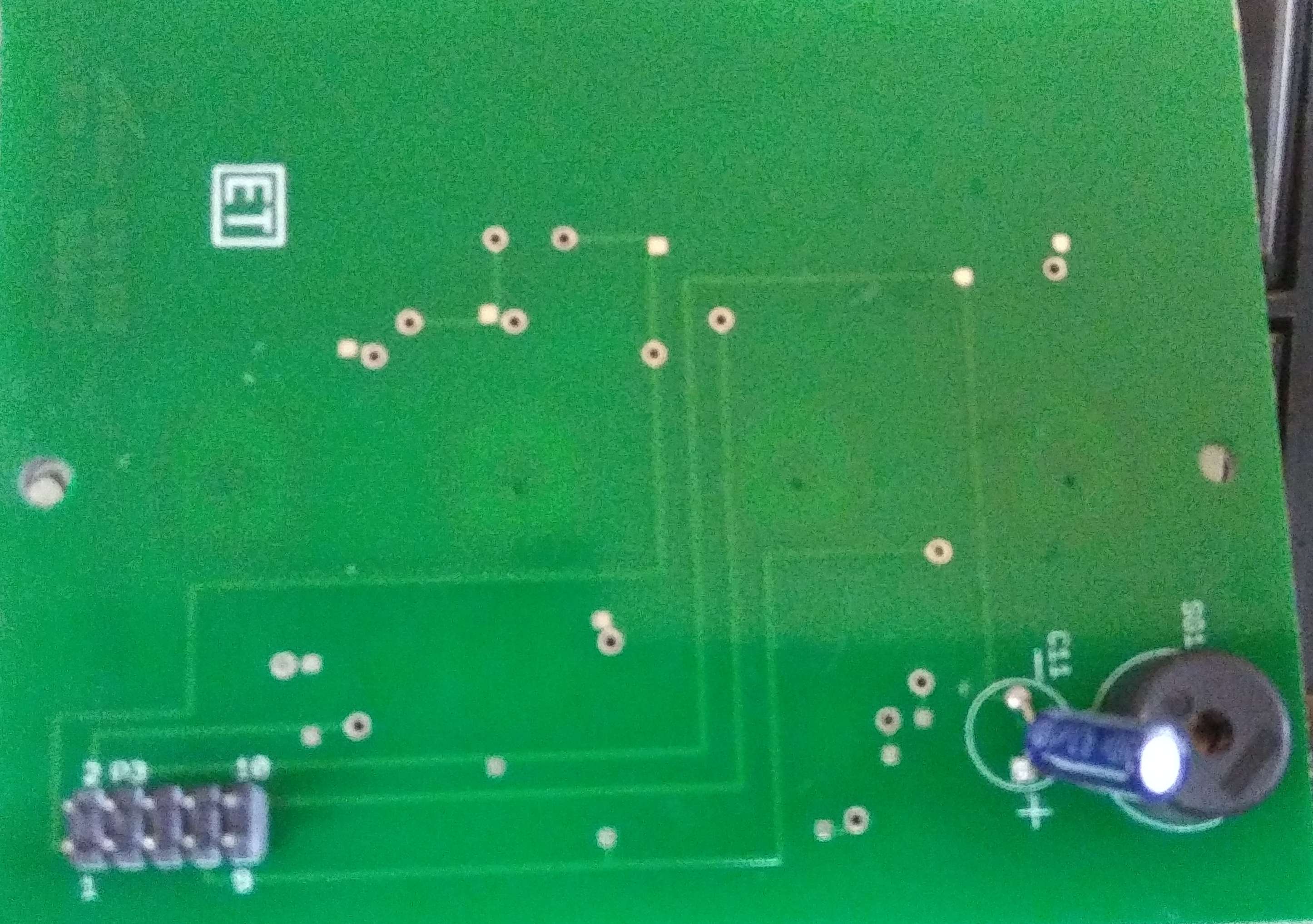

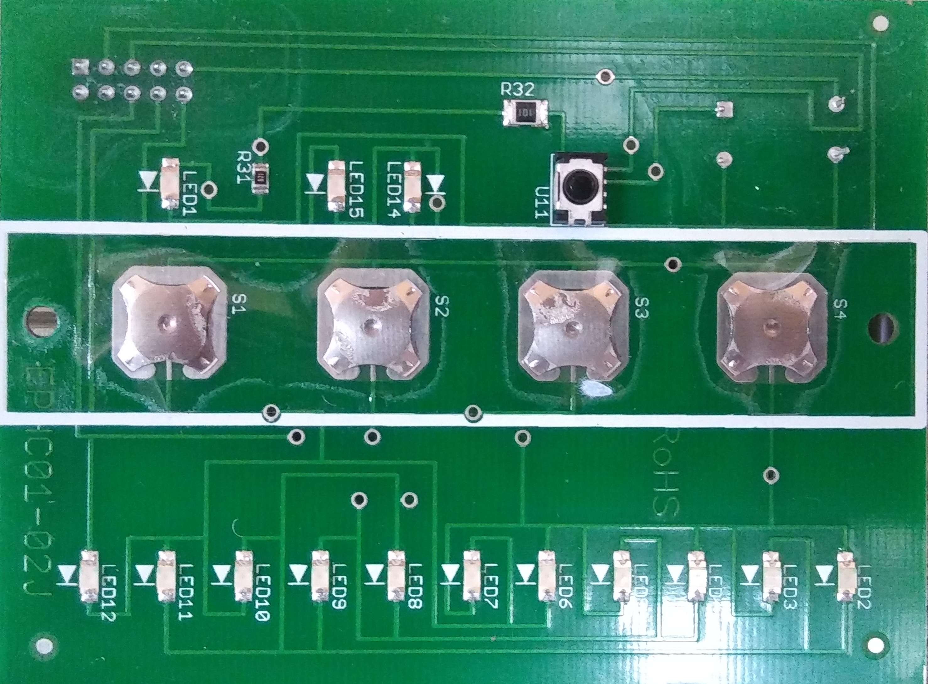

                Pictures of both boards front and back and basic wiring diagram from inside of case.
                  All three heaters are connected in parallel, so good question about the Wattage of the replacement heater.
                  BTW, you should also check and test those three Vdrops resistors and solder joints which are used to drop the AC line to run the low Voltage DC supply.
