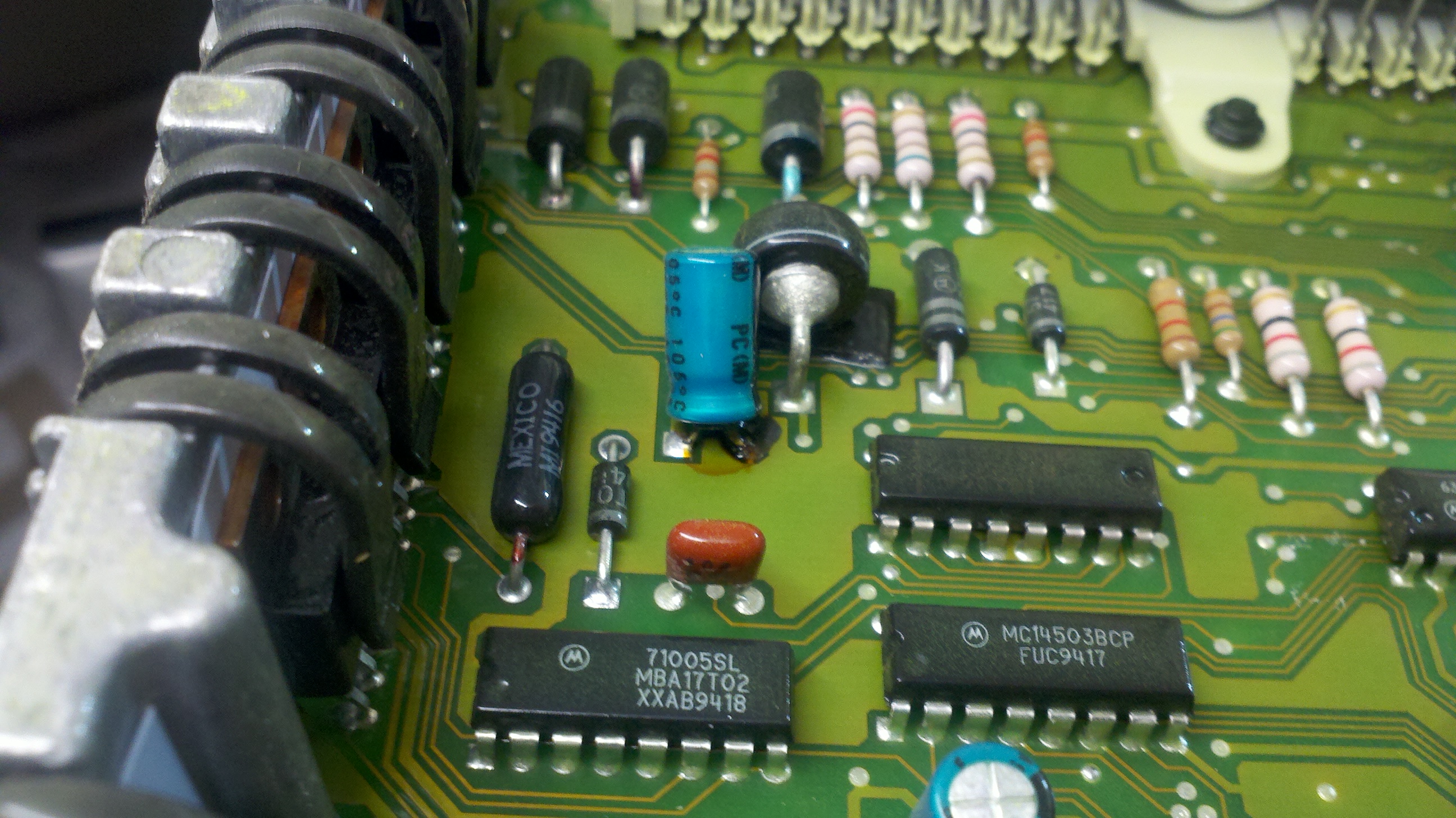

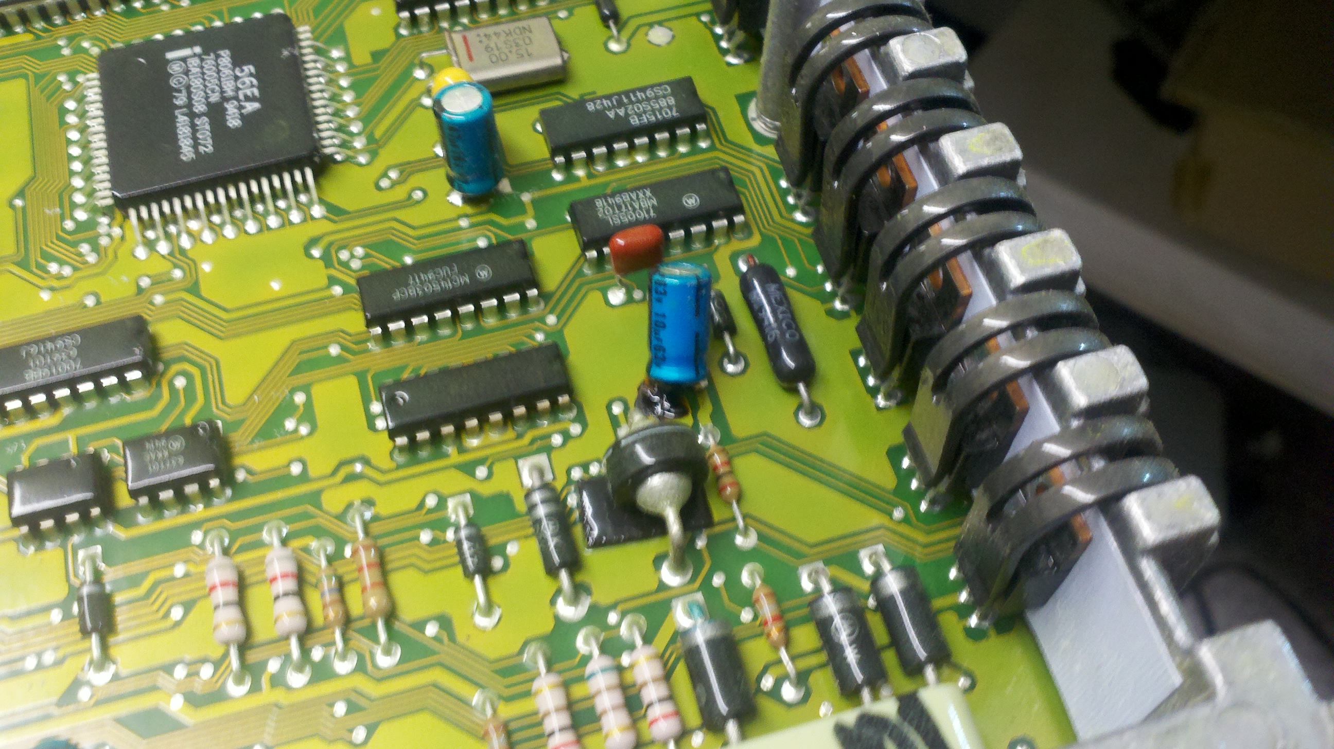

complaint was random stalling,no start,running dead rich.
one was leaking the others open.from a 94 ford f150.nichicon pc are bad for leaking.
