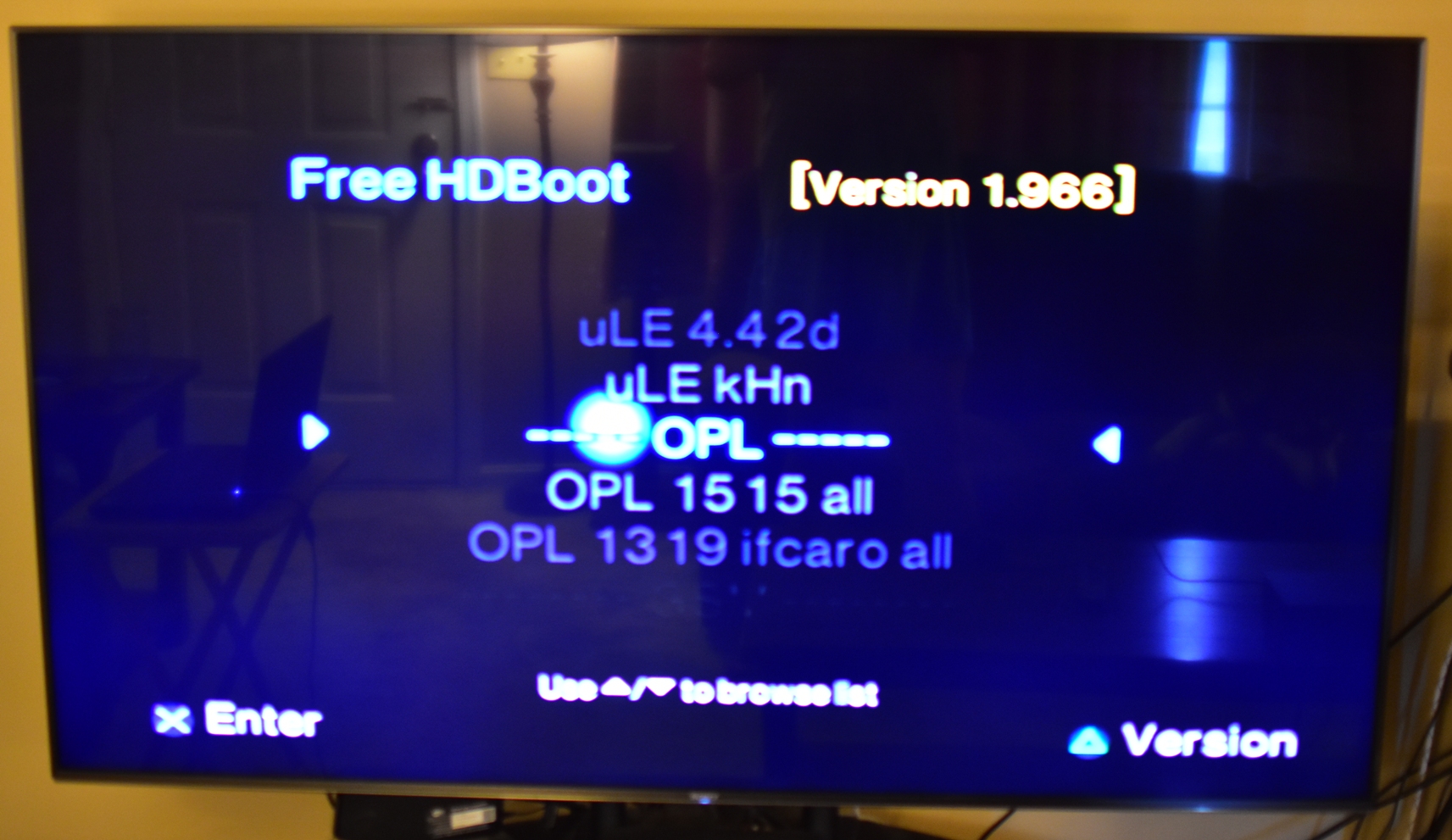

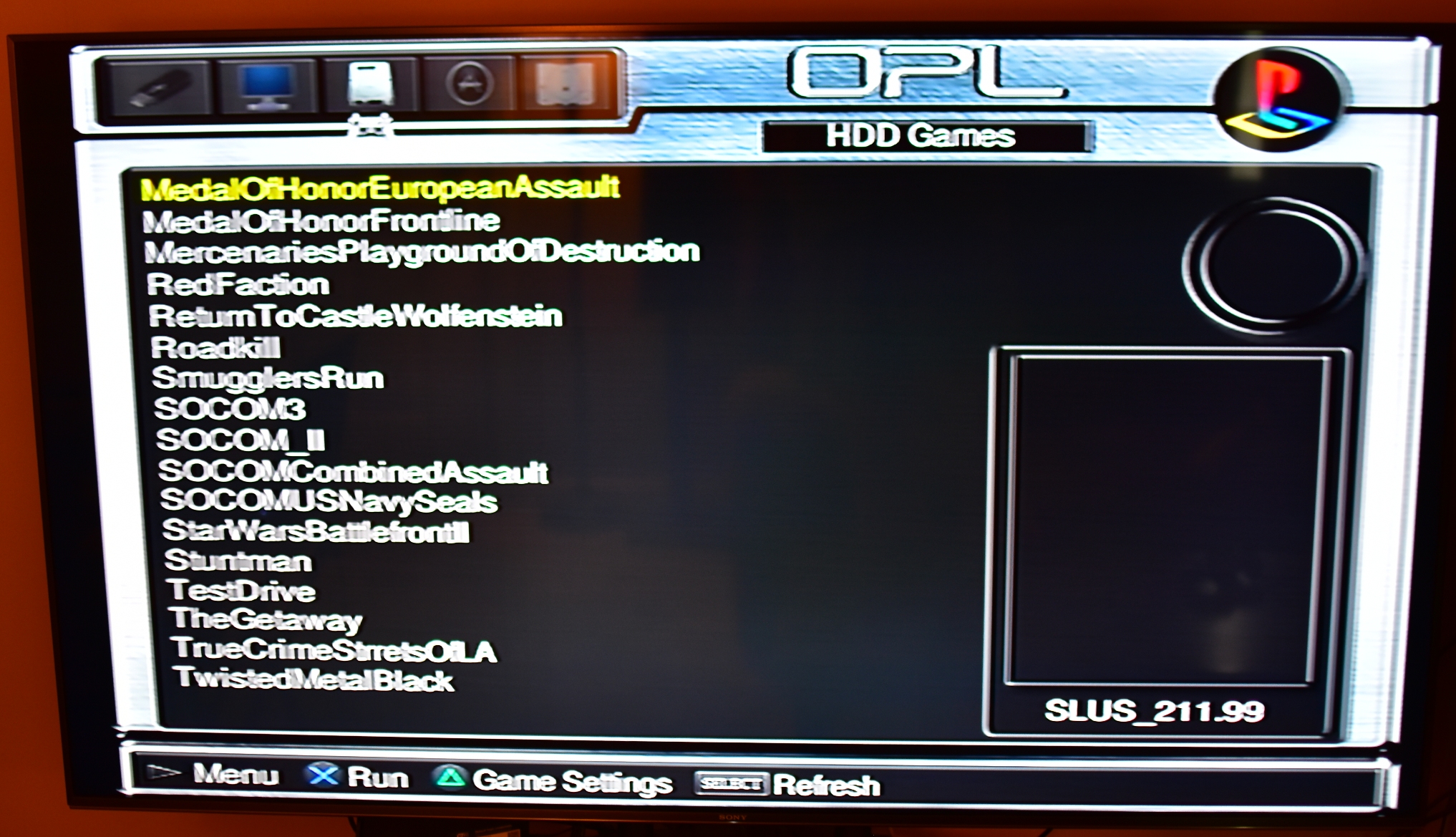

                            Re: Anyone here tried the ps2 slim resurrector ide hack ?
                            Originally posted by foxer
                            chugging a whole pot of coffee works for me
                            The moment of truth.
                            It feels great to play ps2 the right way after all these years.

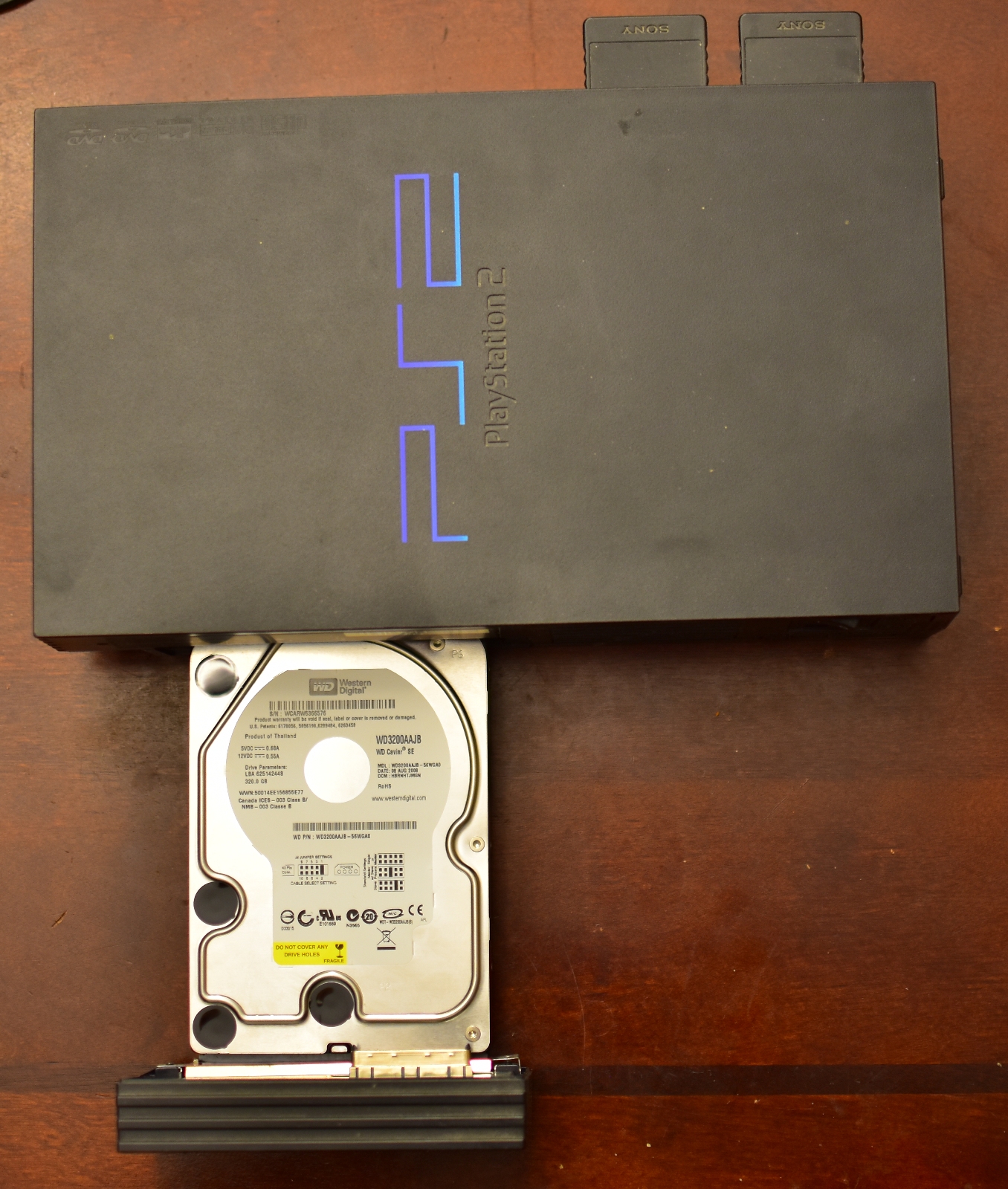

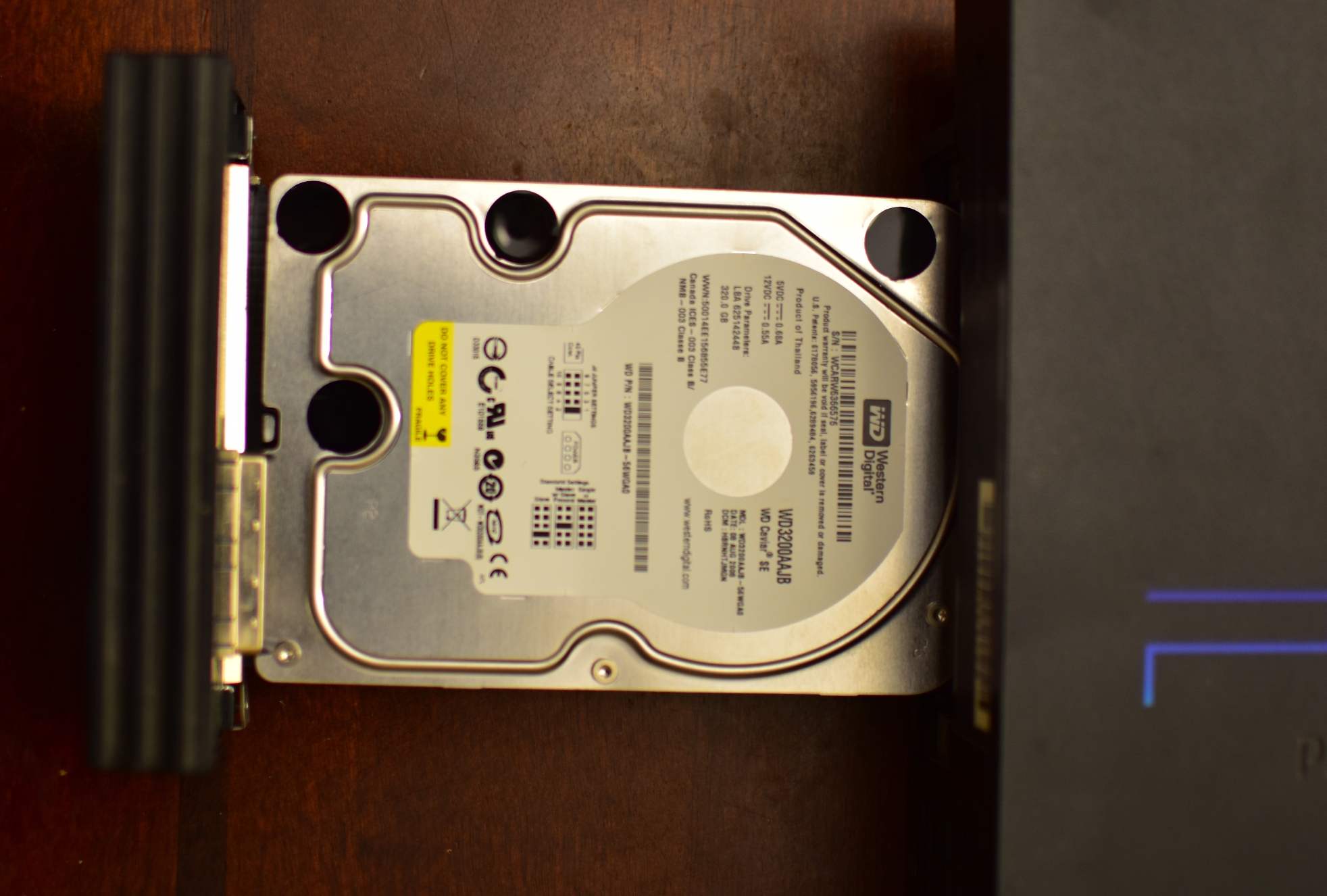

                            • dmill89
                              • Dec 2011
                              • 2534
                              Originally posted by stj
                              is it faster than the usb interface?
                              Originally posted by Dan81
                              Yes, as the points are basically the direct IDE signals found in the expansion port on phats.
                              Yes, especially since the USB ports on the PS2 are USB1.1 which tops out at 12 Mbps (1.5 MB/s) so ATA/66 (66 MB/s) is a rocket ship by comparison and much faster than the DVD drive (5.28 MB/s) as well.
                              X2, though I went the "easy" route with a "Fat" PS2 (SCPH39001)
