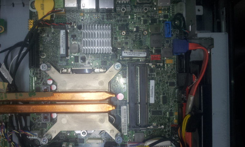

    I was recovering bios of this motherboard ( Intel DQ77KB ) through USB when I accidentally removed the power. Now its bios is totally corrupted and cannot be recovered. If someone has bios and ec of this motherboard, kindly share. Thanks.

        Yes, I removed the jumper before the recovery process and the screen was showing the recovery process when I accidentally removed the power. Now it doesn't boot from USB and the screen remains blank. That's why I asked for ok bios.

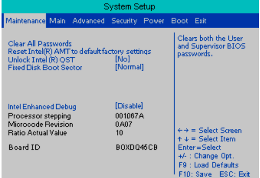

              Unfortunately, there is an administrator password on bios that cannot be removed with the bios config jumper. RC unlocker didn't work. Is there any tool to unlock/ remove passwords from intel bios or if someone can please remove password from this bios? Thanks.

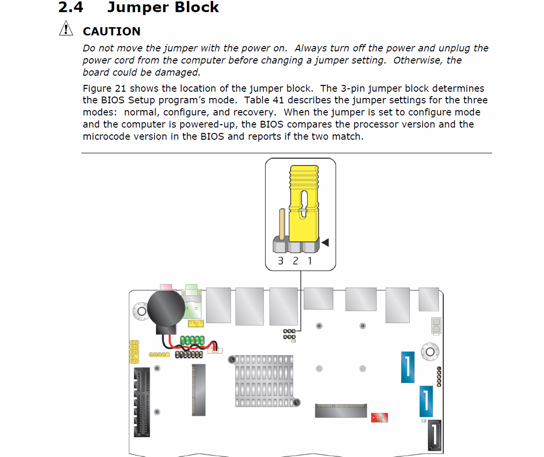

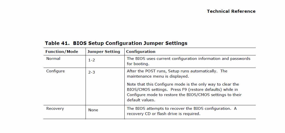

                Note about Intel motherboards. The methods described above are suitable for most motherboards, with the exception of models manufactured by Intel. If you are the owner of the products of this company, to reset the passwords, find the so-called BIOS Configuration Jumper (BIOS configuration jumper) and rearrange it from position 1-2 to position 2-3.
                Close the cover and power on the system unit and monitor, then turn on the computer - it will automatically load the BIOS Setup utility in configuration mode. The main difference is the additional item Maintenance (Fig. 3), which contains, in particular, the option to remove all passwords Clear All Passwords . By selecting it, you will reset forgotten passwords. After that, you must save the changes made (for example, by clicking and confirming your intentions), turn off the power of the computer, turn off the power to it and all peripherals, open the case of the system unit and return the BIOS configuration jumper to its initial position 1-2. To reset all BIOS settings, remove the batteries for 10-15 minutes.
