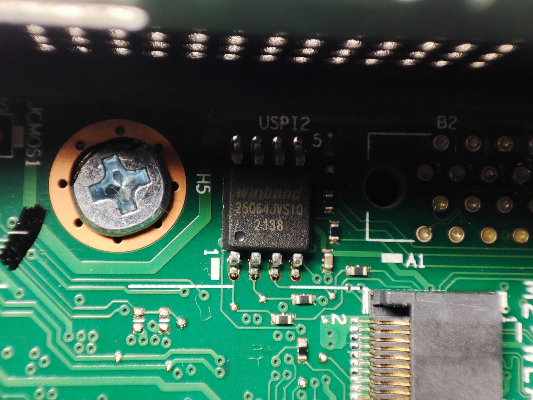

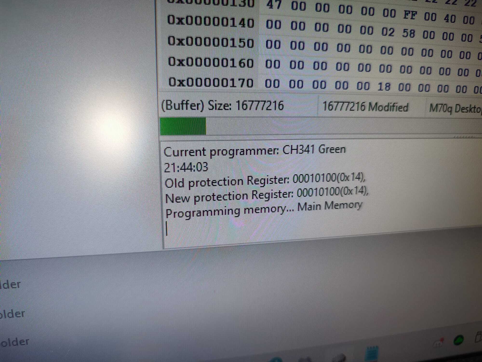

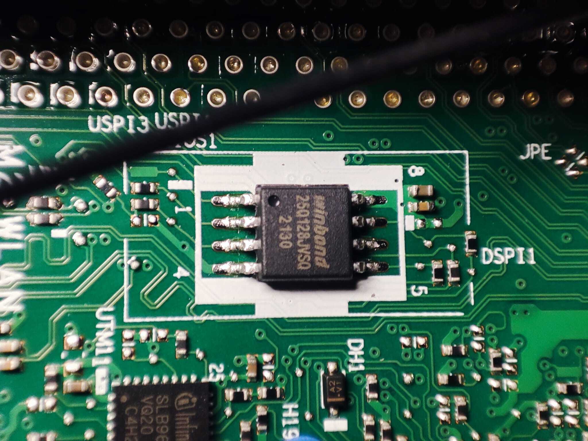

            Lenovo ThinkCentre M70q - 11E8 -- iq4xoil1
            bios chip i read all 2 bios and not able to erase or write another bios, tell me is protecred and in neo programer i press unprotect and do not change nothing
            winbond 25q128jvso2130
            winbond 25q64jvsio2138
            tomorow i put same bios backup if someone know how i make it and what biod is good to pui 8 and 16 thanks

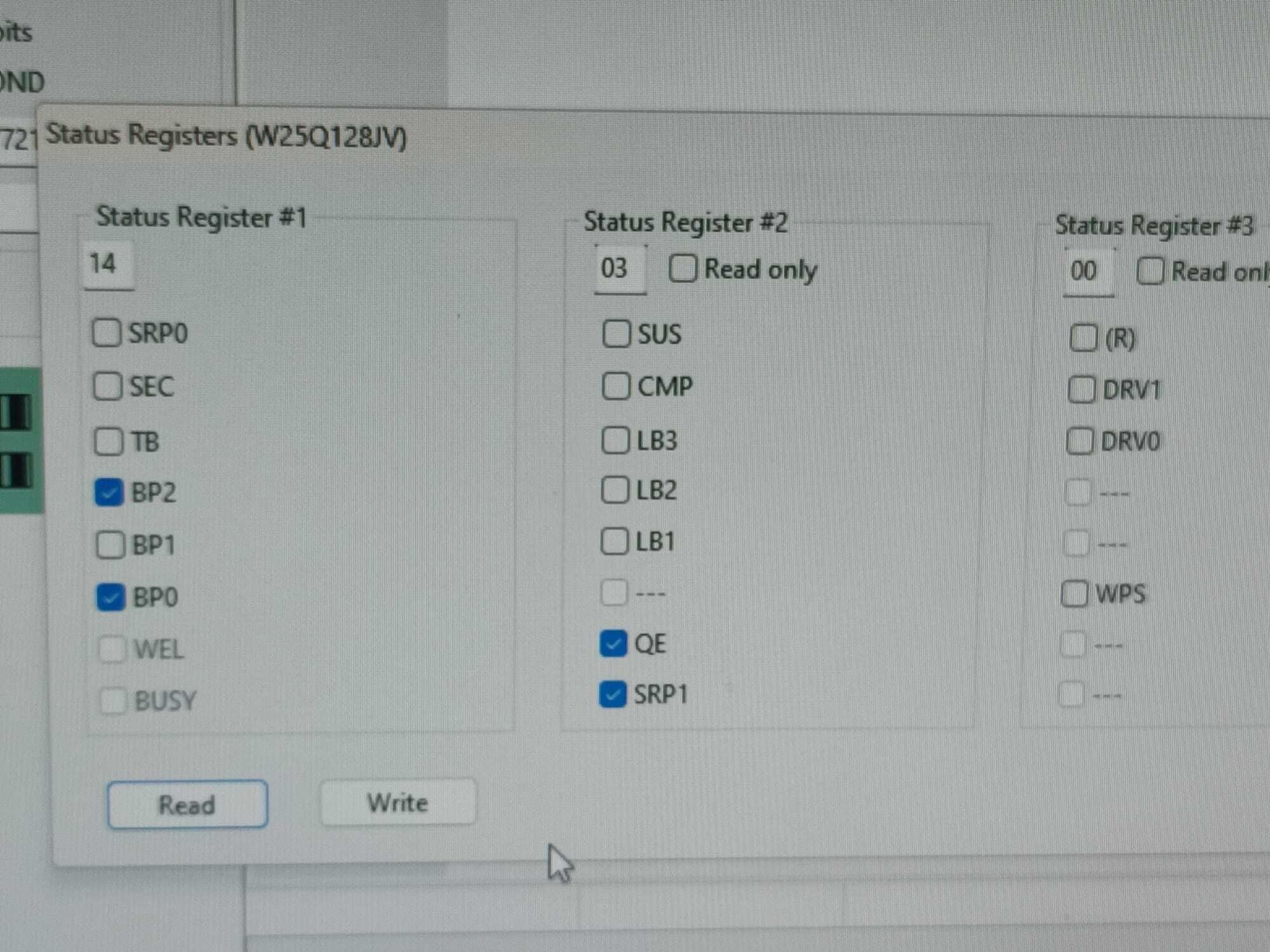

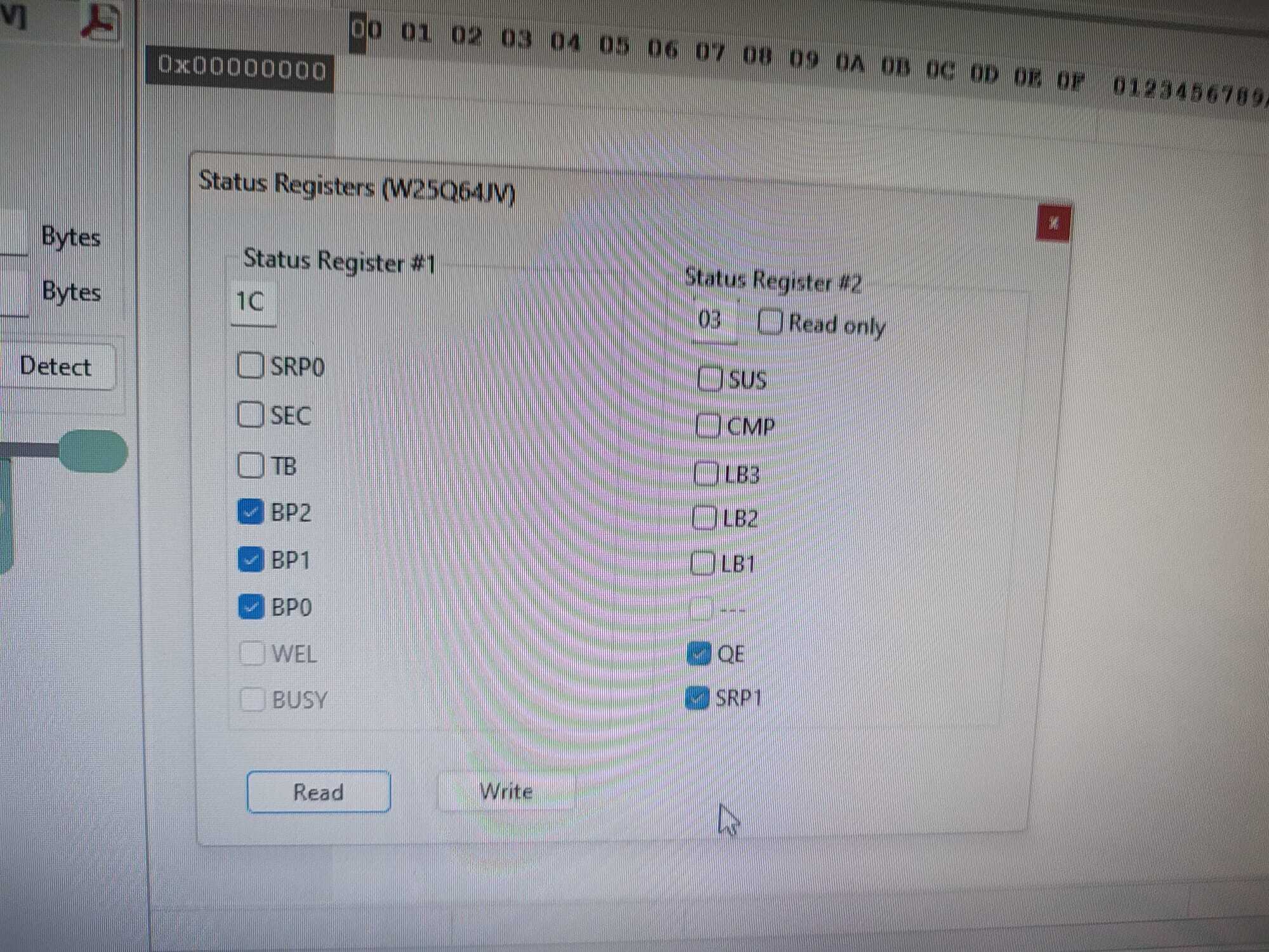

              Lenovo ThinkCentre M70q - 11E8 - iq4xoil1
              SN PC2F0V1M
              winbond 25q128jvsq2130
              winbond 25q64jvsiq2138
              i try to write a clean bios but not make nothing, and at section unprotect nothing i put some photo
              tell me write the bios and after i read is the same bios from amazon
              thanks for help me

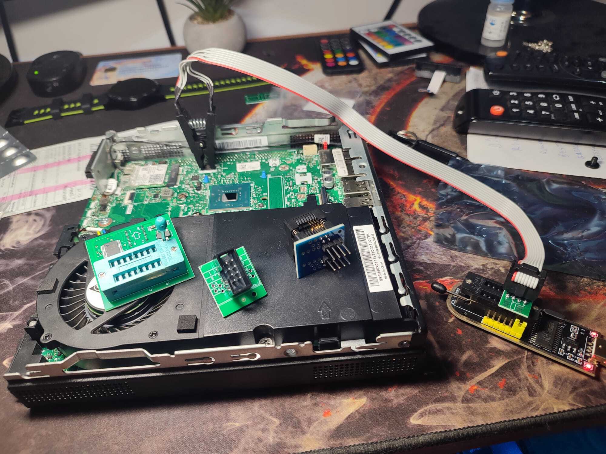

                            Hi there,
                            I have 3 ThinkCentre M70Q, one with the amazon coreboot bios untouched and the other 2 have been previousely tinkered with. Could you please help me get them to work with a stock lenovo bios?
                            The boards are same: IQ4X0IL1
                            The serial numbers are as following:
                            -untouched one: PC2072L2
                            -PC2F0V1M
                            -PC2F0V0N
                            I've attached the dumps for the 16M and 8M chips.
                            Thanks in advance!

                                  #38
                                  Originally posted by hoaca388
                                  M70q Desktop (ThinkCentre) - Type 11E8
                                  I've managed to flash both .bin files to the 16MB and 8MB chip, it powers on for a second then it turns back off. Nothing pops up on the screen. What should I do or how should I go about it?

                                    #39
                                    Perhaps installing Windows on a Chrome OS machine is impossible.
