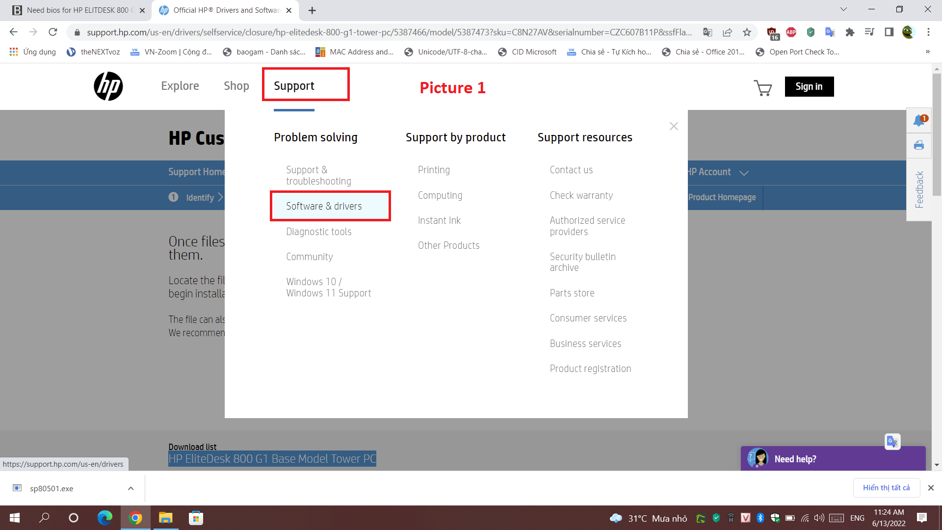

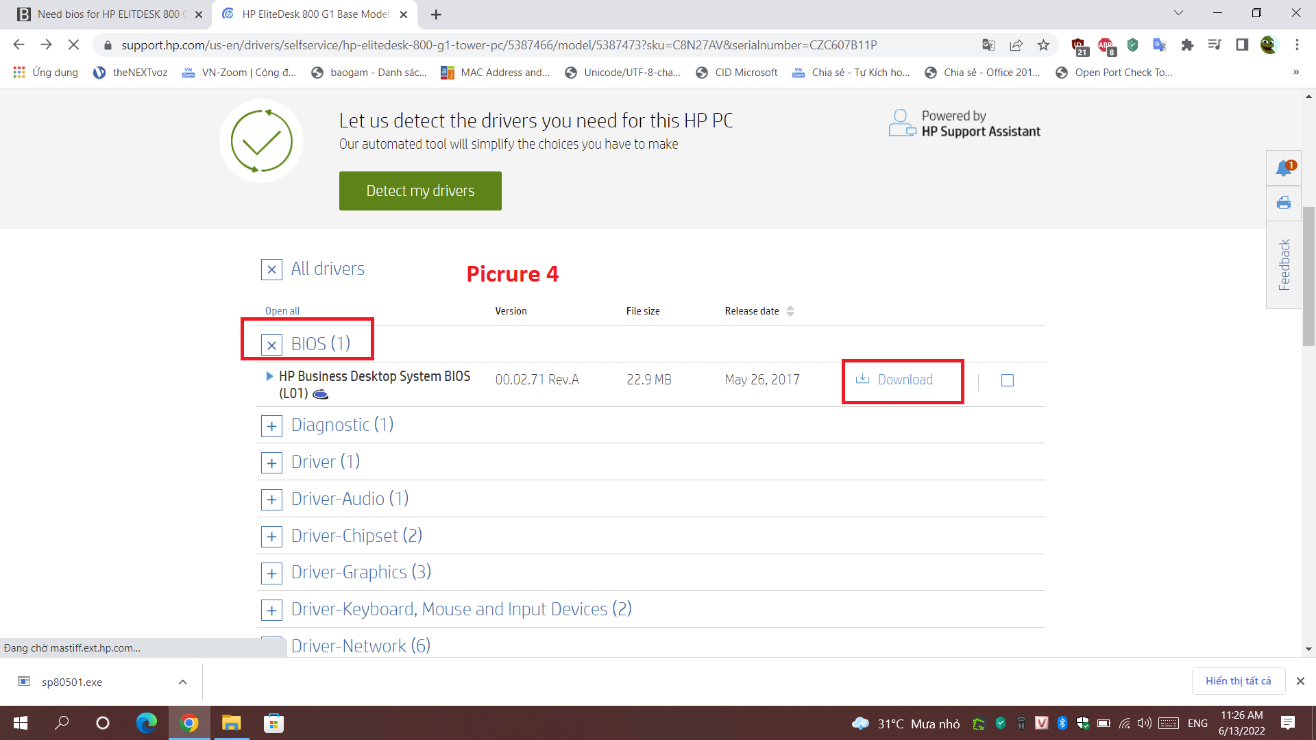

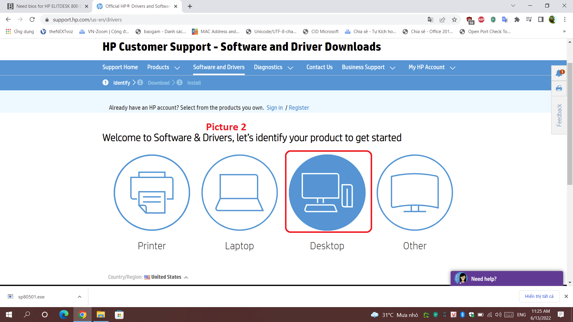

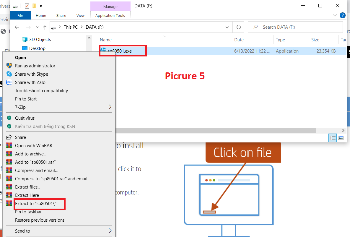

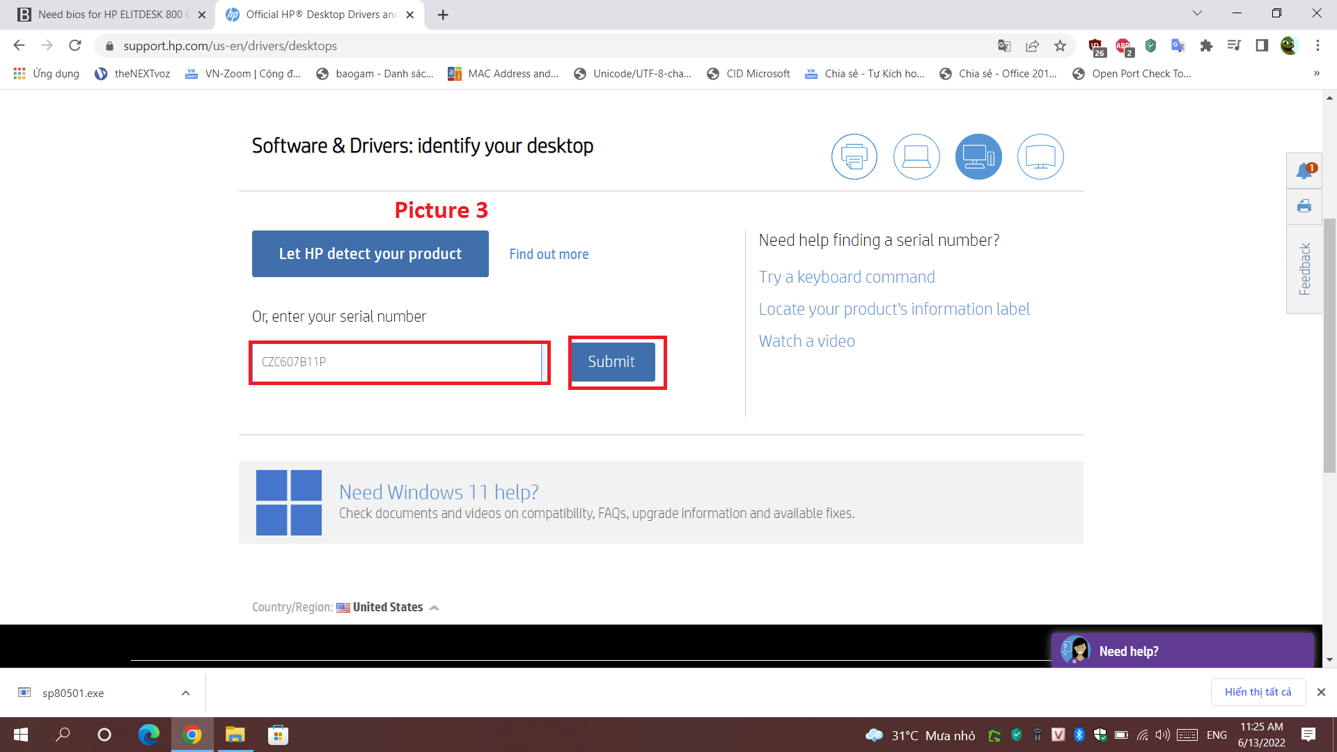

    Re: Need bios for HP ELITDESK 800 G1 TWR
    HP EliteDesk 800 G1 Base Model Tower PC

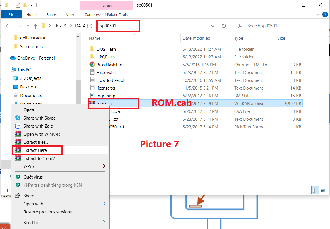

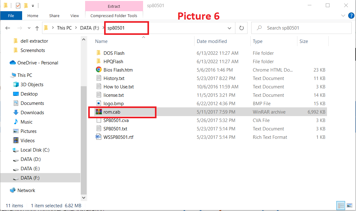

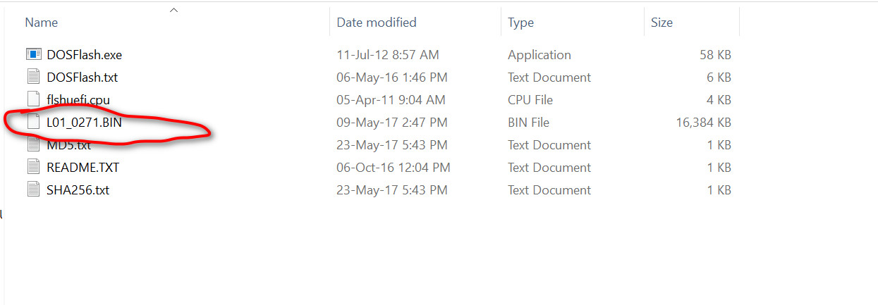

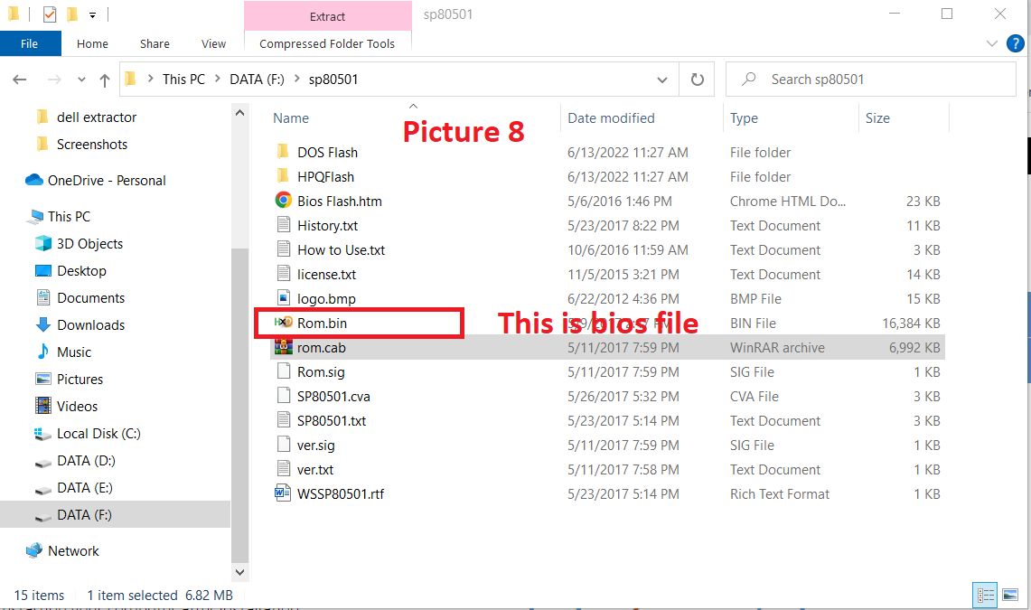

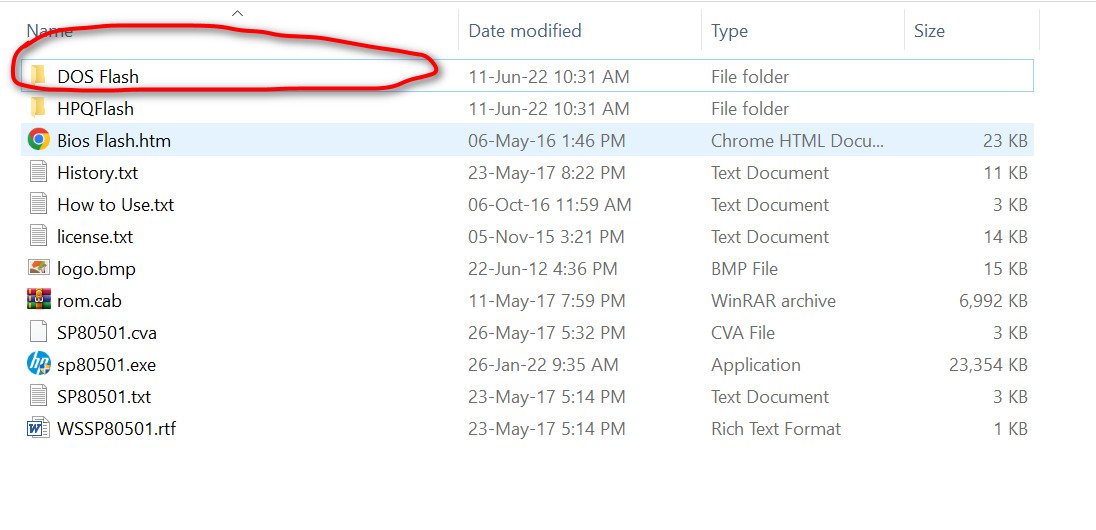

          Thanks sir, here is one question more
          may i use bin file from dos flash folder ??
          Both are the same files extracted from (dos flash) foler and extracted from main folder (sp80501) rom cab ????
            Yes, they are same.

              Bundle of thanks
              i should clean it after extracting
              Or should use it directly without cleaning???
                Bundle of thanks
                Your problem is not with bios because the file I posted is a clean file, it's the same as the one in the directory you specified, they are one.
