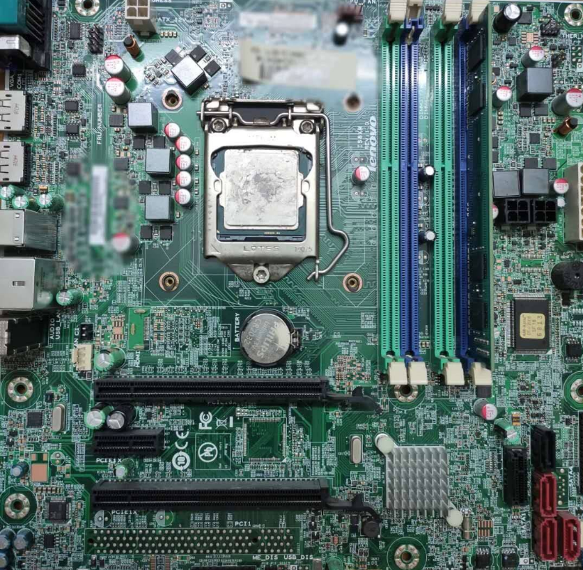

    Hi, need working clean bios
    Lenovo Motherboard IS8XM REV 1.0

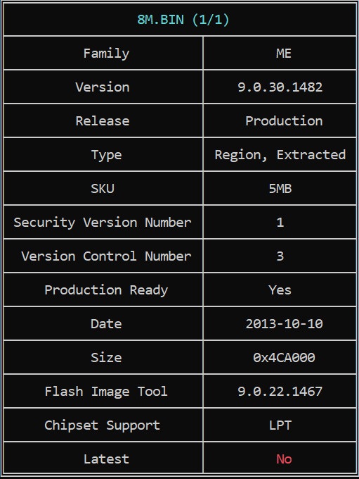

                        The bios is split across the 8MB and 4MB chips, before you can clean the ME firmware using FIT you have to join both of the files together.The 8MB file has the ME region,so join the 4MB onto the end of the 8MB. Use a hex editor to join the files or some other method or software. After cleaning the ME firmware FIT will split the files back to 8MB and 4MB
                          How i can check which bios is split or not???

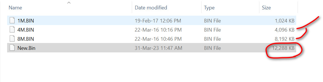

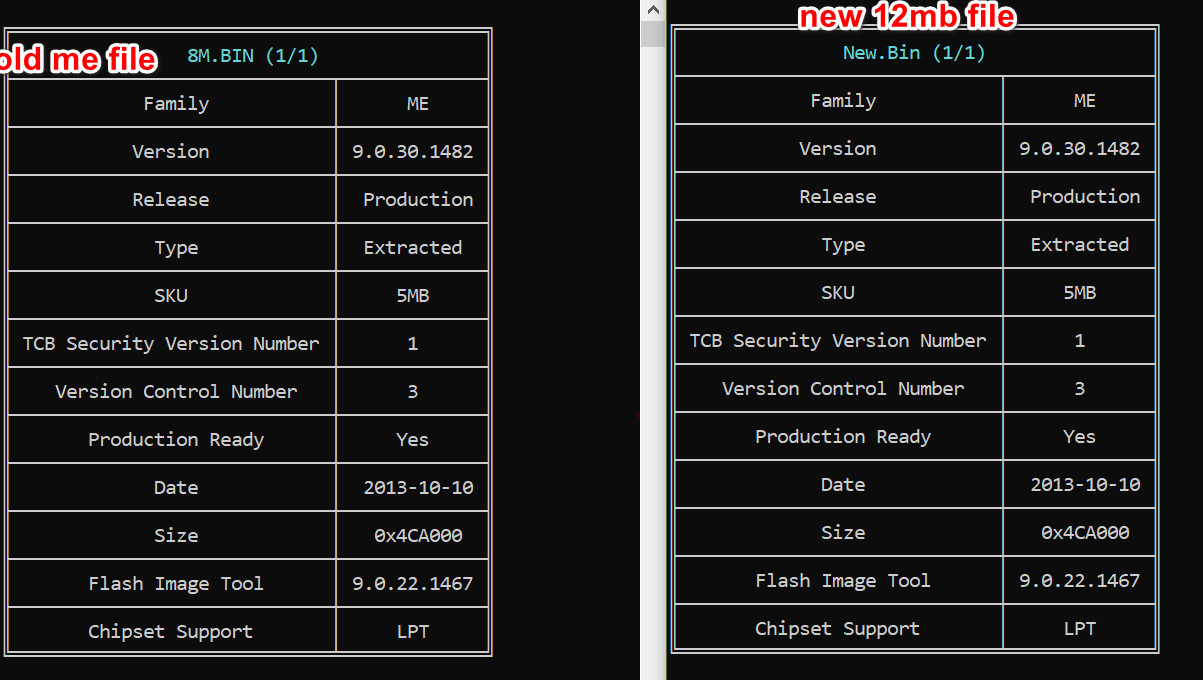

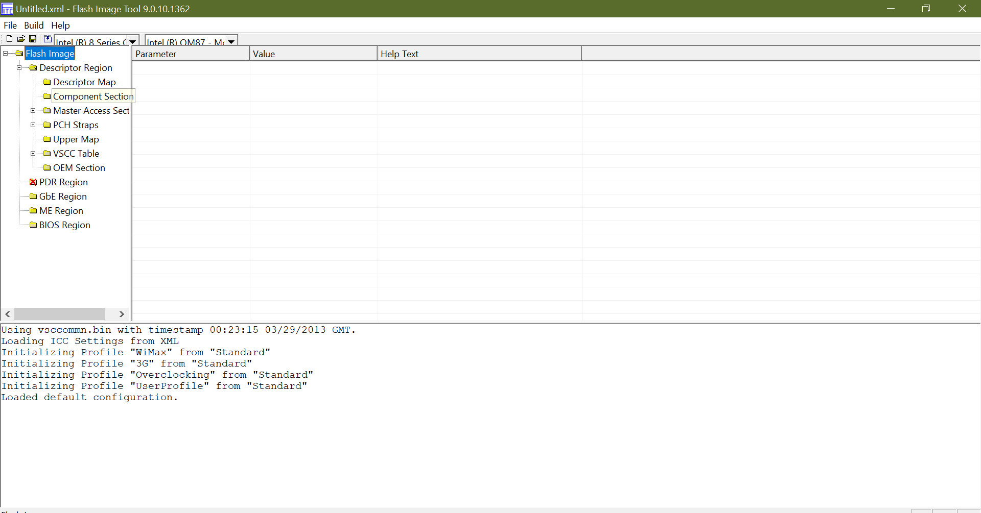

                            Re: Need bios Lenovo IS8XM REV 1.0
                            I combined both files 8mb+4mb through hex editor and save it new 12mb.bin file (8mb have me region, so its first and 4mb 2nd)
                            when i opens that new file in Flash tool 9.0, it hangs and afterthat close
                            even i open the old 8mb me region file, it hangs and afterthat close
                            whats the mistake i am doing????

                                  Thanks Badcaps . After getting polite help from this forum. i succeded to get 100% working clean bios bin files from corrupted one
                                  Here i attached. May be somebody need it
