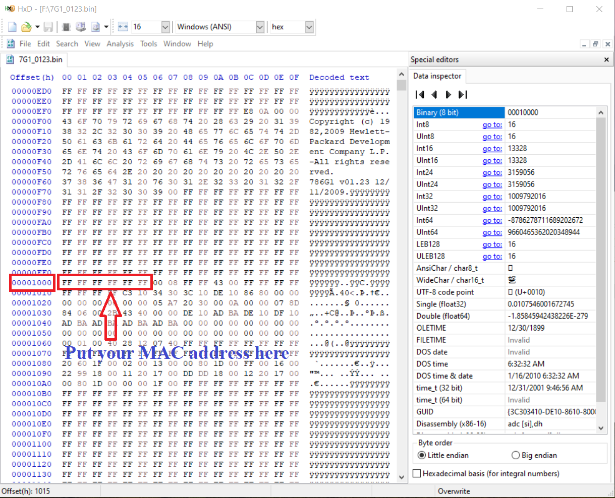

            Works for me too, but my MAC address is FFFFFFFFFF...and my NIC not working. What can I do? How can I edit the address?

              Re: Hp dc7900 bios dump
              See picture.
                Originally posted by hoaca388
                See picture.
                Thank you! Is this address in file valid only for 1.23 version, because I updated BIOS to latest version...1.27 I think...
                  This address is fixed for all versions.
                    Thank you!!! I'll try next week.

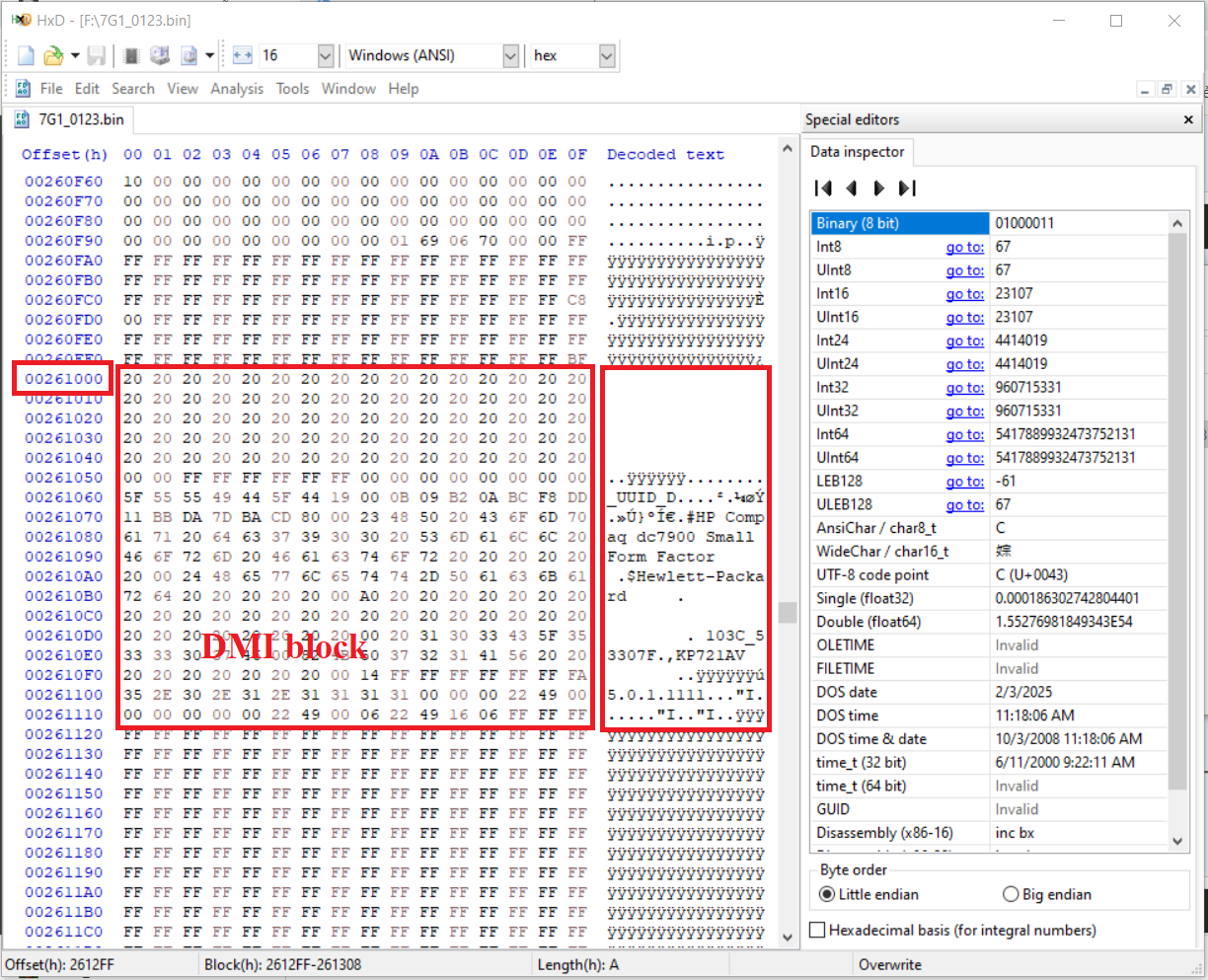

                      It work perfectly! Can you tell me, is there a map or something for that BIN, so I can write all system info from old BIOS to the empty one? Just to see where is that info in old image.
                        See the picture
                          See the picture
                          Thank you! Is that all? DMI block and MAC block?
