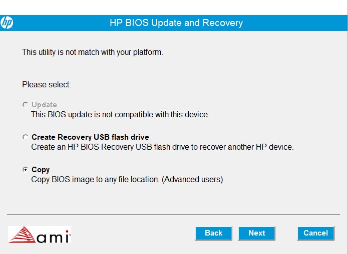

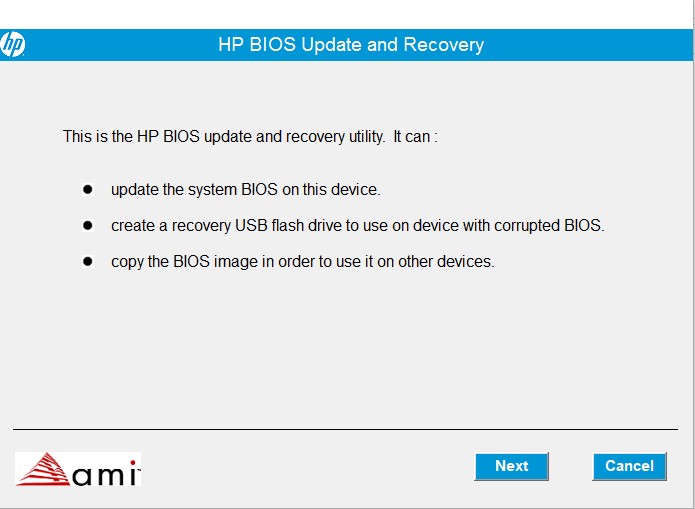

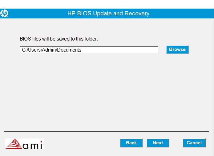

                  Ok, extract the attached file and run the exe,choose the option to make a recovery USB drive or choose the copy option to save a virgin bios. If you flash the virgin bios you might have to add the DMI using HP Bios config utility,or wndmifit.

                    I tried yesterday , but cant run the app
                      It will not run on win 7 ,use win 8 or 10 it will run.

                        it will not run on win 7 ,use win 8 or 10 it will run.
                        tried in 2 laptop w10

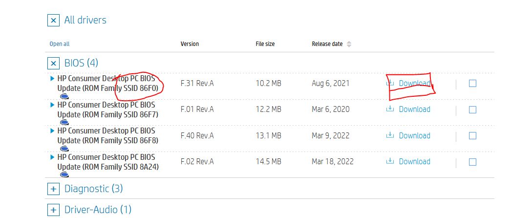

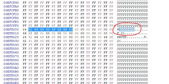

                          hi SMDFlea please i want repai this bios sn 8cc0382fxq
                          BID 086F8 F11
                            BID 086F8 F11
                            HP 200 G4 22 All-in-One PC
                                thank you my brother but it displays once with message 'error after no display with 3 long beeps and 4 beeps shorts
                                Check other error, that's a virgin bios, it's ok.

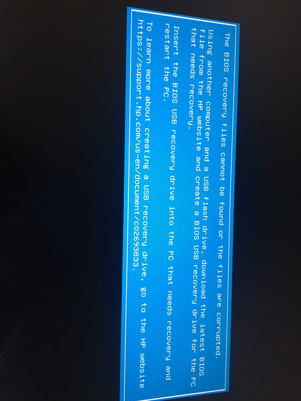

                                  here is the message (the system bios image is being cleared.do not shutdown or remove power from your computer during the clear. the cleare will take a few minutes to complete.
                                  for more information; clearing pending image

                                    Re: Need bios HP 200 G4 22 AIO
                                    after this message no affichage whith 3 long beeps and 4 short beeps
                                      The file I posted is the virgin bios from HP, it should work, you should look for other causes of failure, I also attach other bios versions of this model you can try.
