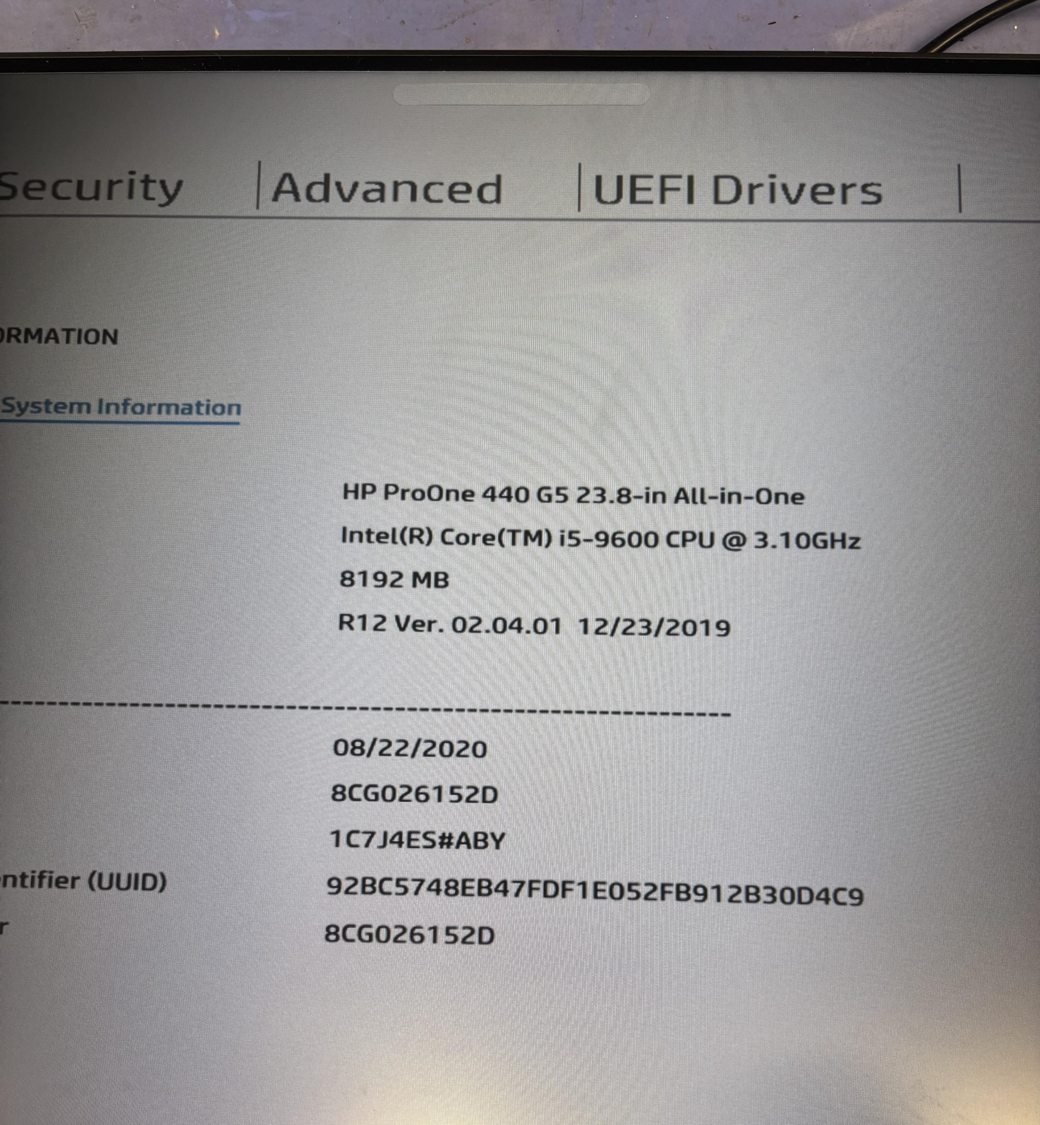

        Check the photo...

          Does the motherboard have the same code?

            I didn't check the MB code of the working ones...
