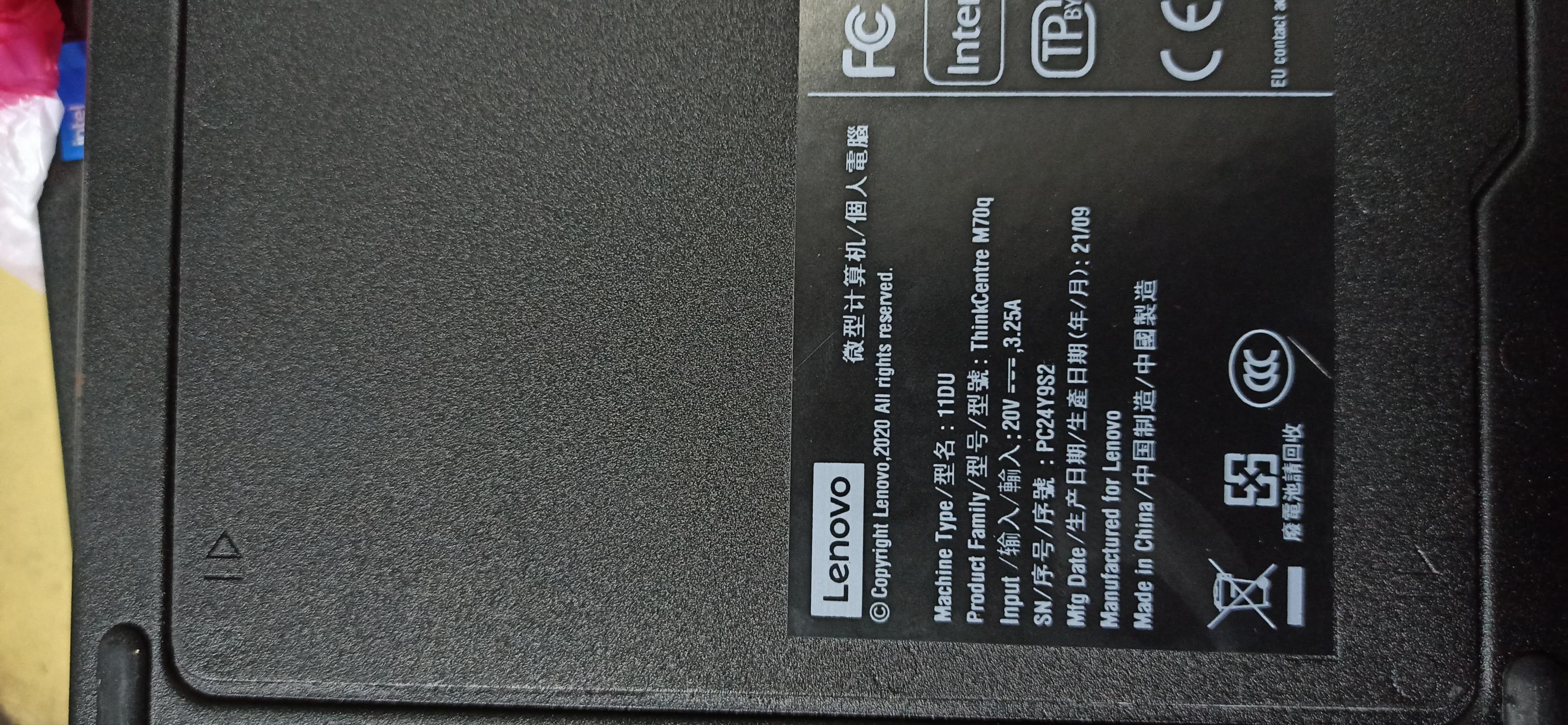

                                Hey badcaps, I just wanted to stop in to to confirm, anyone searching for a way to get past the amazon chrome os for the m710q 10YC the quoted peste bin works! flashed with the ch341a from amazon.
                                the one I bought did not have the 3.3v fix.
                                This video helped alot for using the ch341a
                                youtube.com/watch?v=lmYXiE2fQ6E&t=147s
                                My steps. (I was using flashrom v1.2 on ubuntu 20.04 for this)
                                1. In lenovo m710q, unplug power remove cmos battery.
                                2. Using the ch341a I read bios 3 times then verify checksum each time.
                                3. Flash new clean bios (thank you peste)
                                System started up no problem after this.
                                Watch the youtube, he shows you exactly what to do (using linux)
                                Went on to flash new firmware from lenovo support page using rufus.
                                this link will help with that.
                                https://jackstromberg.com/2020/02/tu...-devices-bios/
                                steps for rufus.
                                1. Download bios firmware .zip
                                2. extract to folder.
                                3. Create FreeDos image with rufus.
                                4. Once rufus completes, copy ALL files from extracted zip to freedos usb.
                                5. It will ask if you want to overwrite autoexec. Select YES!
                                6. with your now working lenovo, F1 into bios change boot order to usb.
                                7. insert FreeDos/Rufus/Lenovo-Firmware usb into it then start up and finish the process.
                                There you have it guys. Huge thanks to the people in this thread. Without you all I would have never figured this out!
