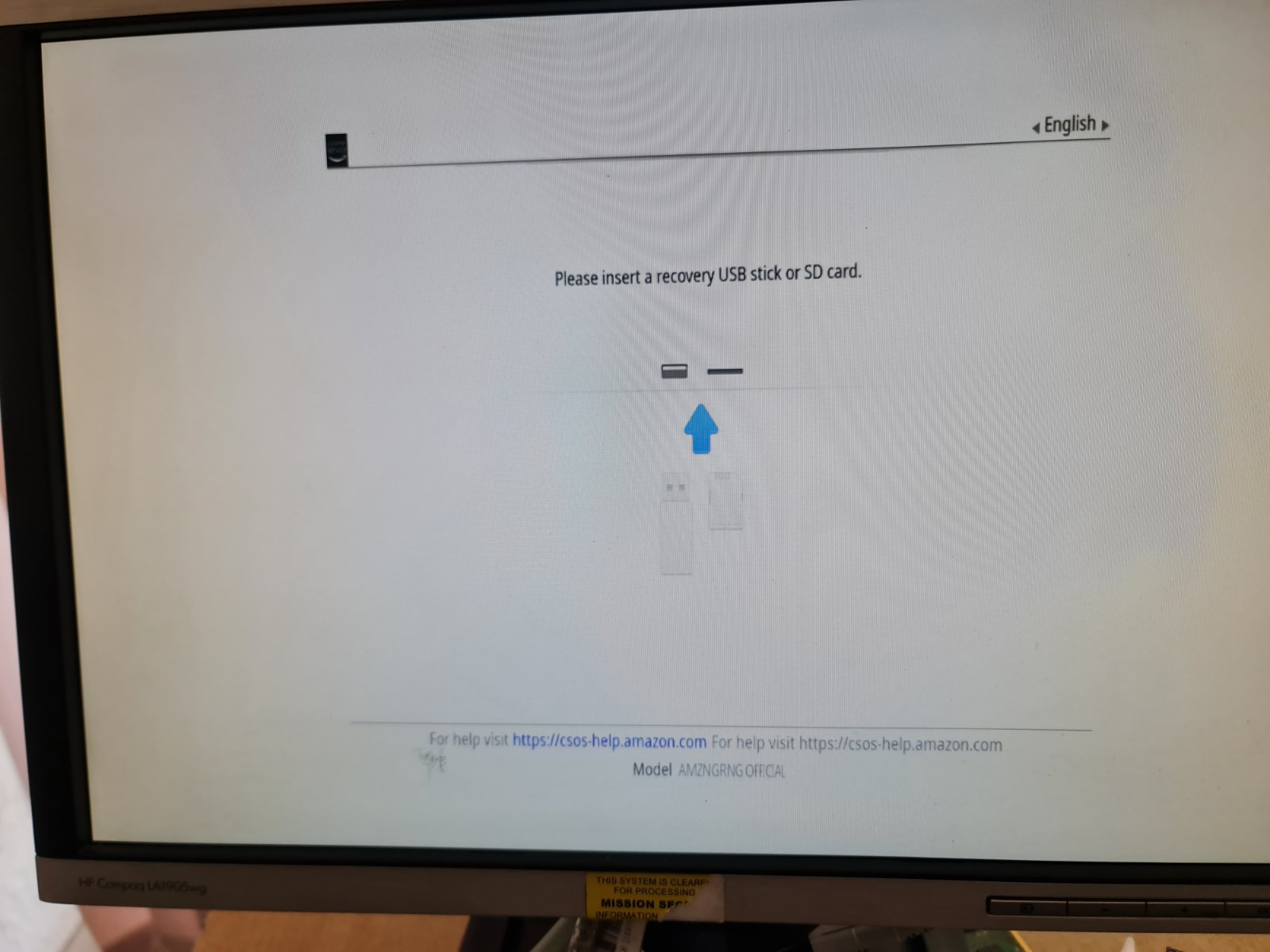

    Where could i get this clean image from please.
    I downloaded the official bios and programmed that with CH341A.
    Now pc powers on for a second then off. Hopefully just incorrect image.
    PC is Lenovo M710Q Type:10YC
    Thanks for any help

        Hey again.
        Just a quick update, flashed the file above and still unfortunately not booting.
        It basically powers on for 2 seconds, then off etc. This happens non stop. Left it like that for 5 minutes.
        I flashed the original Chromium image back, and it boots straight to the Amazon log in screen without problems.
        Any other ideas please?

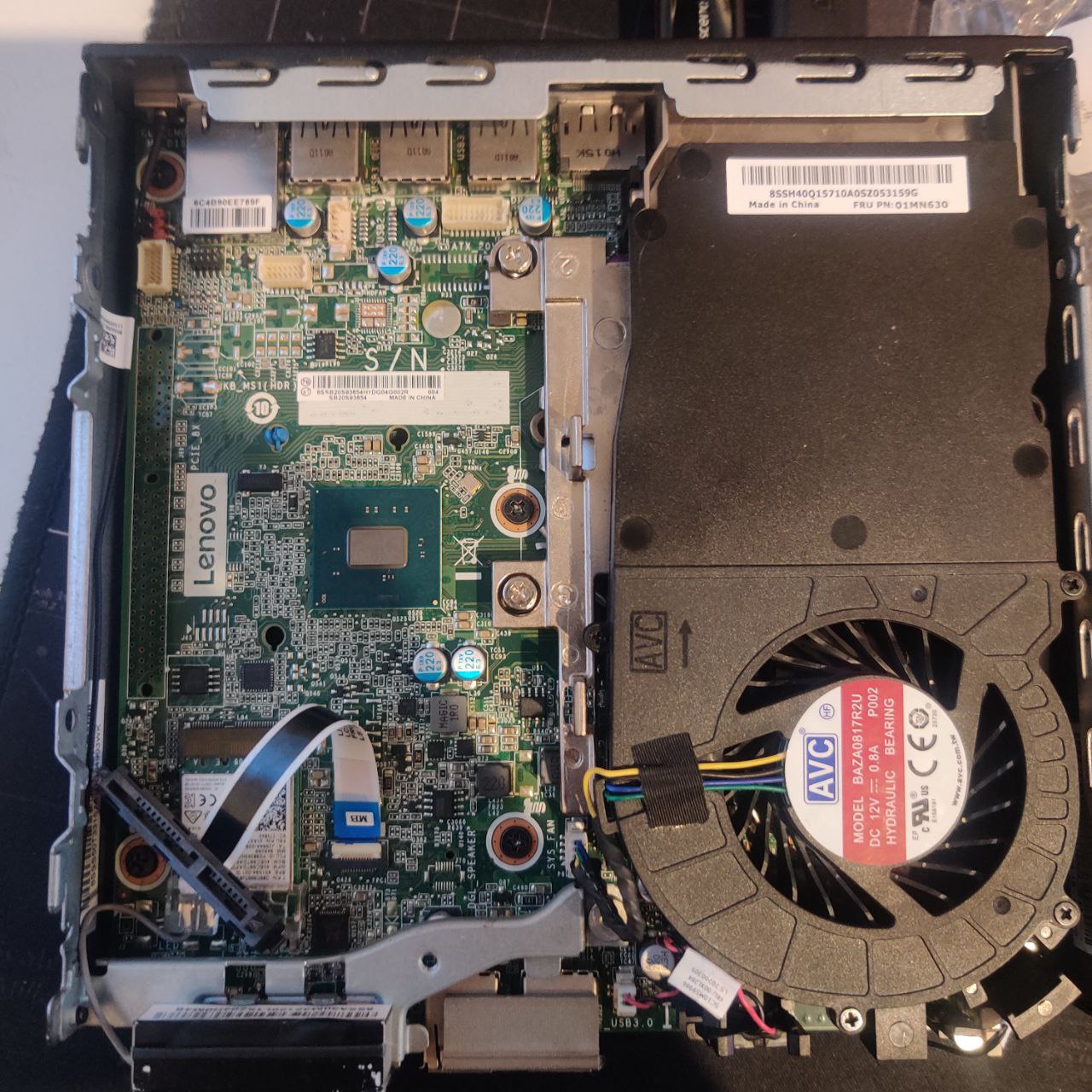

                  I believe I have the same issue as Psychomaniac, I have a M710Q 10YC, but the motherboard is the IX2QIH v1.1 (and not the v1.0 that others have), so yes, I believe it has 2 BIOS chips, a Winbond and an MX25L12873F.
                  When I flash the MX25 with the modded file from step 2 in this thread, I just get a black screen when powered on. Flash back to original BIOS and Amazon Chromium comes back on.
                  Sounds like there is a 2nd chip to flash with this model? Should I post the Winbond file? Let me know what I can do and I'll post it.

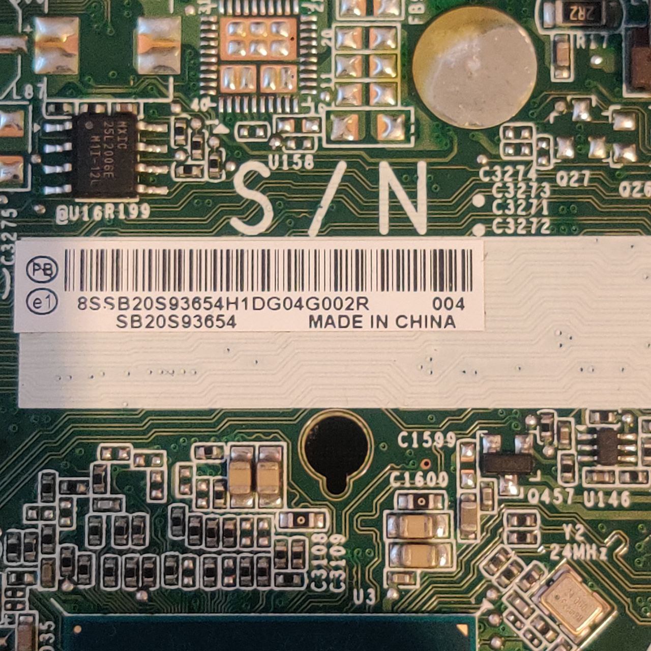

                      Mine's presenting the same symptoms as @rgorbie. However, I did not flash the backup back onto it. I don't see any other chip on the board.
                      Code:
                      sudo flashrom --programmer ch341a_spi -r backup_test1.bin
                      flashrom v1.2 on Linux 5.15.0-86-generic (x86_64)
                      flashrom is free software, get the source code at https://flashrom.org
                      Using clock_gettime for delay loops (clk_id: 1, resolution: 1ns).
                      Found Macronix flash chip "MX25L12805D" (16384 kB, SPI) on ch341a_spi.
                      Found Macronix flash chip "MX25L12835F/MX25L12845E/MX25L12865E" (16384 kB, SPI) on ch341a_spi.
                      Multiple flash chip definitions match the detected chip(s): "MX25L12805D", "MX25L12835F/MX25L12845E/MX25L12865E"
                      Please specify which chip definition to use with the -c <chipname> option.
                      I couldn't specify the chip as per the label on it:

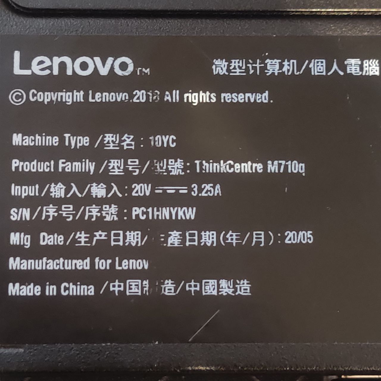

                        Serial number ?
                        https://www.badcaps.net/forum/showthread.php?t=103569
                        • FriendoZA
                          • Aug 2014
                          • 5
                          • South Africa
                          #32
                          Re: M710q Please my bios clean me
                          Originally posted by SMDFlea
                          Serial number ?
                          Outer casing: PC1HNYKW
                          Board label: 8SSB20S93654H1DG04G002R / SB20S93654
                          (I've included pictures)
                          • m710q_flash
                            • Oct 2023
                            • 6
                            #33
                            Re: Please my bios clean me
                            Originally posted by peste
                            try..
                            Thank you for this. I have an m710q 10yc s00p00 motherboard v1.1 and read my bios chip(locked to Amzn)with a raspberry pi and a chip clip(generic pamona clip)@ 16,777,216 bytes. I tried to flash the bin from the Lenovo firmware package on their site and only got an error with flashrom.
                            Error: Image size (8388608 B) doesn't match the expected size (16777216 B)!
                            So I used the one in post #2, it kept failing to verify the image to the W25Q128.V chip but it did allow me to boot from a USB memory stick that I had set up to install Tiny10, used Tiny10 to run the Win10 firmware flashing utility from Lenovo site to make sure that the firmware was correctly and completely installed then reset to factory defaults. Now the system is working properly with Ubuntu 23.04 installed. Once 23.10 ISO is finished I will actually install that.
                            Thank you so much for posting!

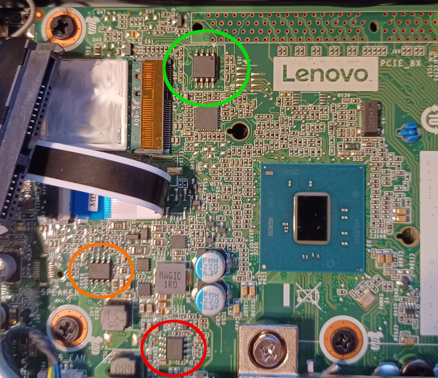

                                  It seems that all the knock-off clips/clamps are generally junk, if I were doing this more than once I would get a Pomona clip. I got lucky with my el cheapo version, I actually bought a ch341a_spi kit that I ended up only using the clip from.
                                  After reading this I had decided not to use it: https://libreboot.org/docs/install/s...not-use-ch341a
                                  So many have had success with it though, so who knows, but I didn't want to risk it.
                                  I ended up using a Raspberry Pi 3B to do the programming with the latest version of RaspiOS (bookworm) and used the flashrom that was in the repo.
                                  While we have the same machine 10YC and version 1.1motherboard, I also have a different model number on my label.
                                  I attached a picture of the motherboard with the chip I flashed circled in green.
