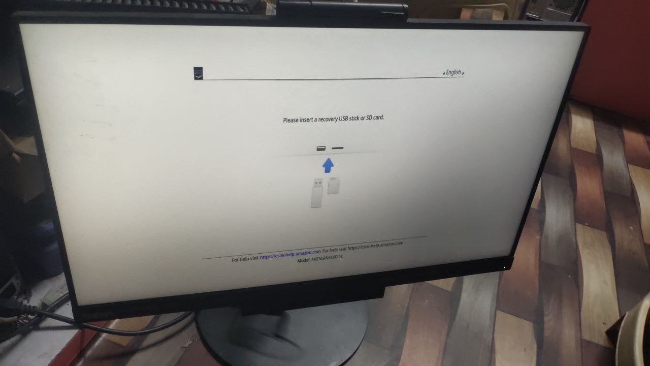

      Lenovo m710q
      Type 10YC
      S/N PC0Y8EAY
      Problem - Attached in Pic. Not booting further, need to change to windows
      Any Help.

          I found a Lenovo ThinkCentre 710q (7th gen i3, 8gb ddr4, 256 gb) and monitor ( TIO24 gen 3) at a thrift store for $15 dollars.
          A friend needed a gaming setup with a newer CPU (he has a gen 4 i5-4460). Games like DayZ and CS2 crashed often. His rig had bad airflow since it was near the floor and full of dust. I wanted to fix both issues: give him better performance in a small system that could sit off the floor.
          My plan was to upgrade the guts, attach it to the monitor, and save space. But it didn't go that smoothly.
          When I powered it on, it was running Chrome OS—Amazon's locked-down version. This made it useless outside of Amazon's work environment.
          Worse, the BIOS had no UEFI options to boot from another drive!

          1. Flashing the BIOS: Installing and running Flashrom to remove ChromeOS bios
          Steam deck nuance with removing read/write
          passwd deck
          sudo steamos-readonly disable \\protection before and after installation
          \\ We will do this again at the end to leave it how we found it
          Downloading Flashrom from Arch repository on Linux with Steam OS. https://www.reddit.com/r/SteamDeck/c...ur_steam_deck/
          sudo pacman-key --init
          sudo pacman -Syy
          sudo pacman -Syu
          sudo pacman-key --populate holo
          sudo pacman-key --populate archlinux
          sudo pacman -S vi \\Installing a package to test out repository set up
          sudo pacman -S flashrom
          Prepare the CH341A Chip programmer
          Unplug the PC and remove the CMOS battery before any changes.
          BIOS chip is under the SSD; it says "Winbond" and starts with "25" or "24".
          Pin 1 is near the circle on the chip. Match red wire of the SOIC clip to pin 1.

          sudo flashrom --programmer ch341a_spi -r new1.bin (see video above for command source)
          sudo flashrom --programmer ch341a_spi -r new2.bin
          sudo flashrom --programmer ch341a_spi -r new3.bin
          new#.bin are new files that we create when reading the old/already present bios Son the chip.
          to ensure their validity we can compare hashes between each read of the present bios file
          sha512sum new1.bin \\( see video above)
          sha512sum new2.bin
          sha512sum new3.bin
          Results of above entries should yield the exact same strings of numbers and characters as each new#.bin is a copy of the same bios
          As this is a sanity/safety check, I have NO idea what I would of done if the values were different. If they had been dissimilar I probably would have re-seat the SOIC8 clip and tried again
          Once we verify all hashes are the same, we can identify the default directory of the new#.bin files. This way we can upload the stock Lenovo bios for the 710q without needing to specify a directory location in the final write command (bios link & video link)
          On the steam deck the default directory was he "Home" screen of the SteamOS flavor of Linux. (/home/deck)
          After unzipping the bios .rar file, I placed the stock bios in same location as .bin files (again, /home/deck)
          sudo flashrom --programmer ch341a_spi -w 11.6.10.3197+outimage.bin ("1.6.10.3197+outimage.bin" was default name of bios from badcaps forum link)
          wait 15-30 min.
          final result (see video) should verify write and say "VERIFIED"
          at this point we need to see if it worked. unplug programmer.
          Plug display cable, power, and keyboard to boot into bios (f1 spam)
          If you see the Lenovo splash screen, it worked. BIOS date in BIOS menu should be dated to ~ 2017
          Now update the BIOS to the newest version.
          sudo steamos-readonly enable
          sudo passwd -d deck
          2. Updating BIOS 2 electric boogaloo flash installation media
          - use this guide step by step to create the media for up to date bios Specifically want: BIOS Update (USB Drive Package) m1ajt5ausa.zip
          In BIOS:
          Disable PXE Boot (Devices -> PXE Option ROM -> Disable)
          Set boot to USB HDD
          PC was defaulting to boot from a network connection regardless of any changes to boot order.
          set to load from USB hdd after PXE boot disabled
          next time you boot you should see on screen instructions as the PC recognizes BIOS update media on flash drive
          I left my serial number and other meta data the same. I didn't want to find out if changing any of that would alter the boot (although I don't think it would)
          It will restart several times, then take you back to Lenovo splash screen
          press f1 to get back to bios, you should see updated BIOS version from 03/2025. Success!
