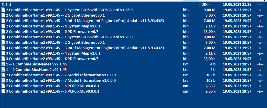

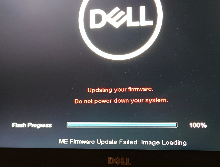

                  DELL OptiPlex 7450 All-In-One, need bios, clean ME
                  I've got a problem with my Dell AIO 7450. I'm stuck on a screen with error message: (A7) Me FW Downgrade Request MeSpiLock Failed. After a few seconds computer reboots again. I can only enter bios or boot menu. I can't even boot from USB, nothing.
                  I've tried all methods from Dell site, flashing bios through recovery (CTRL + ESC method) with many bioses versions but nothing helped.
                  I searched for ways to solve this problem and found a similar problem on the forum, which was solved by creating a bios with clean ME.
                  So I wanted to try to prepare such a bios by myself (with ME Firmware Cleaning Guide) but I can't get the bin from Dell exe bios. I've tried all the methods (python scripts, Dell_PFS_Extract, Dell_hdr, Dell_Image_Extract v2) and they only works on older dell bioses.
                  So, I am begging for help, please prepare a bios with me cleaned.
                  The original bios is in the attachment.
                  I can only flash bios with CTRL+ESC method with rcv file (I think it's an exe bios file but with different extension).

                    Re: DELL OptiPlex 7450 All-In-One, need bios, clean ME
                    PFS Extract 4.9 -> https://www.badcaps.net/forum/showpo...95&postcount=6

                      Re: OptiPlex 7450 All In One bios
                      Thx SMDFlea,
                      PFS Extract 4.9 did the job, but there are many bin files in the unpacked folder, and this structure looks like the files that result from drag&drop a single bin file into the FIT. How can I load all these files into FIT so that I can build a new BIOS/EXE file after replacing the ME?

                        You might be able to bypass the ME error message by using the MECLR1 jumper,if the motherboard has one https://www.dell.com/community/Inspi...50/m-p/8323222 .If you can do that and boot into windows you can run the bios update exe (not the rcv,it doesn`t flash the ME firmware) .If you can`t do that then your only option is to buy an SPI programmer to make a backup for repairing or take it to a repair shop.
                        • samian
                          • May 2023
                          • 4
                          • Poland
                          Ok, but when I'm flashing through recovery flash mode (CTRL+ESC), on the last stage I get error: ME Firmware Update Failed. All previous stages are ok. Beacuse of that, I was wondering if there is any way to rebuild this RCV file.
