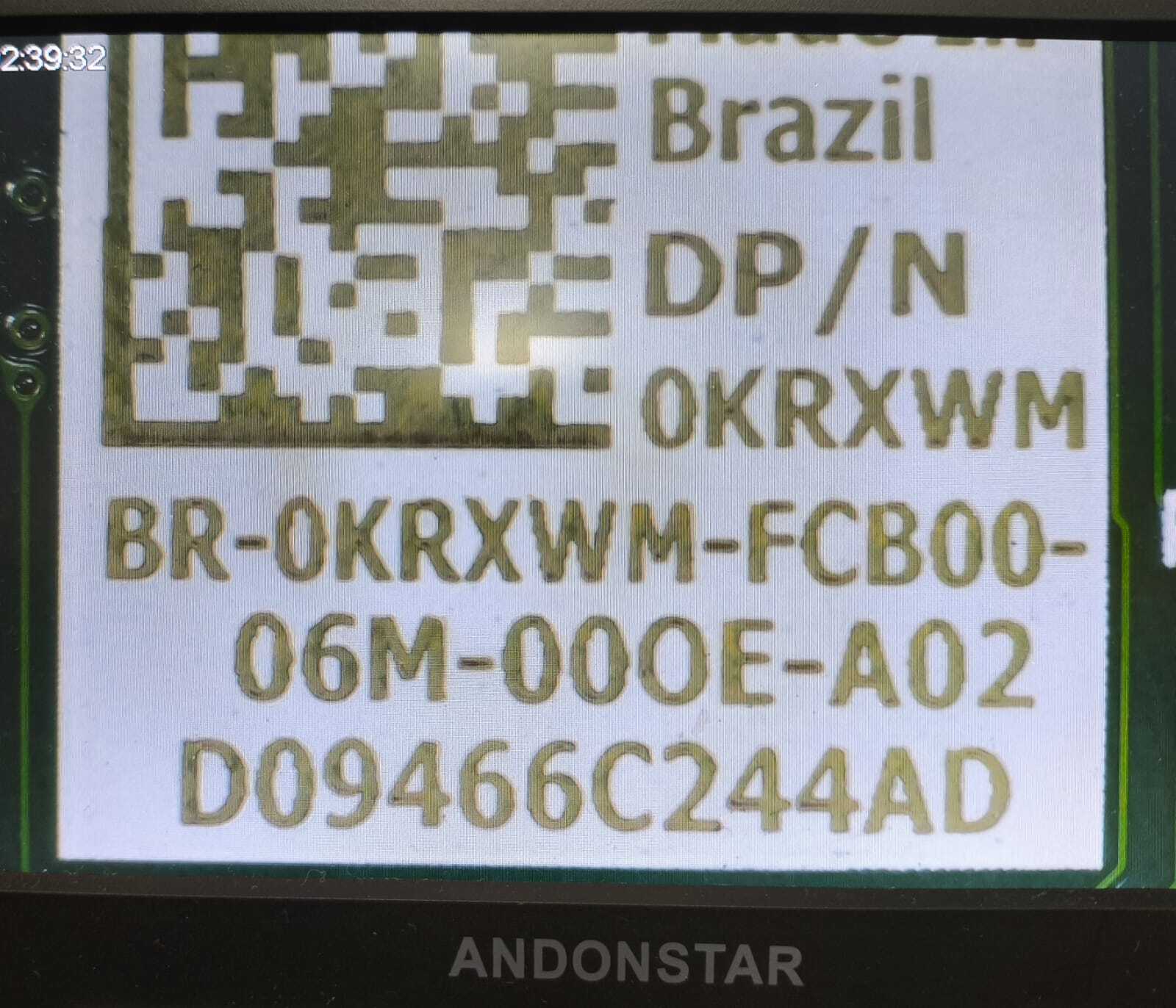

              I tried another power source after seeing that all its components are fine and I mean the mosfets INDUCTOR COILS AND CAPACITORS, fan does not spin does not generate video at some time the led that is embedded in the power button flashed 3 times then assemble again and nothing would happen again
              ServiceTAG: JX8CM63
              Model D10u003
              CPU: i3-9100t
              MoBo: IPCFL-CG Rev: A00
              if someone has an idea of how to locate a backup and where to get the DMI of it would be very grateful

              • 21992
              ServiceTAG: JX8CM63
              Model D10u003
              CPU: i3-9100t
              DMI . DVAR = Dell Variable 1081000 - 1090FFF
