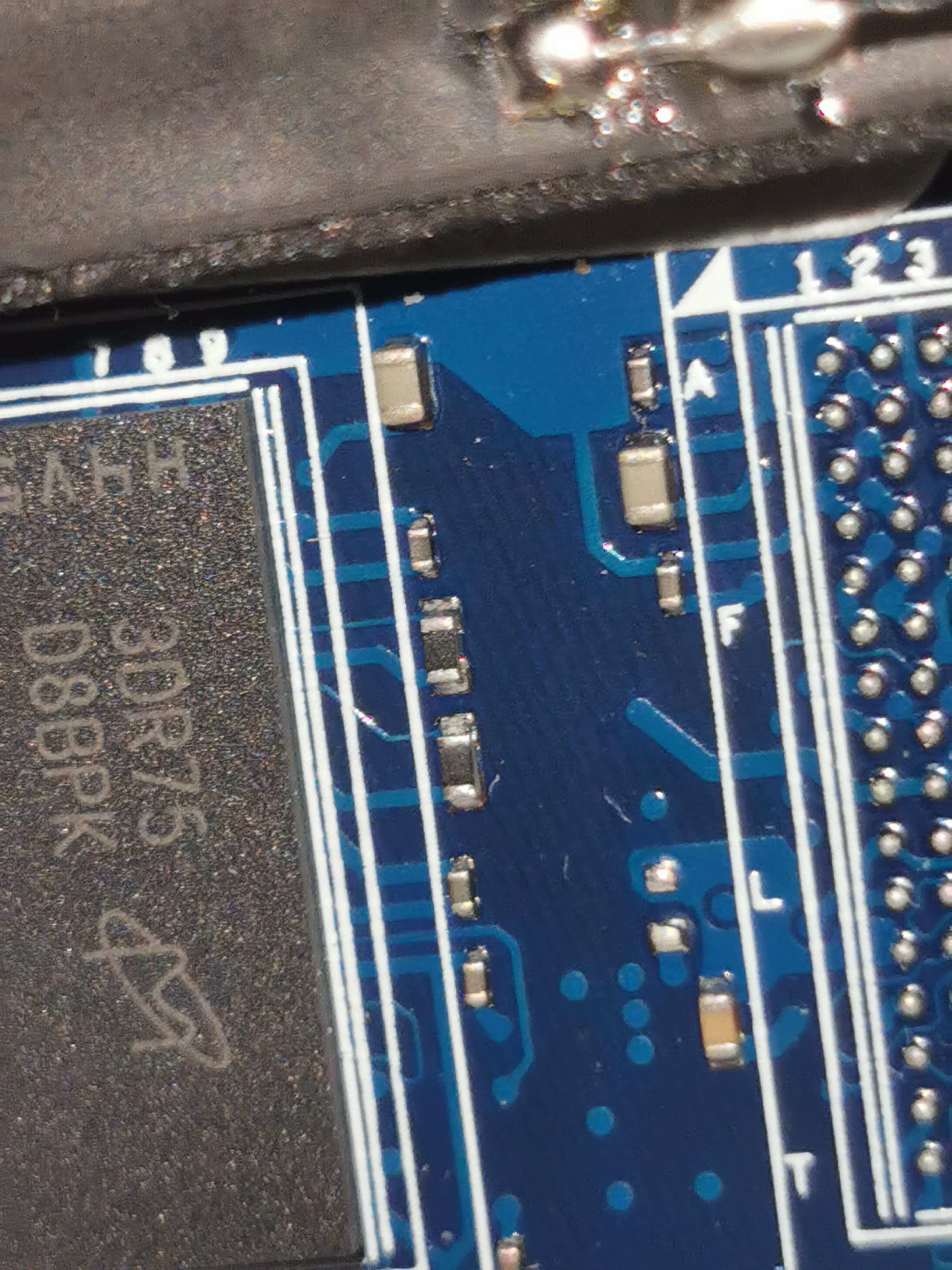

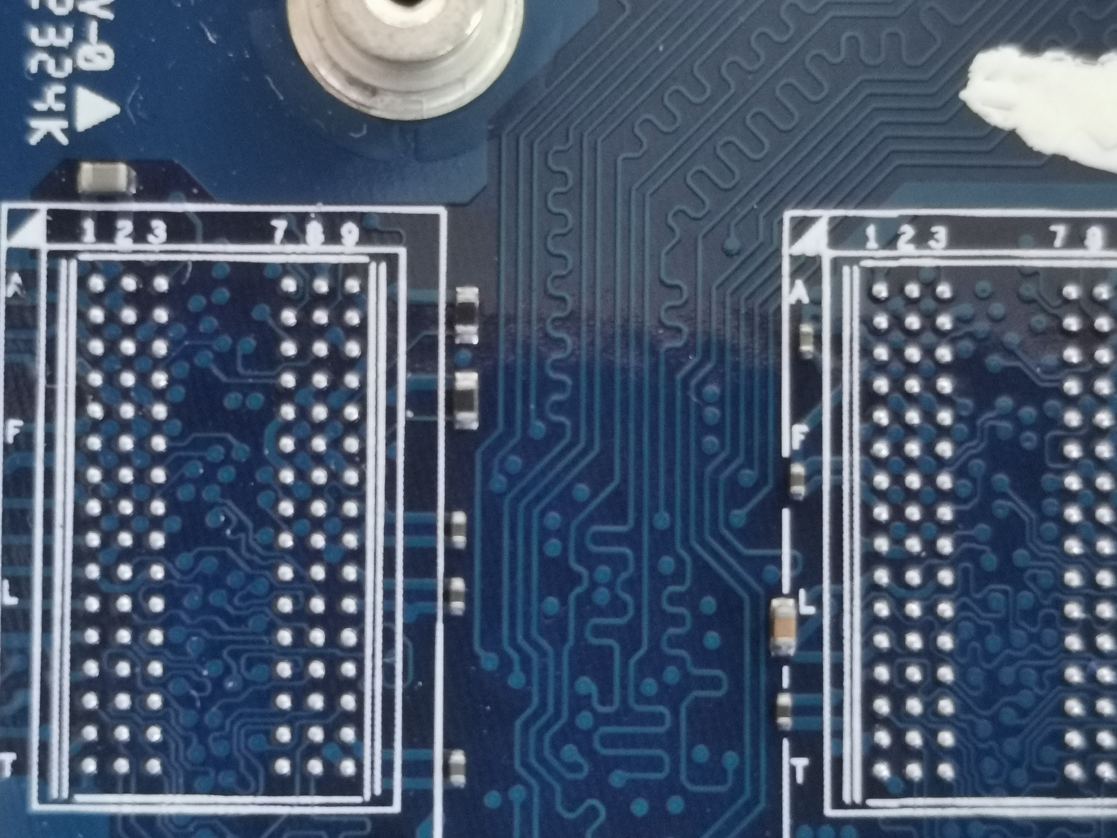

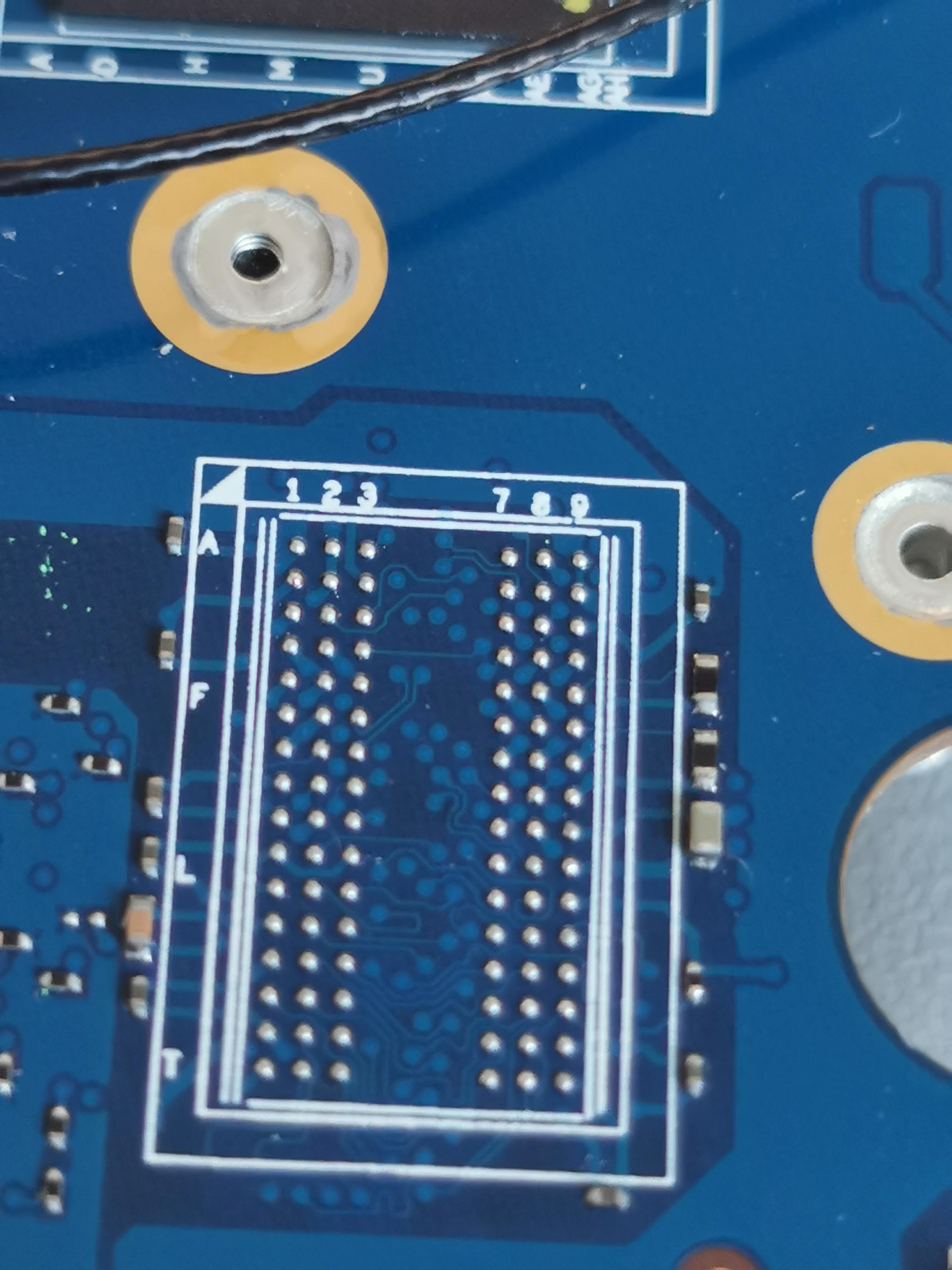

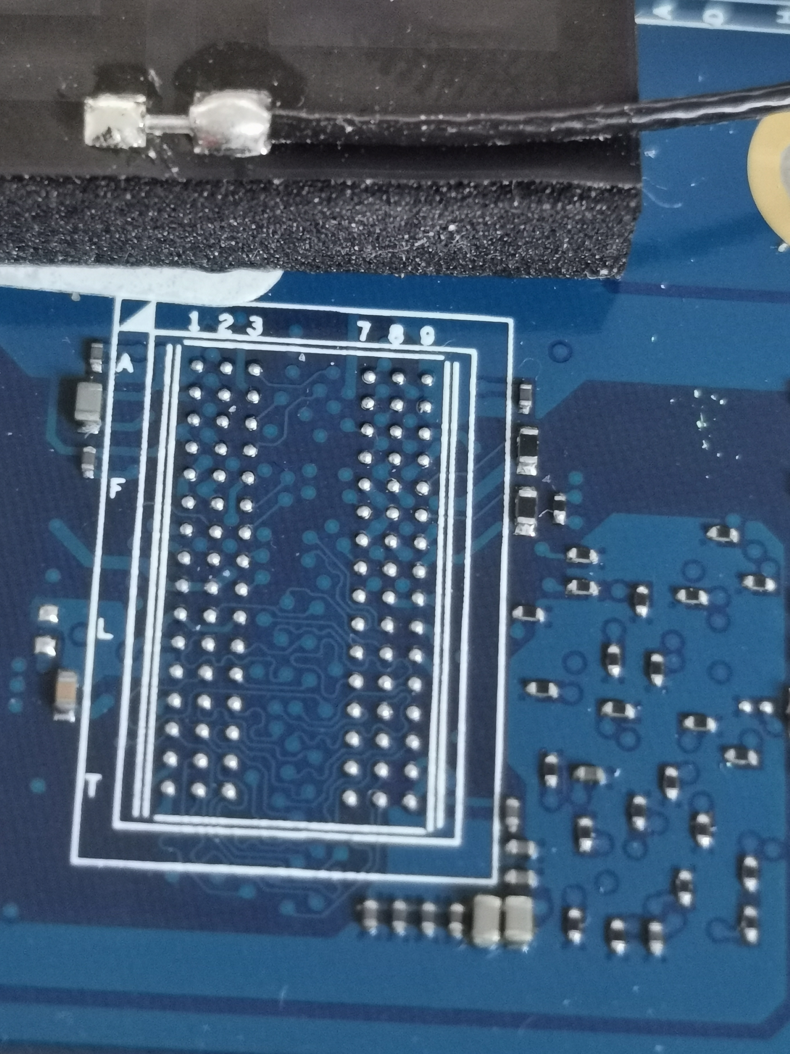

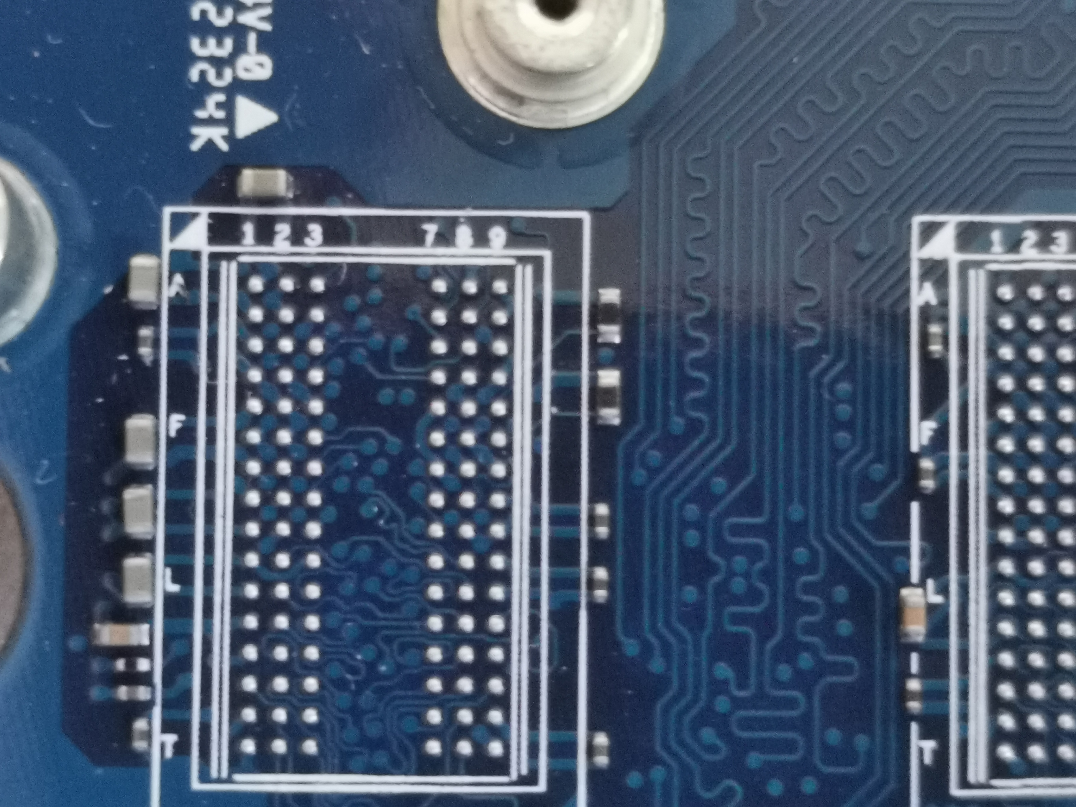

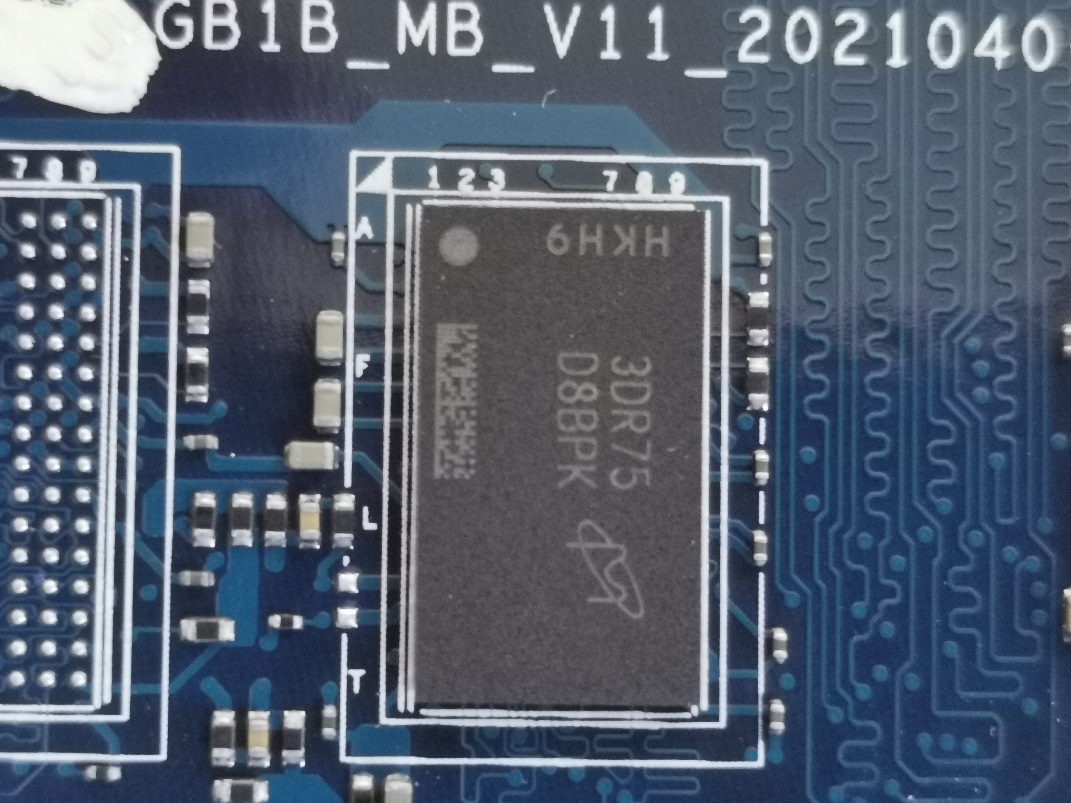

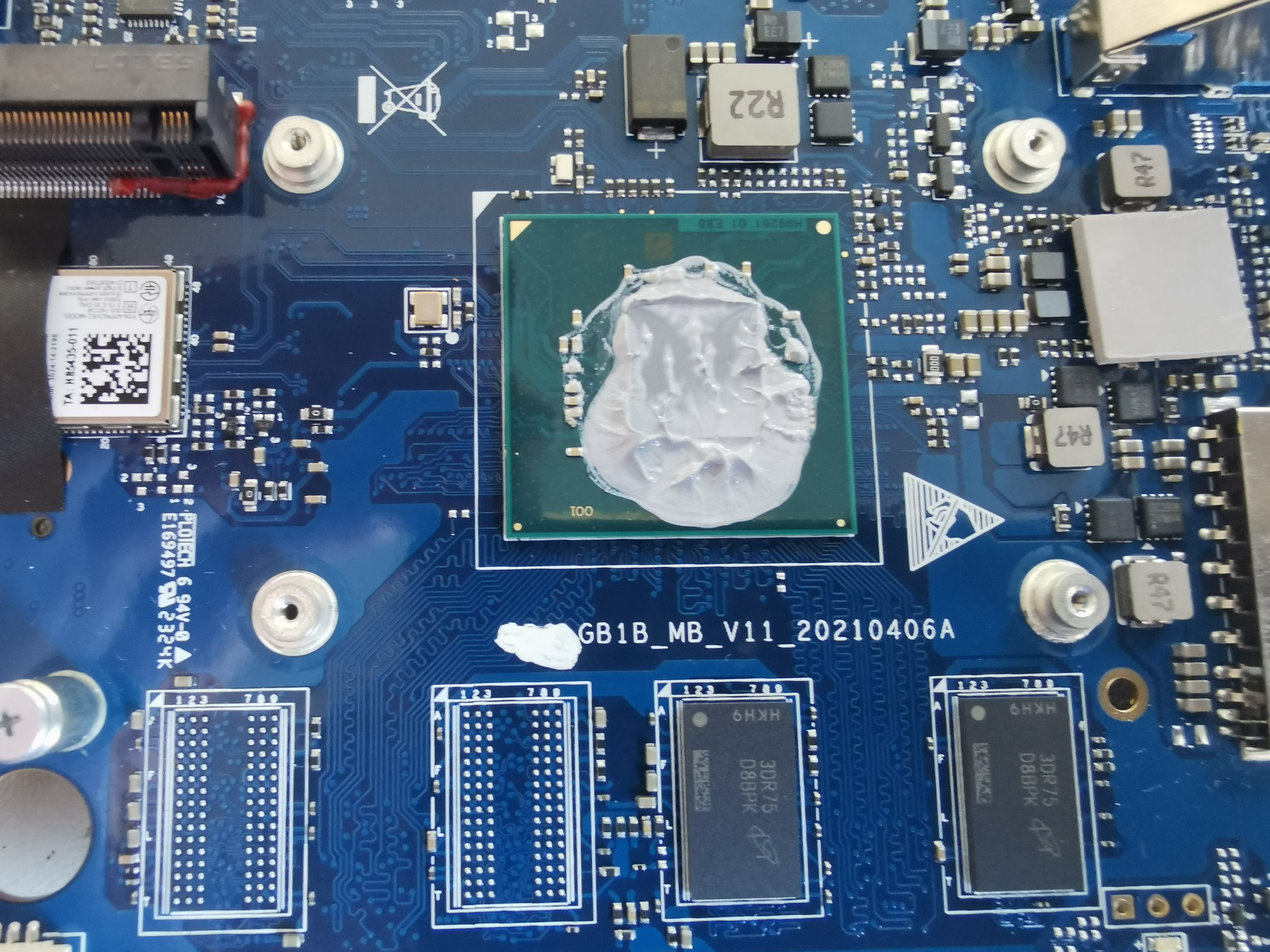

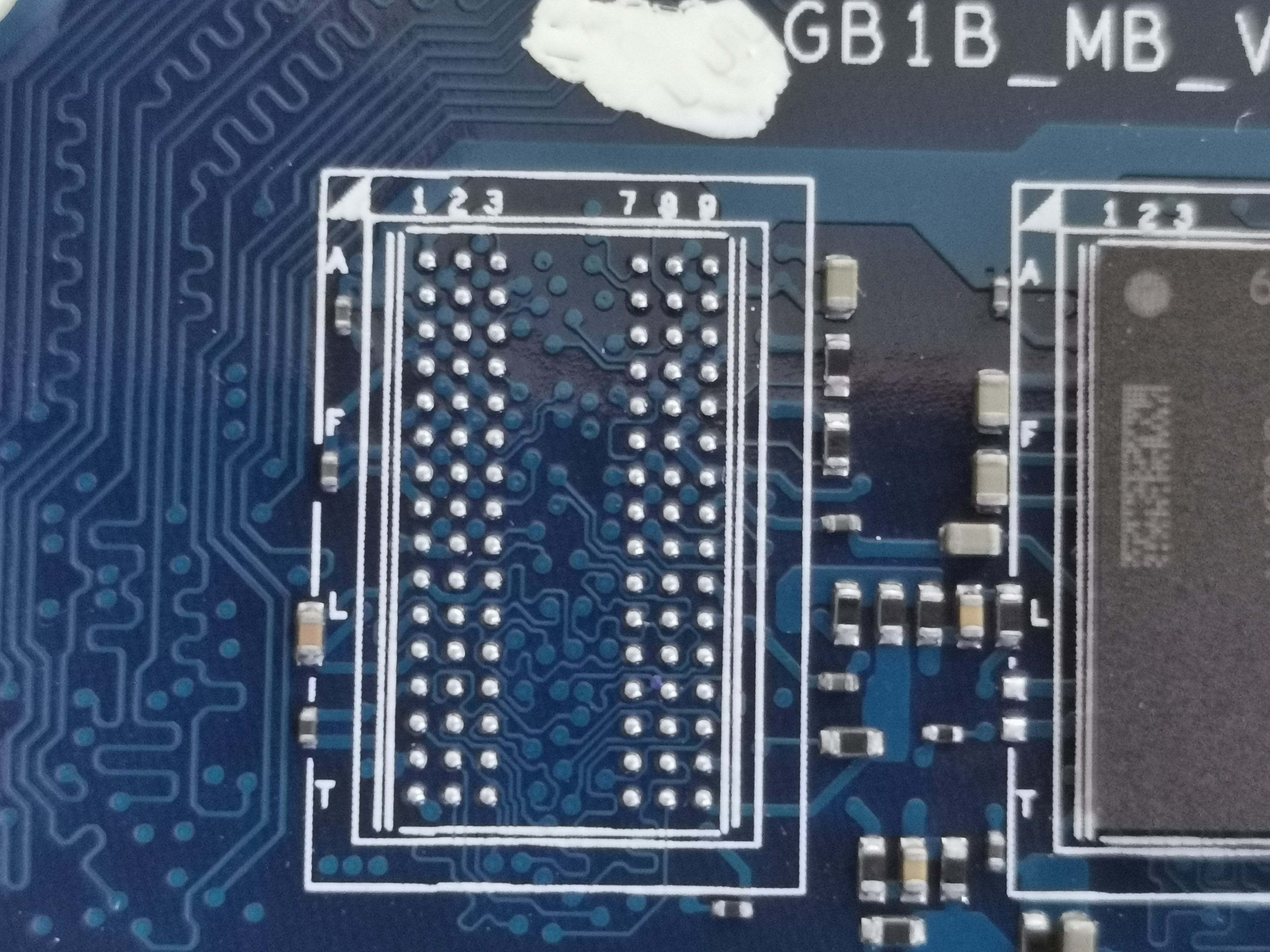

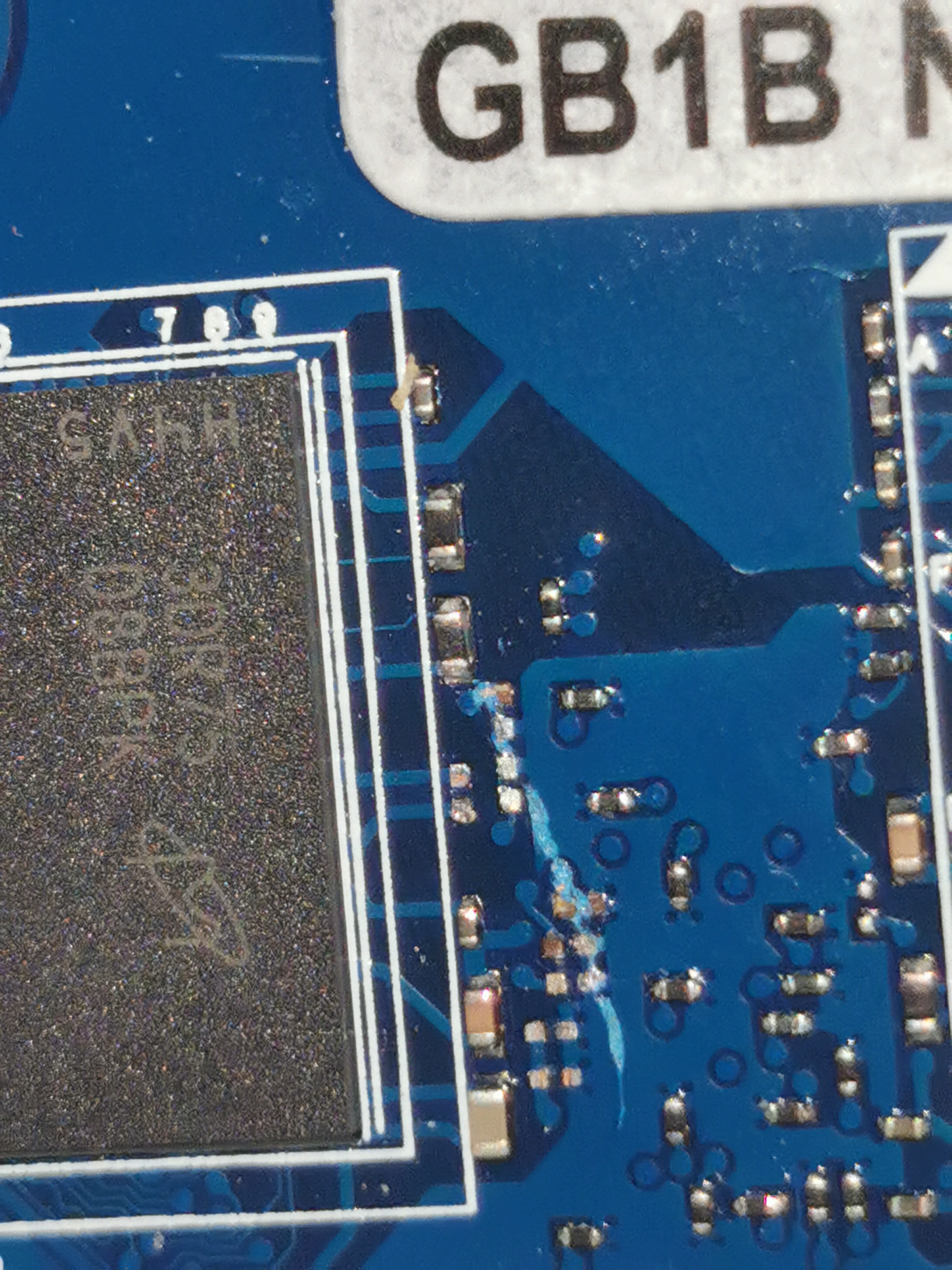

    Hi!
    I have bought a used Minisforum N40 which is not POSTing, all Voltages are present. One Coil has a fluctuating Voltage, no clue what it is for. Theres a scratch next to one Ram Module and Missing components. I have replaced some of them with 36 Ohm resistors. I left the missing Caps Out. Anyone got schematics, Boardview or BIOS dump?

    Please make a seperate thread for the bios. Is the resistor/cap placement the same at the side of the other ram chips

      No the placement on every chip is different. I found a silkscreen file online (also attached). most resistors around are measuring 36 ohms, it think these are terminators for the dataline.
      Cannot test the BIOS image / board, i think i fried the flash while reading the contents, accidentally chosen 3.3V🤦♂️

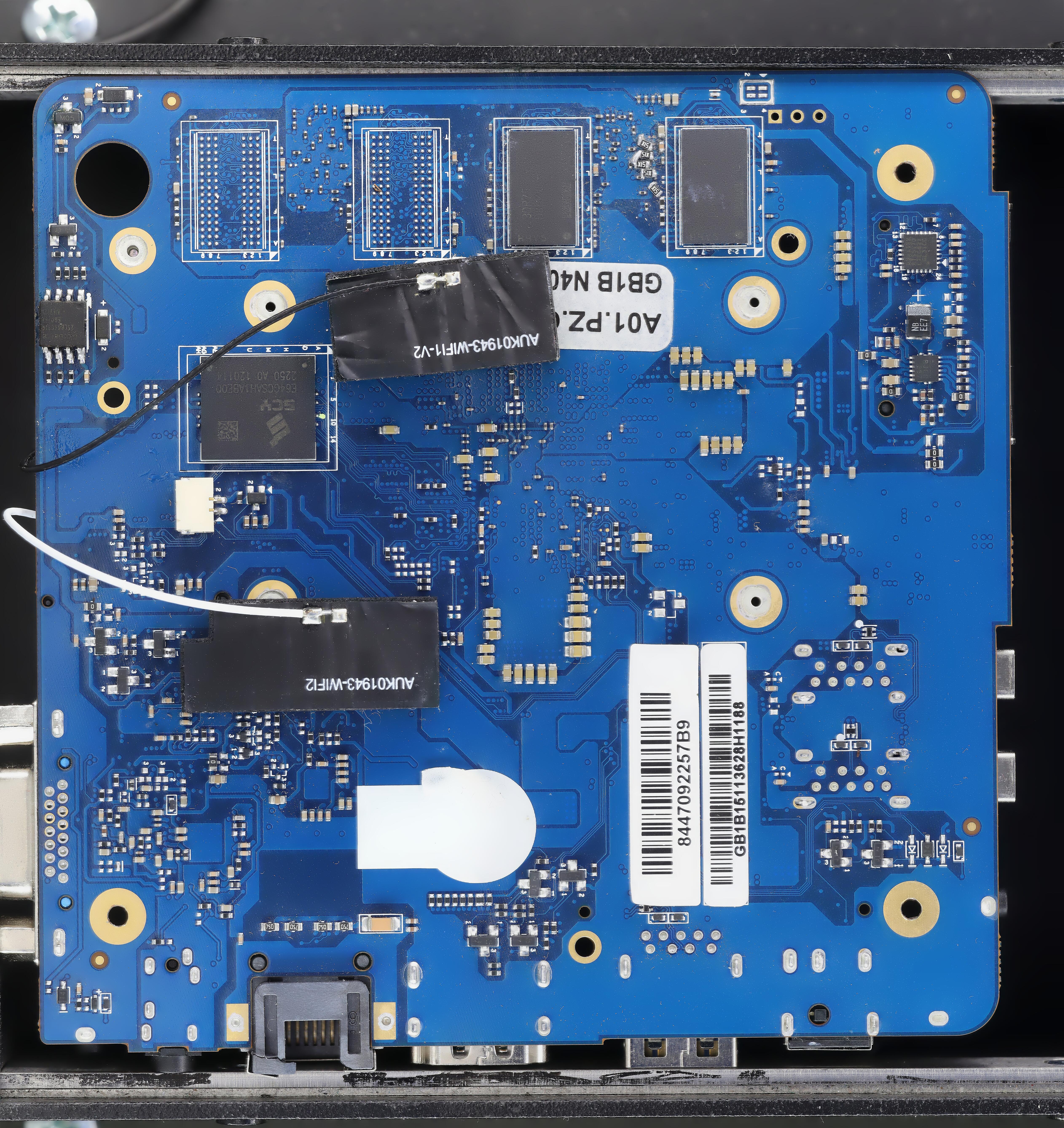

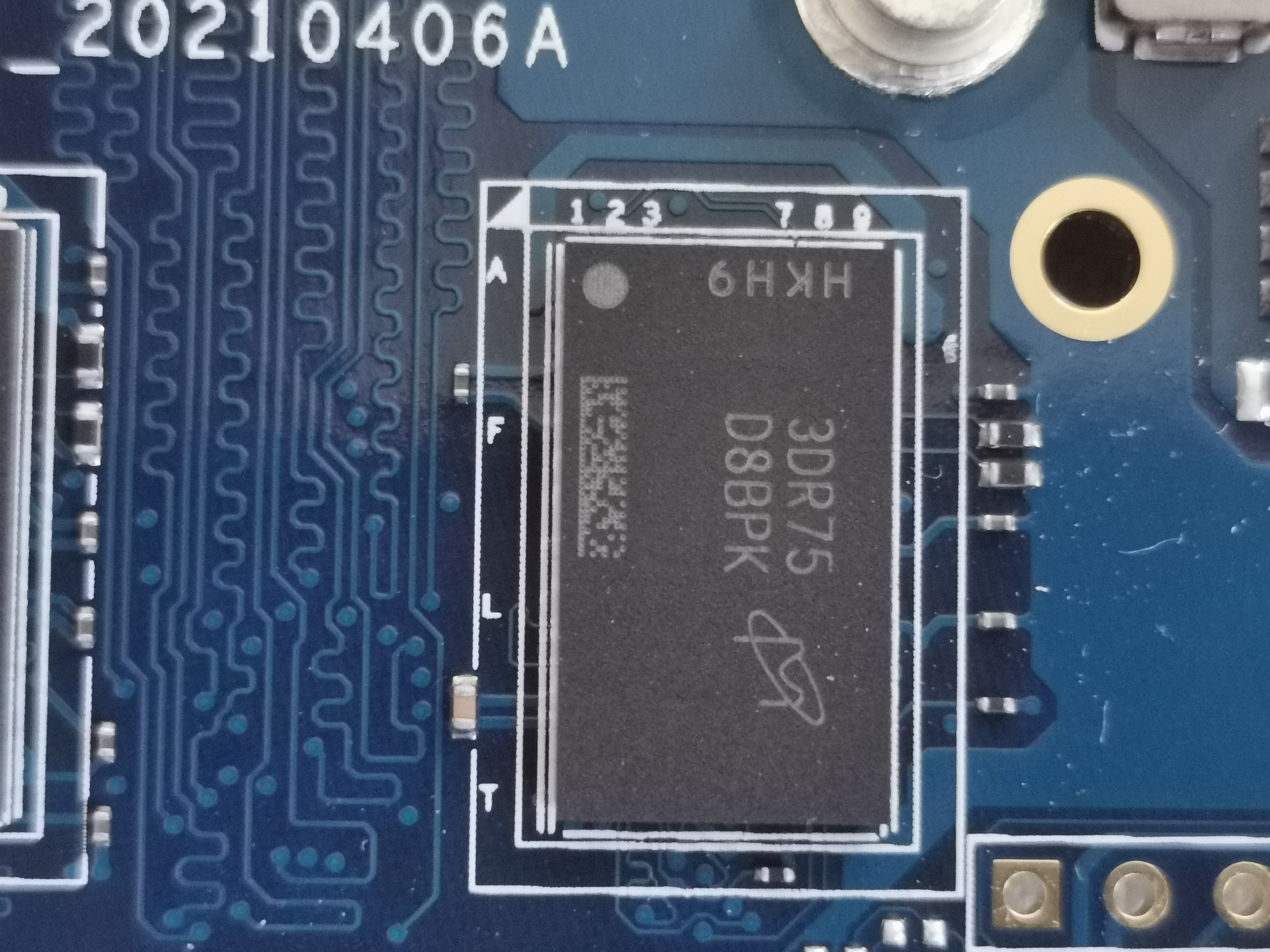

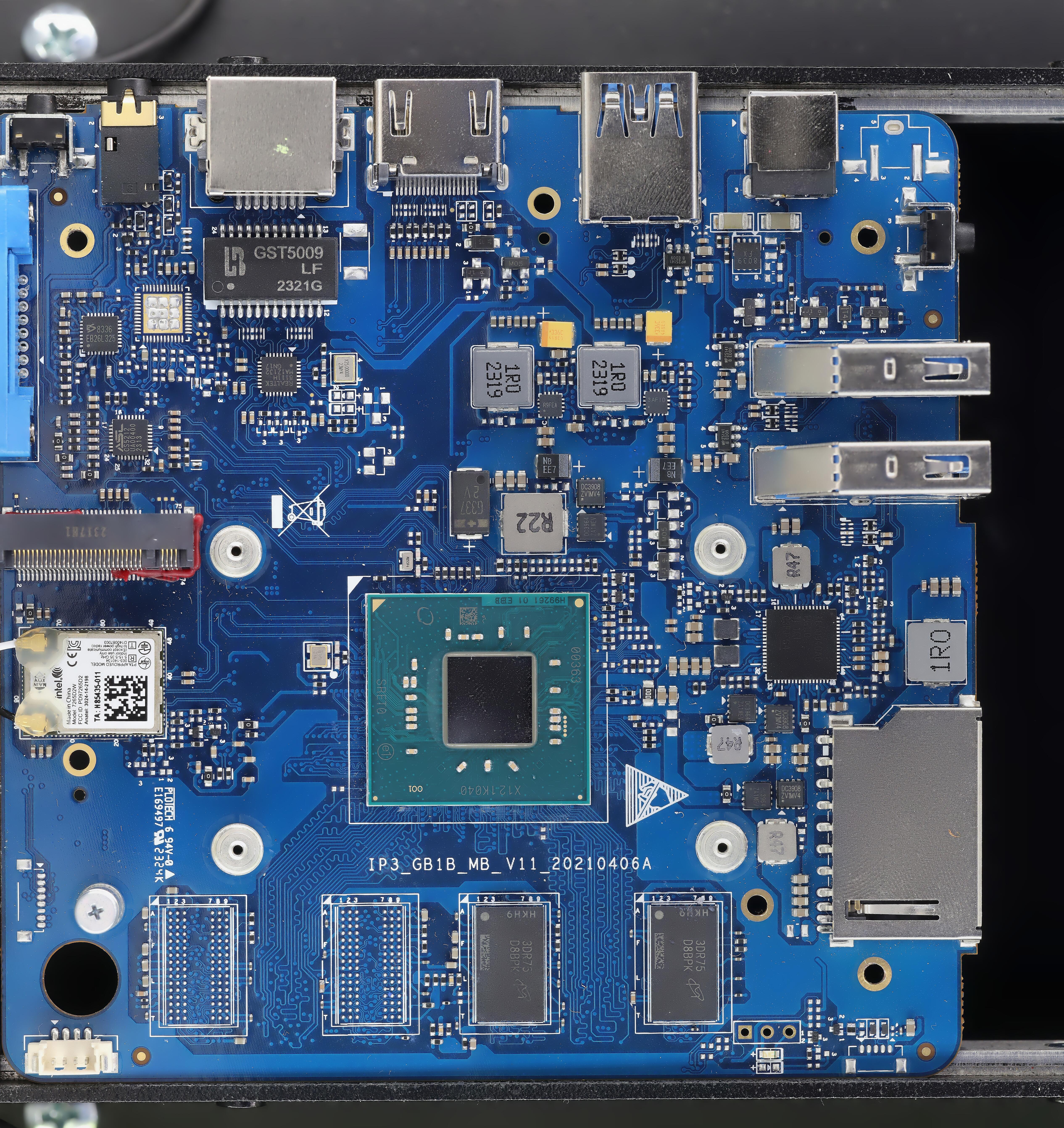

        Gave up on this board, high resolution pictures just in case somebody needs it
