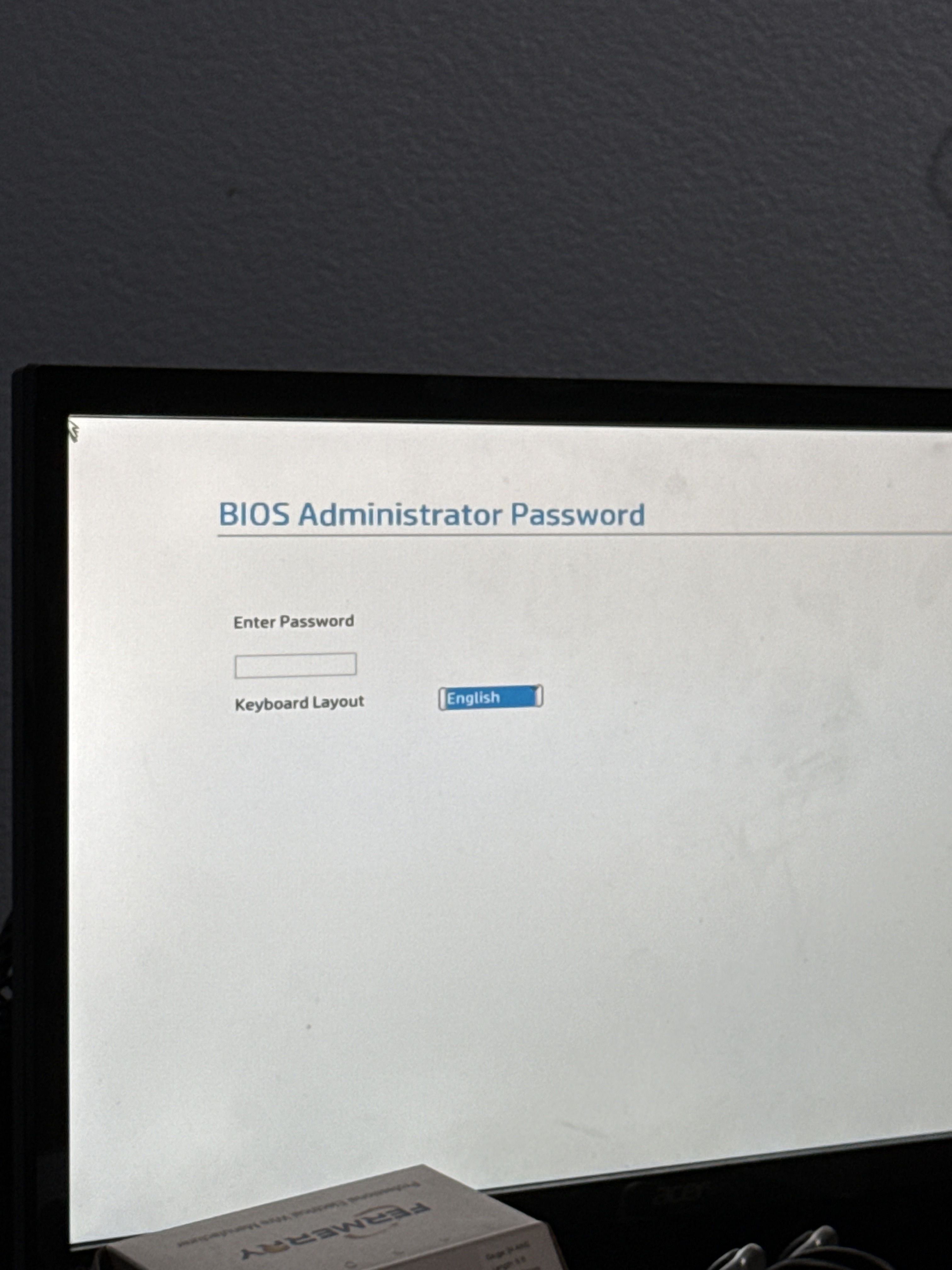

HP Elite Mini 800 G9 BIOS Password Unlock
  • alexhoopes
    • Jan 2025
    • 15
    Model: HSC-Q001Dm
    Serial: MXL4102Y9S
    Board: DAF96AMB8G0 REV G
    BIOS and EC (I think) attached.
    Thanks in advance, and if there are any guides into learning how to do this I would appreciate a link! I'd love to learn how to do these instead of coming on here to get the needed files.

          Flashing my backup and testing now but with your file I was getting 5 red beeps and 7 white lights
          • alexhoopes
            • Jan 2025
            • 15
            No success, same thing, does anyone have any ideas? Could something else have been damaged or do the beeps align with BIOS issue?

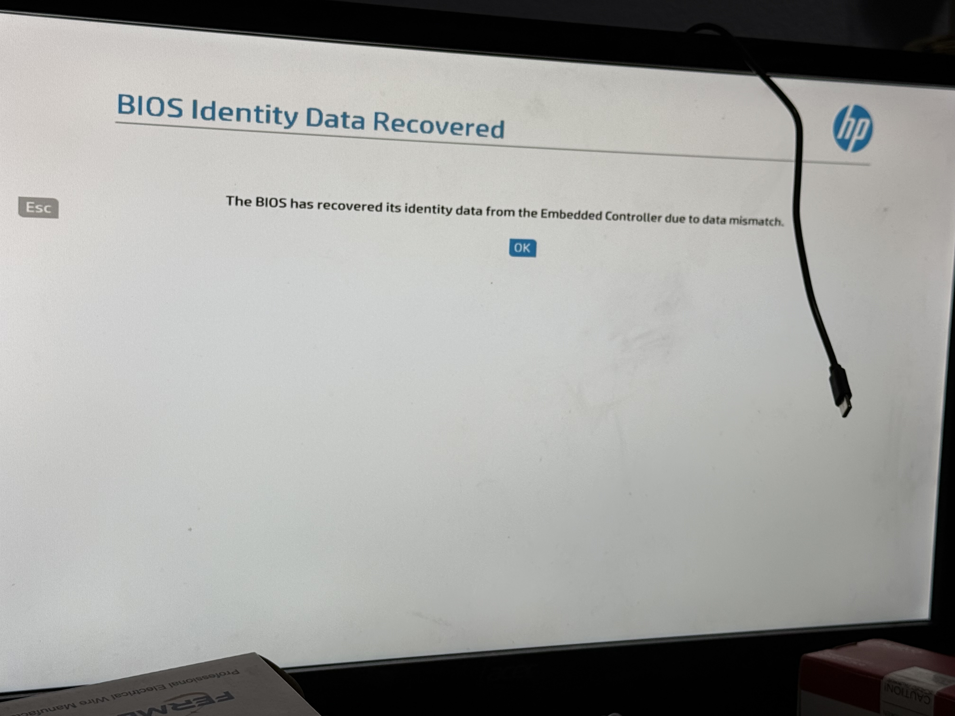

              I got the computer on, on initial boot there was a message about a mismatch between identities between BIOS and EC. I clicked ok since it said it would recover it and there was no other option. Now when I enter BIOS the password is still there. Are you positive EC does not need flash? what else was I supposed to do here if not?

                    Got the attached popup on first boot
                    Hit F10 on the next boot and it said entering setup menu then rebooted
                    Hit F10 again and am still getting the password prompt

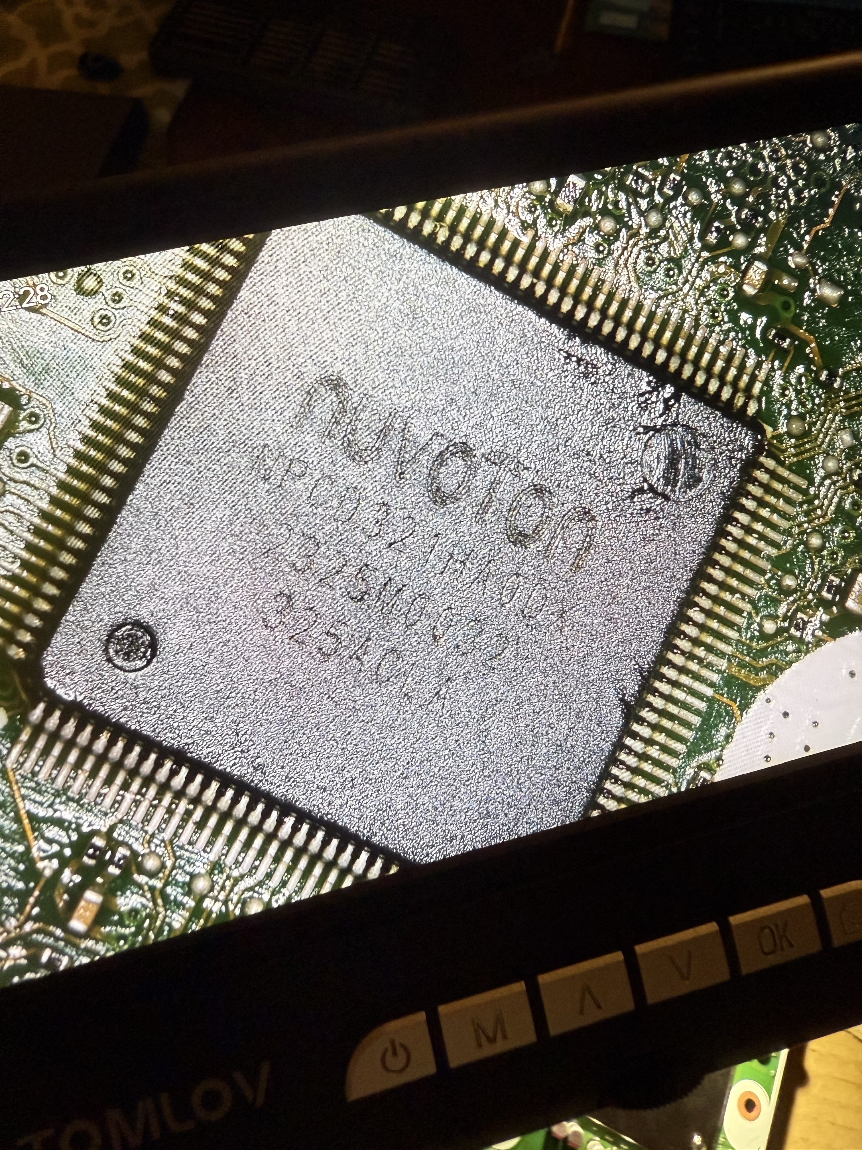

                        Can you take a picture of Super IO or its name?
                        • alexhoopes
                          • Jan 2025
                          • 15
                          Where can I find this?
                          • alexhoopes
                            • Jan 2025
                            • 15
                            Is this it, or another chip? Click image for larger version

                              There is a high possibility that the password and information are in Super IO .
                              • alexhoopes
                                • Jan 2025
                                • 15
                                Is there a way to reprogram it? There is no recovery method just flashing BIOS/EC? Can someone else confirm if this is true?

                                      No dice, same screen with the info being recovered from EC, reboots a few times, first boot into BIOS prompts a password
