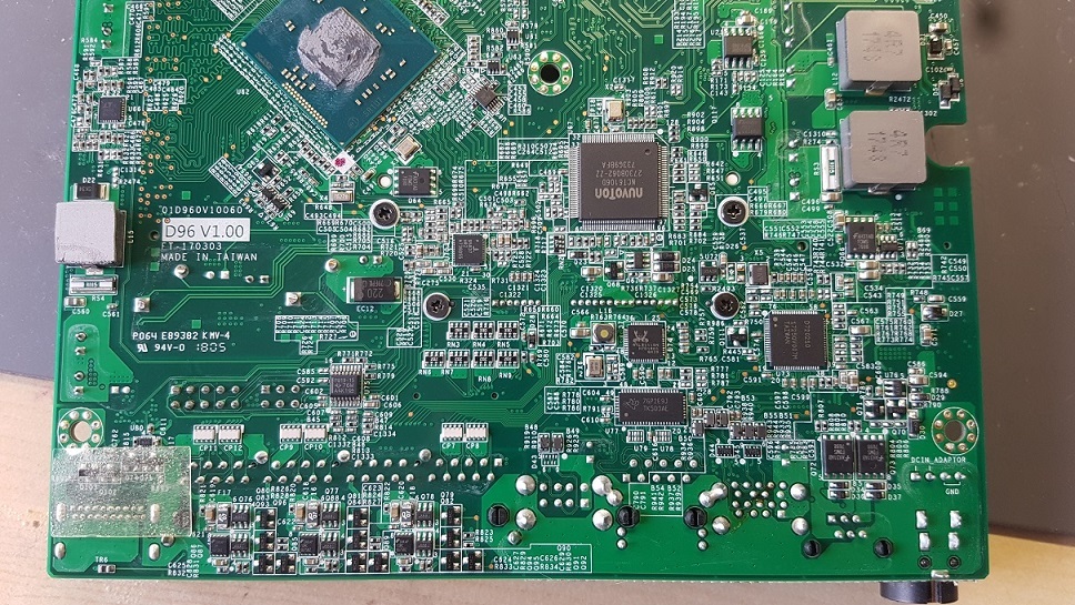

    Hi all!
    long shot but lets see
    POS device, with a what I suspect a corrupted bios.
    All power rails are up and running, but not POST.
    On Sango site cant find any bios file.
    Contacted them by mail and asked for it, but not sure they will even reply

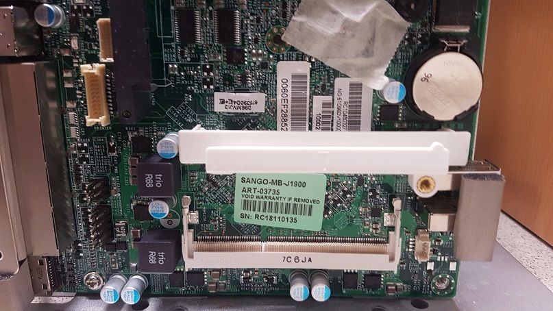

    Model: Sango J1900
    Board: SANGO-MB-J1900
    SN:RC18110135
    Would someone be able to take a look at this backup dump and check if something can be done ?
    Thanks for any help
    Apreciate it
    Cheers

              That BIOS its for ASRock MPOS-J1900AS, this board are D96 V1.00, see picture from first post.

                Look around the board for an 8MB chip, what you posted at #1 is the ITE EC firmware .Look at the part numbers on top
