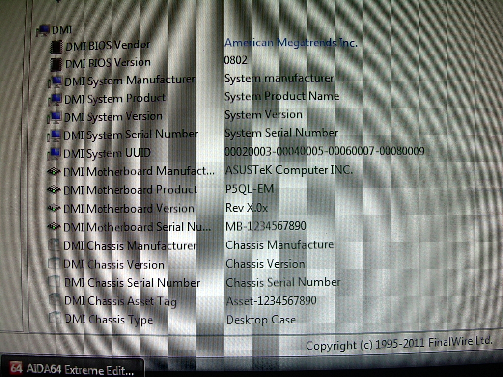

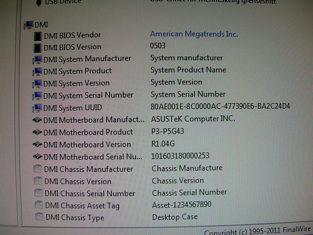

Found a Asus mb on the dump some time ago, tested the board and decided to update bios - after flashing it I realized I had done a crossflash but board was still working perfectly fine.
The board I found was for a Asus barebone called P3-P5G43, bios I used was for P5ql-Em.
The P5ql-em has some xtra hw like floppy,serial,xtra sata but I had no problem in bios, installing or anything else.
Found a picture of the p5ql-em on the net and took a picture of mine and some screenshots.
If you are going to test another bios make sure you have a backup of the bios and access to a programmer or a bios savior according to your bios socket.Comment
