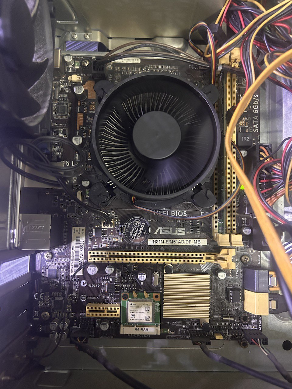

    Hello
    I need the M31AD (H81M-E) bios bin file. Can you help me if I cannot find it?

      Re: M31ad (h81m-e) bİos bİn
      Hello
      Asus Desktop PC
      Motherboard Model: H81-E/M51AD/DP_MB

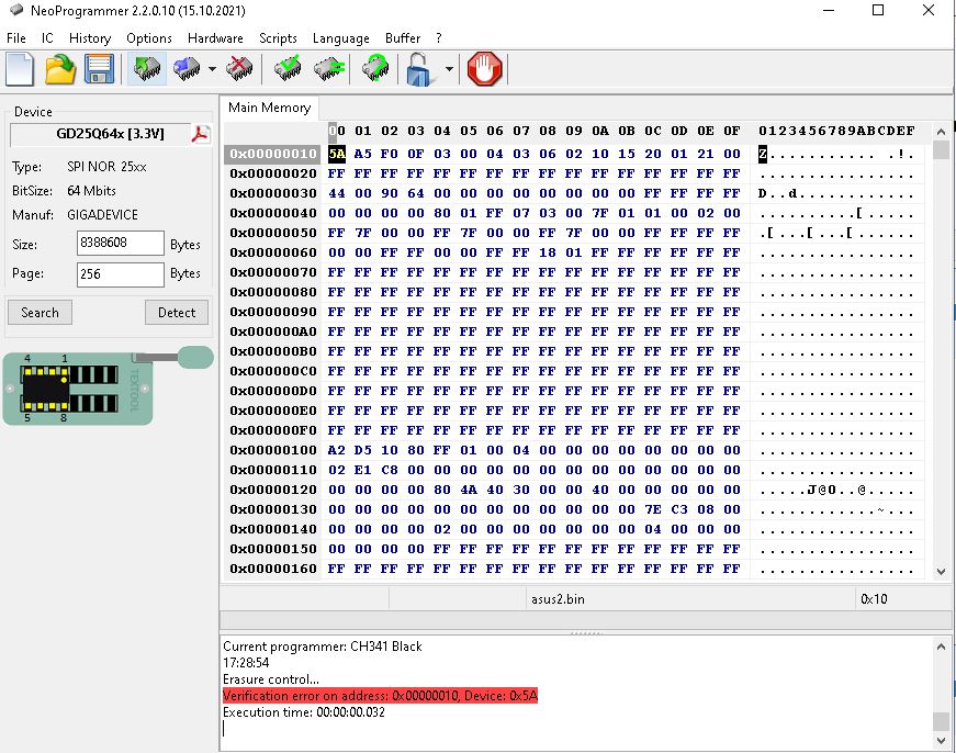

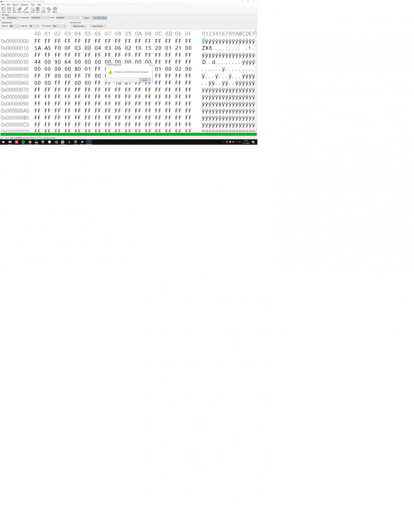

              hi friends, I did what you said, but it's not happening, I'm writing a chip, but it doesn't even do verification, it gives an error while it's not working on the computer, can you help, I didn't buy a new chip because the chip is broken

                What model is your programmer, CH341A, EZP**** .Have you desoldered the chip
                  i tried it in the old version, it didn't happen again, but it always gives errors and doesn't work on the computer
                    IC GD25B64BPIG chip, this is already socketed, I took it out, I plugged it into the reader directly.
                        CH341A yes

                          Try NeoProgrammer software ,you`ll find it using the forum search . Then,select the chip manually from the support list ,auto-detect on the CH341A is useless sometimes.
                            no, it also gives an error in this, I think it checks the bios file, I can't do it, you know? could there be a mistake there? it writes in, but I can't verify, it gives an error every time I verify
                              Replace the chip with another one.
