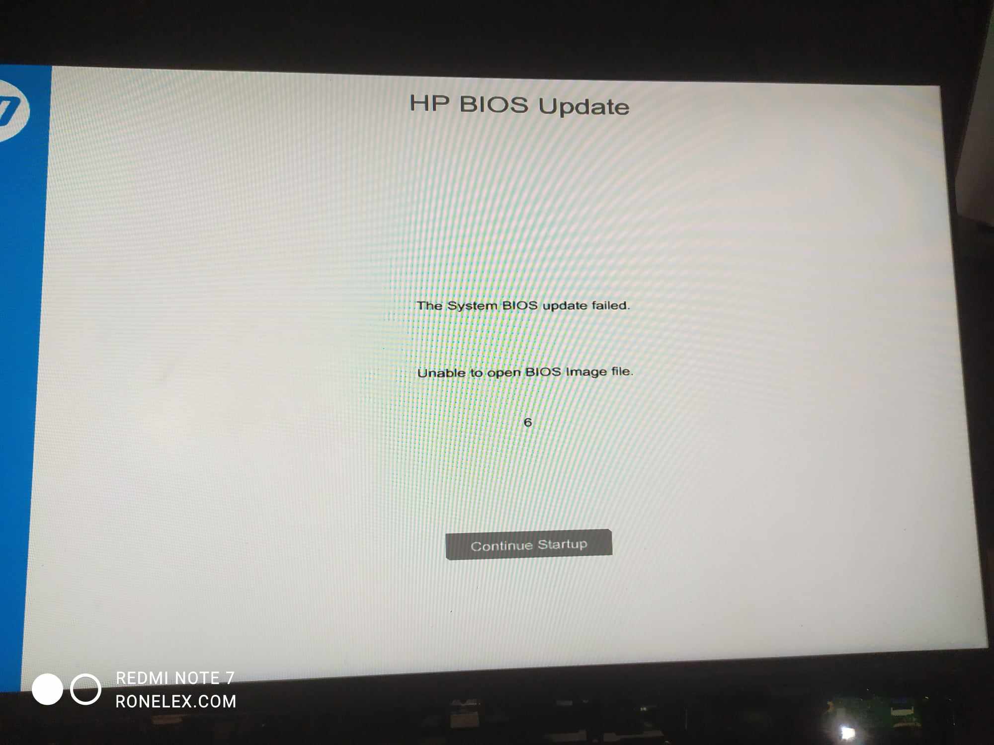

    Any one have dumped bios file for HP AIO PC 24-DF0214. It has an error says:
    The System BIOS update failed
    Unable to open BIOS Image File

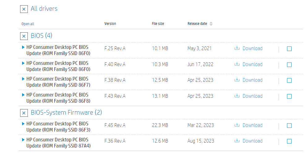

    I tried to get a bios on HP support but I an having a problem looking for the exact BIOS Bid for my unit. I cant extract the bios inside Bios-System Firmware
    Bios need needed is with BID : 86F3

    Same issue solved by one of our members https://www.badcaps.net/forum/showthread.php?t=123171 .Attached is your backup edited with the entries showing bios upgrade failed filled with FF`s.
    Run the bios update from support to make a recovery USB ,if it doesn`t run but only extracts to the SWSetup folder on your C: drive try again on another PC. Running that exe on my dell optiplex with an AMI bios makes it lock up and bluescreen. If you can`t run the exe make a recovery USB with the "HP PC Hardware Diagnostics 4-in-1 USB Key" instead there`s a link to it at the bottom of this post https://www.badcaps.net/forum/showpo...50&postcount=1 ,get all of the Additional Softpaqs as well
