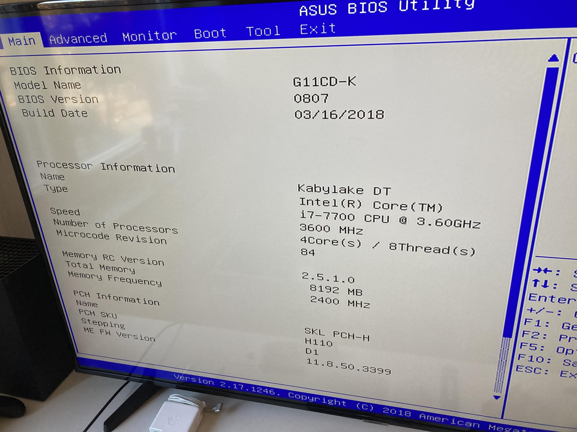

    Anyone here have a dump of BIOS for ASUS ROG G11CD? =)
    Could only find it on vinafix, but you need to pay for a account there.
    Also available on ASUS website ofcourse, but only as 16MB CAP-file, and my BIOS is 8MB? :O

    Attaching the dump I took from the original BIOS, though I am unsure if this works. Machine starts but no picture/post. Might not be bad, but I am fault finding =)

      Re: Asus rog g11cd bios needed
      G11CD - 16Mb
      G11CD-K - 8Mb
      Try this
          Originally posted by Lisa Su
          G11CD - 16Mb
          G11CD-K - 8Mb
          Try this
          OMG! It worked!! 😀
          Thank you!!
