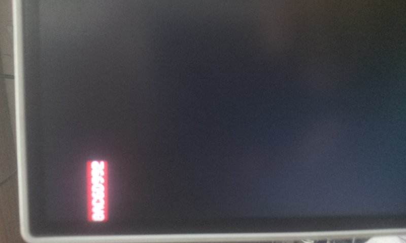

Dell cant save service tag inspiron 5400 All IN One
  • arif3203
    • Feb 2021
    • 55
    • Banyumas
    Please help me,Dell inspiron 5400 with service tag: 46KRF92 cant save service tag eror 8AC6D992,Test with other file same cant save service tag

    Re: Dell cant save service tag
    this backup bios
    • hardware1
      • Sep 2021
      • 2945
      • N/A
      Originally posted by arif3203
      this backup bios
      Here's your New bios file, try it and give me results. In the first boot go to bios menu and type your Service tag, save settings then restart. If you see MDM, press Alt+F.
      Your Device is "All IN One", Next time you should create your thread in PCs section not in Laptop.
          same problem,cant save service tag

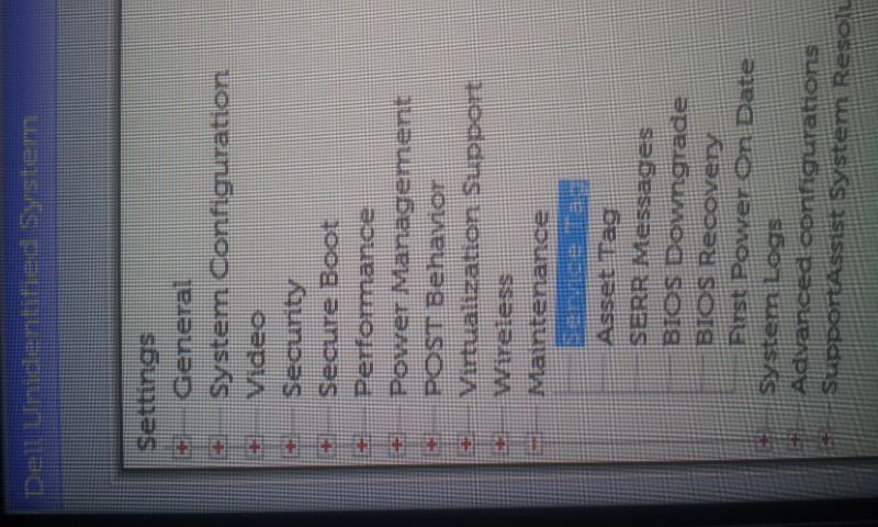

            this video problem,alt+f,after creat service tag,press esc,restart but not save

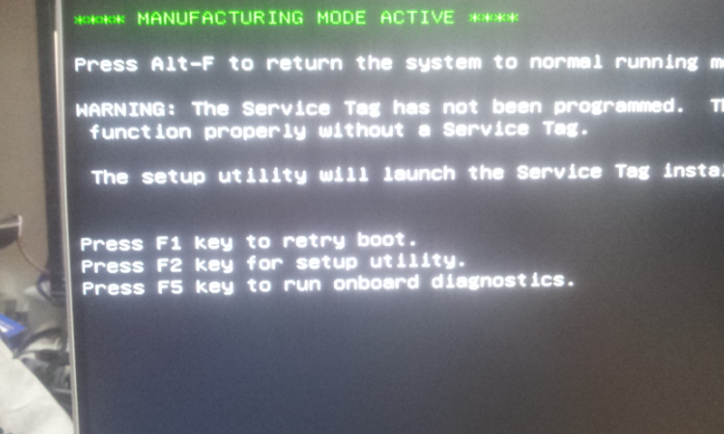

                How to solve manufacturing mode and service tag problem in Dell 10th & 11th gen pcs?
                I have this Dell 5400 all-in-one pc with corrupt bios. I tried bios from another thread and it worked but the problem is that it remains in manufacturing mode and doesn't save the service tag. I tried different options (alt-f, alt-f in bios setup, load defaults, bios update) but none worked. It also shows DELL UNIDENTIFIED SYSTEM in bios setup and a red error during boot. I also tried Dell 7700 all-in-one bios posted by Hoaca388 but same problem. Does anyone know a solution to this problem or if possible fix its original file? A lot of thanks in advance.
                Service Tag: 62LLZC3

                • Ali5914
                  • Dec 2020
                  • 48
                  • India
                  this backup bios
                  please update after flashing this bin. wait for 3 mins after flashing bios as it might take some time.
                  • Ali5914
                    • Dec 2020
                    • 48
                    • India
                    Re: How to solve manufacturing mode and service tag problem in Dell 10th & 11th gen p
                    Hi, try bios from thread #9. It is csme cleaned so it should work for your machine as well.
                    • ASB
                      • Dec 2020
                      • 133
                      • Pakistan
                      Thank you so much for quick reply. I,ll check it tomorrow.
                      • ASB
                        • Dec 2020
                        • 133
                        • Pakistan
                        Didn't work, same problem .
                        • volinakis
                          • Jan 2021
                          • 2828
                          • N/A
                          are you for real? "press esc"??? Press OK to SAVE IT!

                            • volinakis
                              • Jan 2021
                              • 2828
                              • N/A
                              This method doesn't work for 10th & 11th gen dell desktops & all in one pcs. No matter how many times you try, it won't save the service tag. I have faced the same problem in dell vostro 3888 (10th gen) after bios repair and couldn't solve it.
                              really? I just unlocked an 5400 AIO 2 weeks ago! write ST, press Enter, it will show a window "are you sure you want to save this service tag?" click OK then APPLY CHANGES - on bottom of screen - it will appear a windows "are you sure you want to apply this changes?" , click ok, it will restart and then press Alt+F.
                              • ASB
                                • Dec 2020
                                • 133
                                • Pakistan
                                Did u repair/modify its original bios by replacing BIOS REGION because I have done exactly what you have mentioned but it doesn't save ST and also shows an error (8ac6d992) during each startup. It also shows DELL UNIDENTIFIED SYSTEM instead of DELL 5400 in bios setup. Maybe the problem is that I haven't repaired its original bios (i tried but it didn't work). Can you plz share the bios which worked for u or repair/modify the original bios (attached in post#8) of my 5400 aio? Kindly help to solve this problem because its very important.
                                • volinakis
                                  • Jan 2021
                                  • 2828
                                  • N/A
                                  nope, post damaged dump and will try to rebuilt. Better, ask help from hardware1, vesko, peste, SMD, they are masters in rebuilding damaged bioses, I did learn from them.
                                  Edit: now I see you posted your dump, i will try to rebuild it. bios that i modified it will not work on your machine, i have to clean ME.

                                  • ASB
                                    • Dec 2020
                                    • 133
                                    • Pakistan
                                    Thanks for ur help. Indeed they all are experts in bios repair.
                                    If possible, share the bios which worked for u without clean ME. It may be of some use.
                                    Edit: Did u copy/save the BIOS.BIN file again from 25Q256 ic after adding and saving service tag to it? If yes then please share it. I will try to merge it with other files as it will already has service tag added to it.

                                    • ASB
                                      • Dec 2020
                                      • 133
                                      • Pakistan
                                      Re: Dell cant save service tag inspiron 5400 All IN One
                                      Problem solved. I repaired its original corrupt bios with FIT and everything worked perfectly. Thanks to all for ur help.
