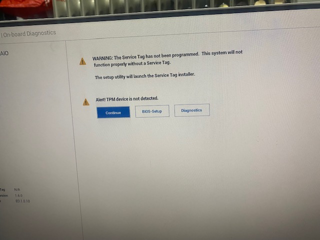

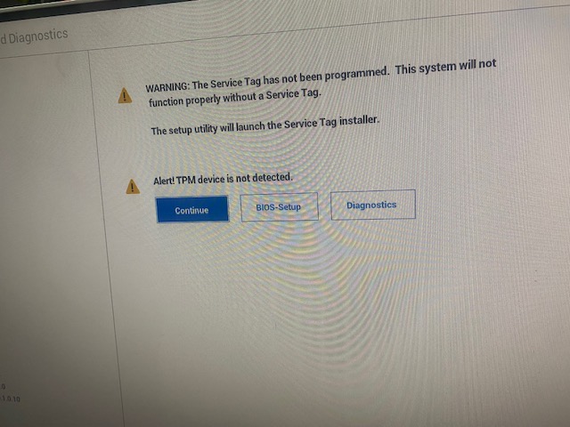

    hi all
    can someone please repair this bios for me for dell inspiron 5400 aio, my bios is giving me half fan spin and stop, i tested other bios which work but i can not save the service tag and i have been trying for hours
    anyone please can repair my bios, many thanks

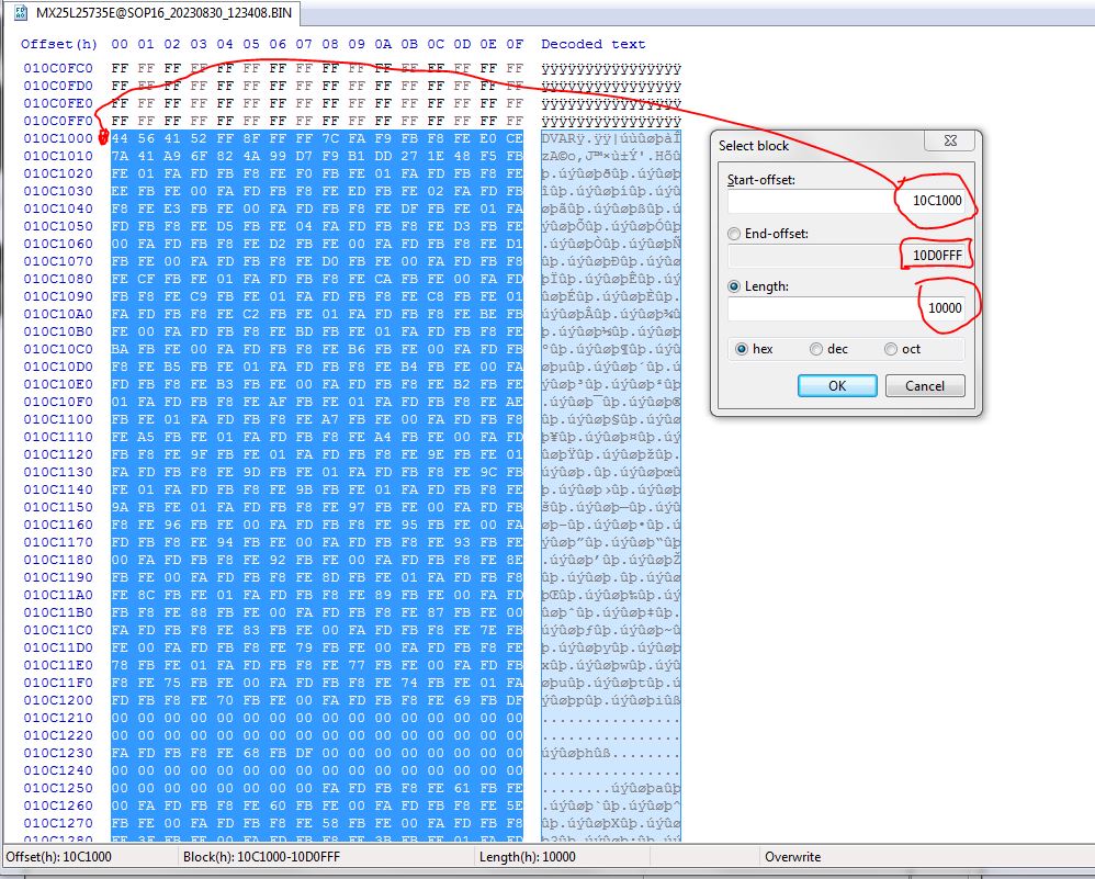

      Can you use a hex editor,if you can`t its time to start learning. HxD Hex Editor - https://mh-nexus.de/en/hxd/ .Copy the DMI area from your bios to the working one. Copying just the service tag doesn`t work it must be the whole dell variable.
      10C1000 - 10D0FFF

        Hi, i don't mean to waist anyone`s time, i tried again and again replaced on the working one with my one just as per instrusction which you posted, i have got same issue i get asked to enter service tag every time, even though i save and do everything just like any other dell laptop write service tag, save exit bios laptop restarts on alft+f which i do than bios come up again to enter to save service tag, i have included few pictures after i have presses alft+F, service tag is C971G92

          Ok,try this one,i think i see where the problem is now.

            hi, thanks for the file yours din't work straight away but thanks to your file i got someone to clear me the file and is working very good
            so if anyone will have this issue i am posting here the file i used and than you can save the serial and it will restart and than do the things also it will ask you to choose 5400 or 5401
            thank you, for the community file included

                            Thank you brother, facing same problem and you save my AIO. I use SPI W25Q256JV; program using CH341A.
                                  10C1000 - 10D0FFF
                                  Sir, is the HeX address range same for all models, if not can you send the thread link where i can learn how to get it for different models pls. Thanks.
