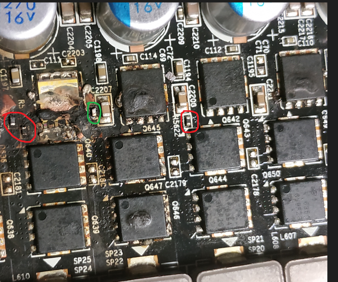

    Hello! I have a Gigabyte RTX 2060 super, I want to fix it, but I accidentally lost the components , 3 resistors (with red ones) are missing, I can't find the schematic of the Gigabyte RTX 2060 super (gv-n206swf2oc-8gd rev 1.0) video card anywhere. , maybe someone knows what they are resistors?
    And one capacitor (marked in green in the picture), maybe 0.1uf, but maybe not

    caaciors can bemostly anyone.that resistors is only around mosfets so mosly it is 0R resistors on gate signals
    but this card have many burned places, will be hard to repair if GPU survived

      Ok ill see what i can do. Thanks
