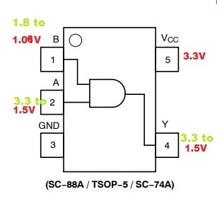

        this 3060 vision schematic is the same at this circuit so i attach schema of it
        I found that problem is inputs of U15. on picture u see that inputs to gate goes down to half after second from first start. any hint what can be source of it?
        I also have all voltages ok when start and after secon it goes down

                Re: Gigabyte RTX3080Ti - missing EN voltage for PEX_VDD
                Originally posted by SMDFlea
                Q504a/b ,r55
                looks like schema is different on this one. 1 input to u15 is just pullup from 1.8V and 2nd is connected to 4 mosfets conected to groud as some kind of powergood cotrol circuit. on first mosfet i have signal to put it to ground. whe remove first mosfet input is stable 1.8V. now i must find where that first mosfet iput goes

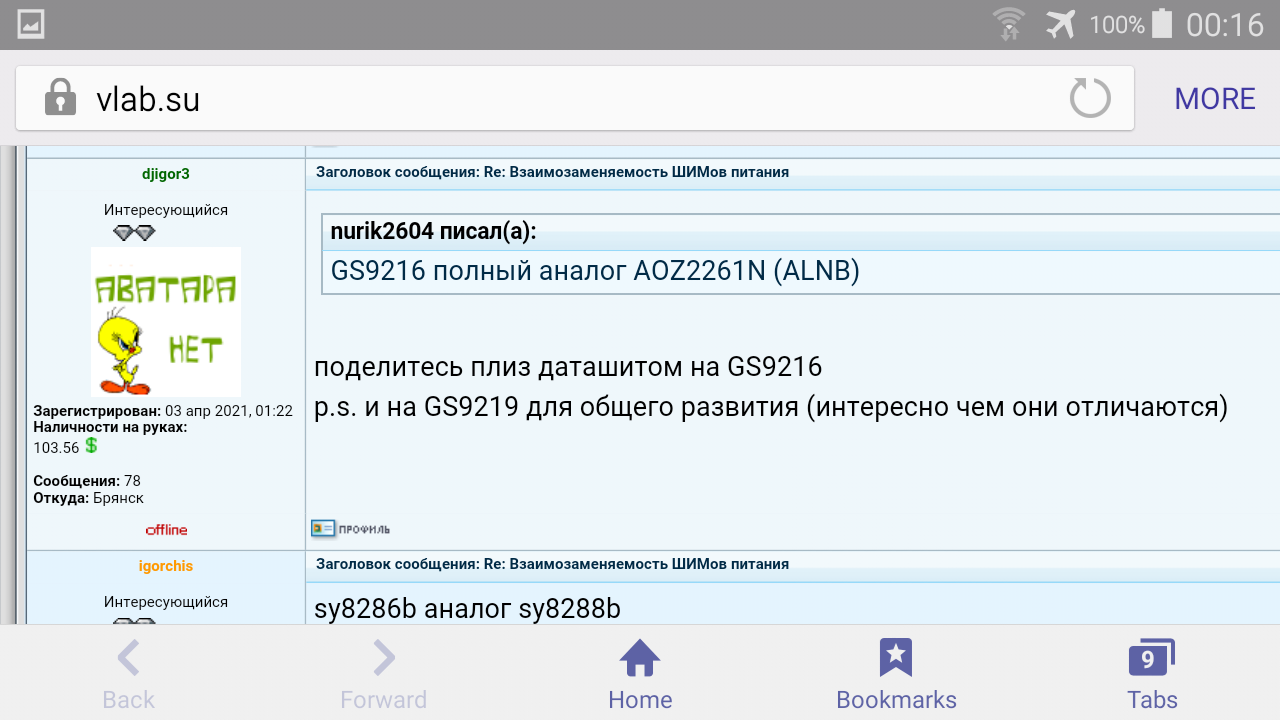

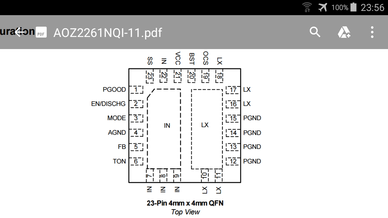

                              • Planet Earth
                              I try to find something and hook up on russian or so page, I think that say that is AOZ2261N pin compatibile with gs9216
                              I dont understand this, can some confirm that, what is actualy write, reffered to?
                              From this forum is information about that:
                              https://********/viewtopic.php?f=178&t=3734&start=510
                              So datasheet with pinout if is information correct:
                              https://cdn.badcaps-static.com/pdfs/...db75a86549.pdf
                              • Mesuge
                                • Nov 2021
                                • 3
                                • Hungary
                                https://cdn.badcaps-static.com/pdfs/...8633417a48.pdf
                                I tested it sofar seems like the GS9238 and GS9216 are pin compatible
