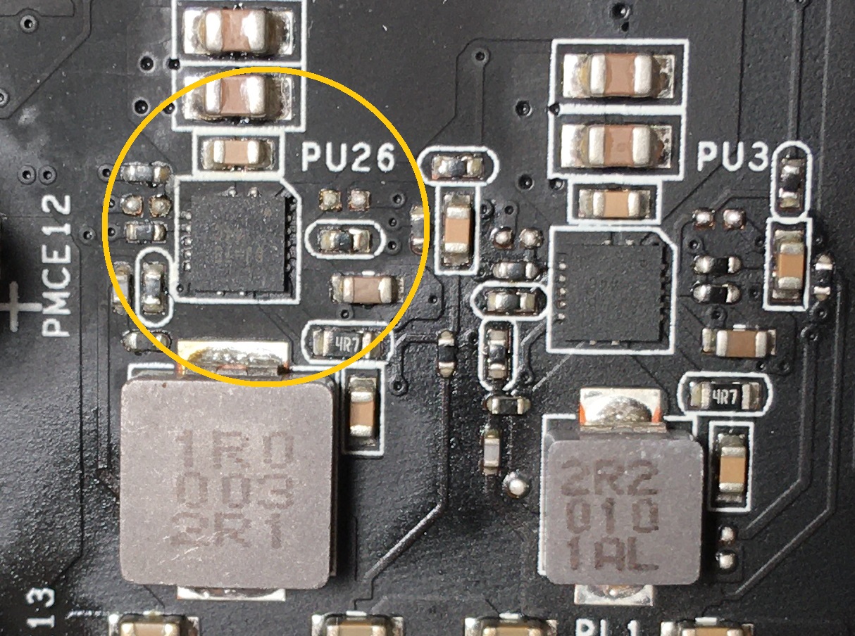

      Hello ,Same problem here but mine its an tuf 1660 super with diferent chips ,they say AEAM 119 , by googling it, i found symylar Synchronous Buck Converters that are produced by Alpha-Omega, maybe this are too . but by the code i cant find. on pinout apear be exactly the same as RT6220.
      The pex voltage it's down and i reflow ,work until i shutdown ,so the GPU it's good ,i s just the buck converter dead.
      i have no ideas where to find thisClick image for larger version
        It might be a Monolithic Power NB671GQ https://www.badcaps.net/forum/troubl...20#post1482820
        Datasheet --> https://www.mouser.com/datasheet/2/2..._1-2559831.pdf

          Originally posted by SMDFlea
          Might be!!.Thank you very much , i'm since 2021 register and didn't know this " marking codes" post. It goes directly to the firsts chrome's bookmarks,together with smd resistors codes 😁

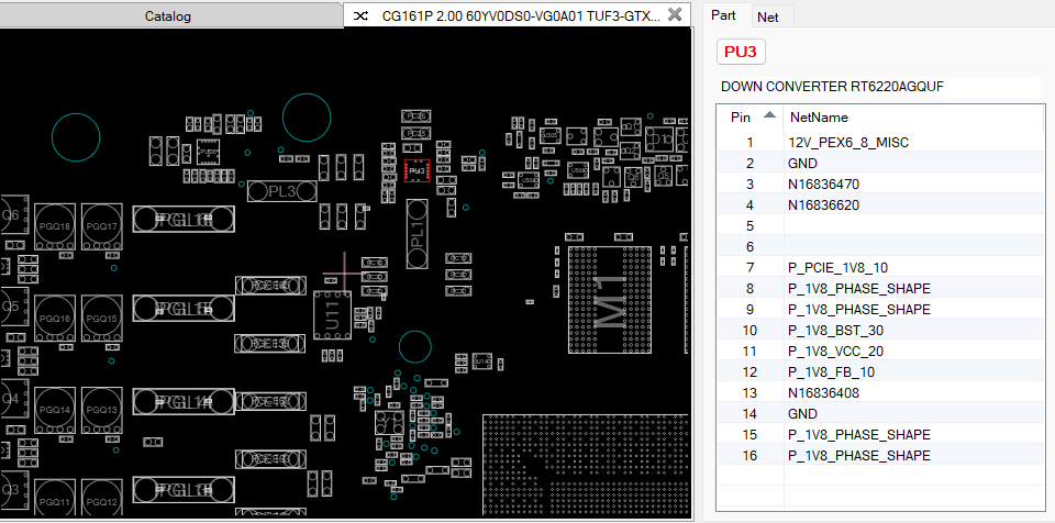

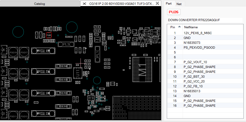

          • noname2024
            • Aug 2024
            • 291
            • CỎ MỸ XỊN
            TRY Click image for larger version
ID:	3572052 Click image for larger version
