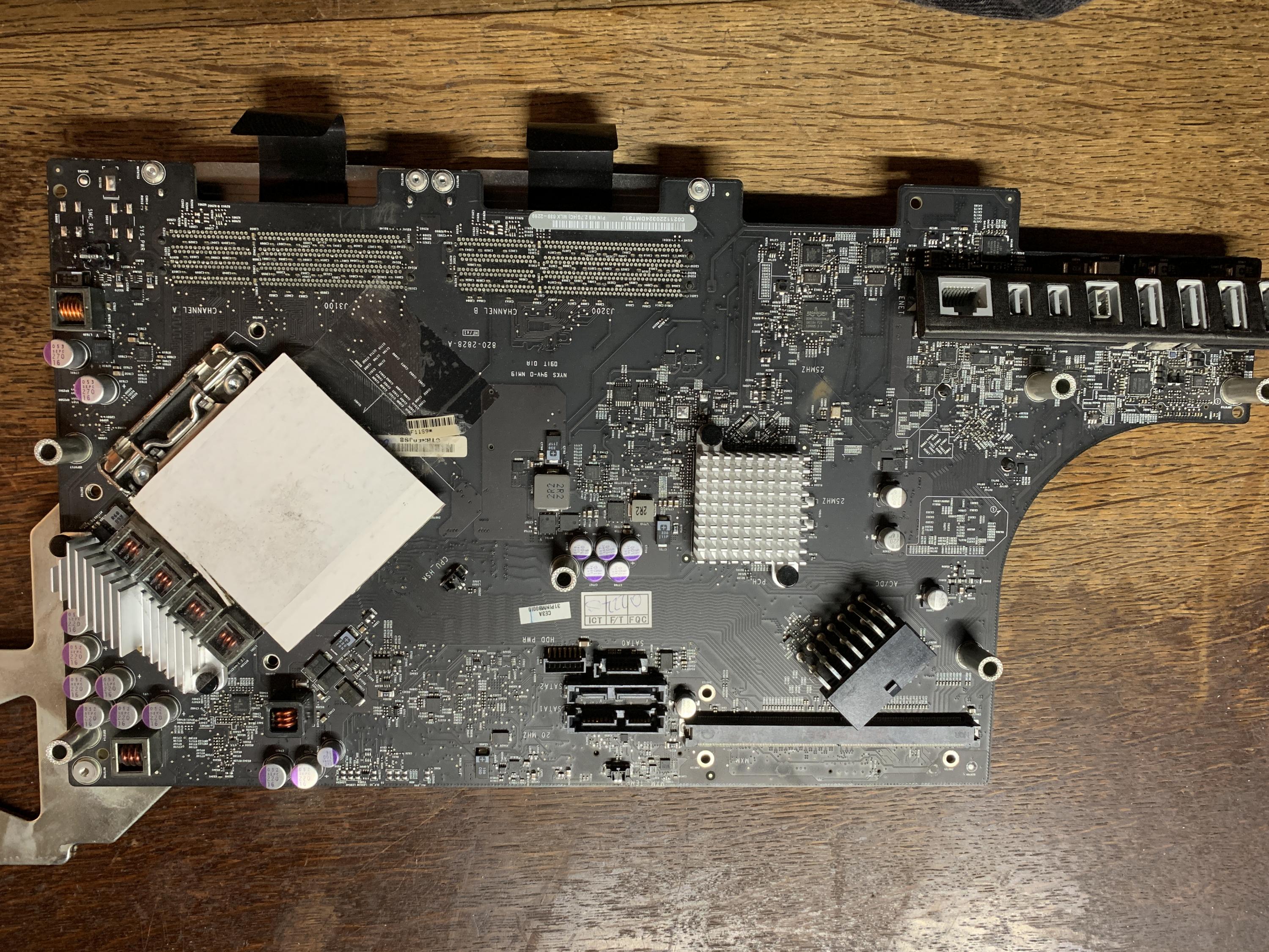

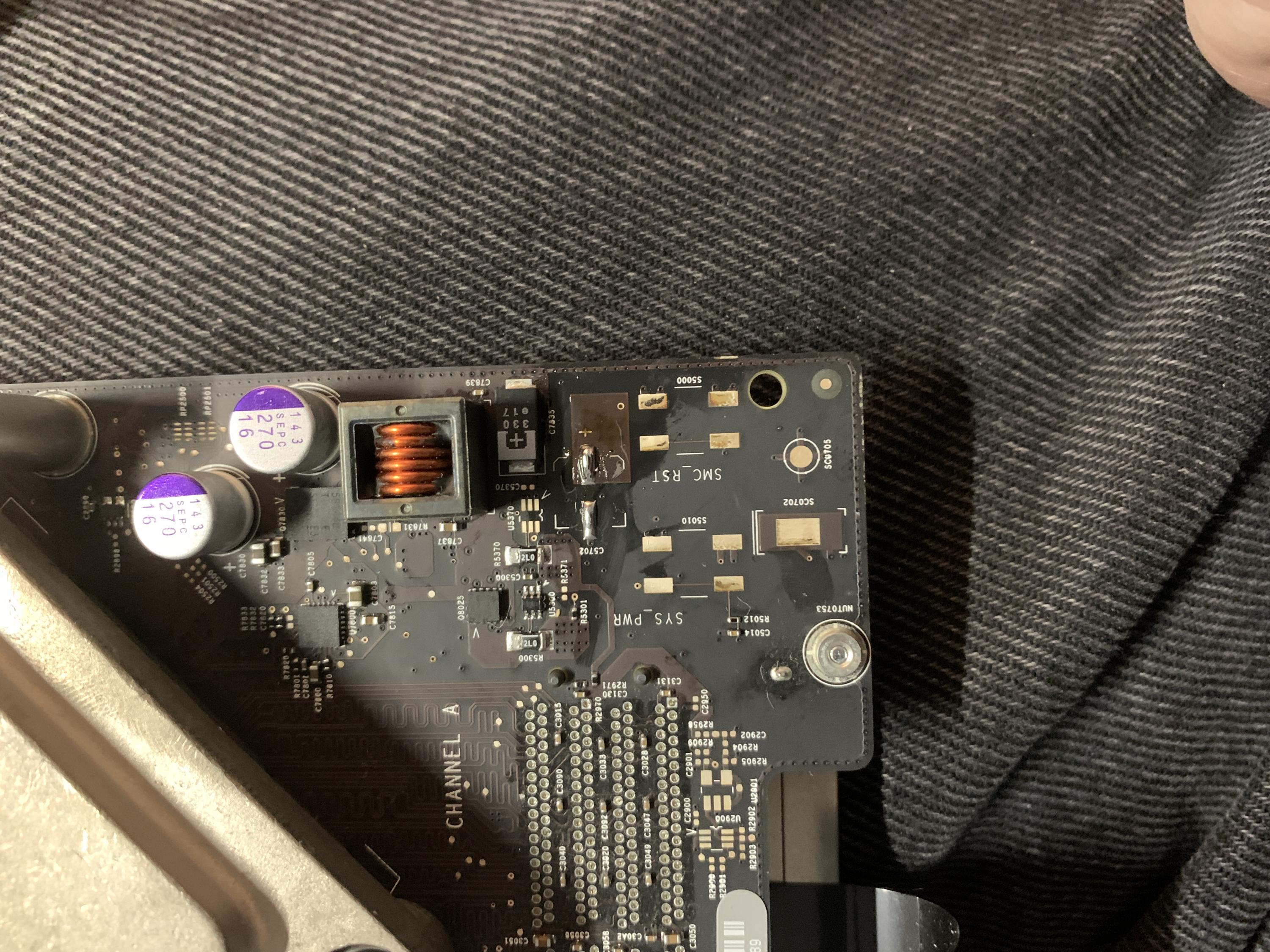

    I'm looking for info on what cap to get to put back on the mono of my iMax A1312 2011 27".
    It broke off the board when me and my stroke-riddled brain tried to put it back in the machine. I can't find the right board view schematics too. The symbols on the cap make identifying this one a bit difficult. I need some help here with what this thing is !
    Anybody ?
    I have it running Monterey, with the help of OCLP, and it even runs Logic too !
    I need it to run...
    Thanks !

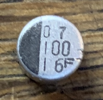

    The cap:
    Left side grey, on the right are 3 lines
    0 7
    l00
    l 6F

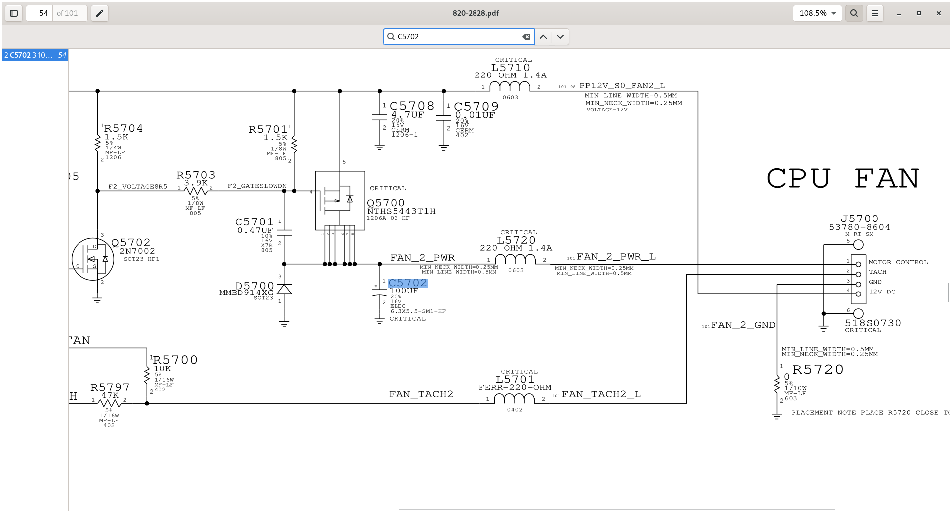

          https://logi.wiki/index.php/Board_Nu..._27.22_Unibody
          820-2828 2011 27" iMac

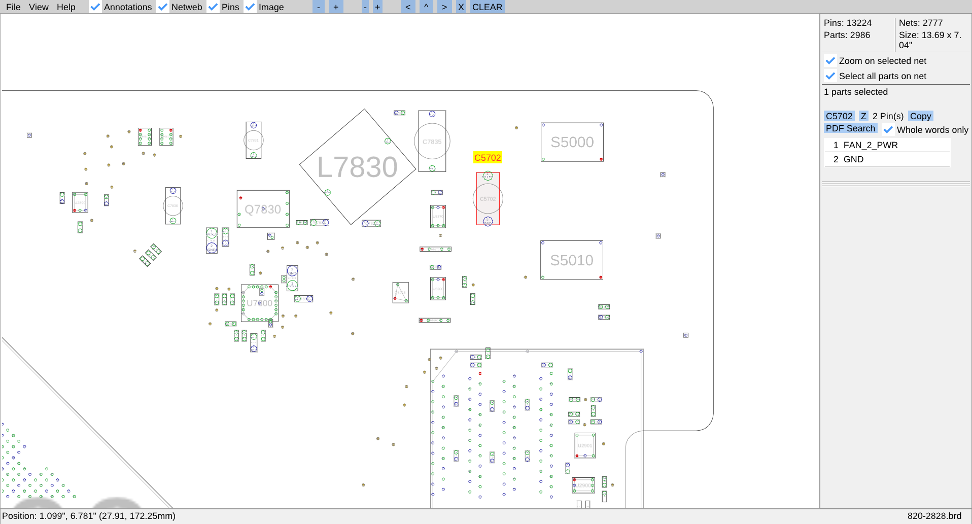

            Yes, thanks. But all the board view files I can find are the 082-2828-A, but it doesn't correspond with my board. It was purchased ion France, in 2011.
            Should that be the difference lol
            I just need to know what cap C5702 is, so I can order it and put it on the board.
            BTW in the schematics I have, the cap is on the other side of the board...
            I'm not making heads or tails of this.
            Also, no value is specified, so I don't know what to get for it.
            Anybody knows this please ?
            Thanks.

              Re: iMac A1312 2011 27"
              https://www.badcaps.net/forum/showpo...61&postcount=3
              Boardview and schematics are correct and have all the information…
