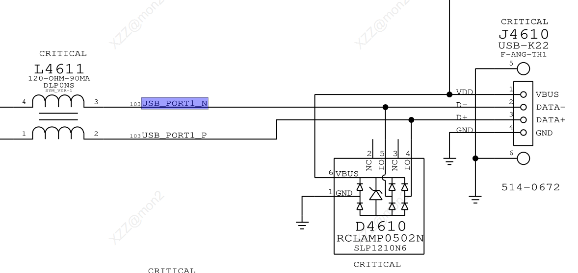

      Locate the USB (external) connector. Remove all power. Meter in DIODE mode.
      Red meter probe to ground, yes ground. Black meter probe to point to test.
      Test the following in DIODE mode:
      D+
      D-
      of the USB connector(s).

        Thank you! DIODE mode reads in all the the USB connectors:
        D+ 686
        D- 686
        • mon2
          • Dec 2019
          • 14693
          The USB ports are not damaged with these diode measurements. Any attempted repairs prior to your purchase?
