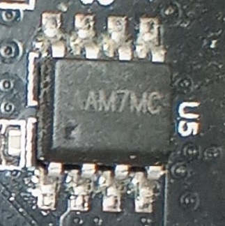

    Hello members,
    I have Gigabyte 1080ti Amp Extreme.
    It has a missing component near hdmi port as shown in photo. This photo is taken from Zotac 1080ti mini and mini has AAM7MC while Amp Extreme has AAM7MA missing.
    I need your help as i searched this component on aliexpress and internet everywhere but I didn't find any seller having it or any datasheet.
    IF anyone know about its actual name or marking please let me how to find it thank you.

    Re: Zotac 1080Ti Am Extreme missing components
    https://www.badcaps.net/forum/showpo...1&postcount=12
      Thank you I managed to get it from other source it is SY6288CFAC.
