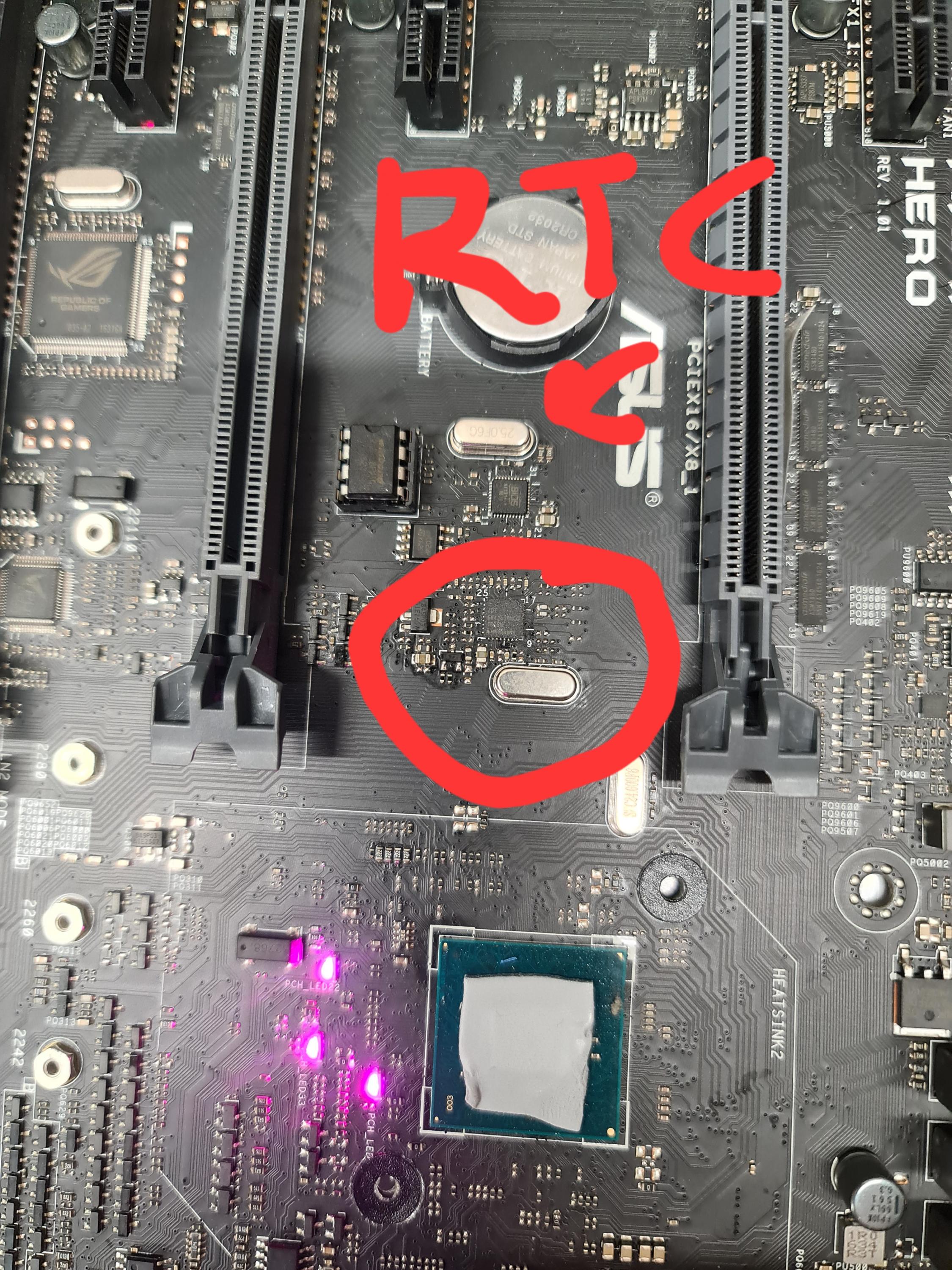

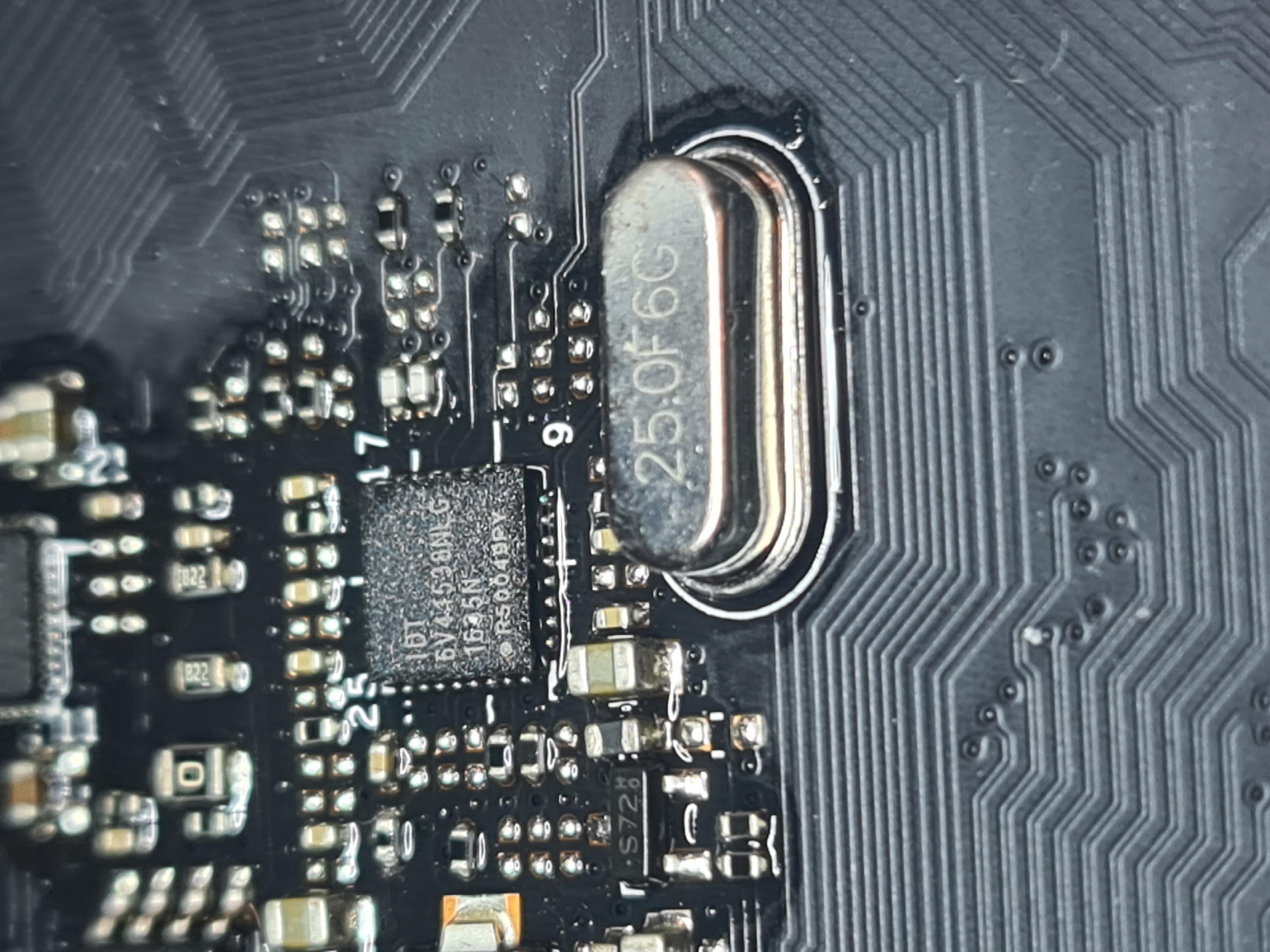

    Looking for pin out of a 6v41538nlg.
    It's a 32pin ic I think controls frequency boards stuck on 00 I have vcore and all other voltages it boot loops 00.
    I don't have anything out of the clock crystal.

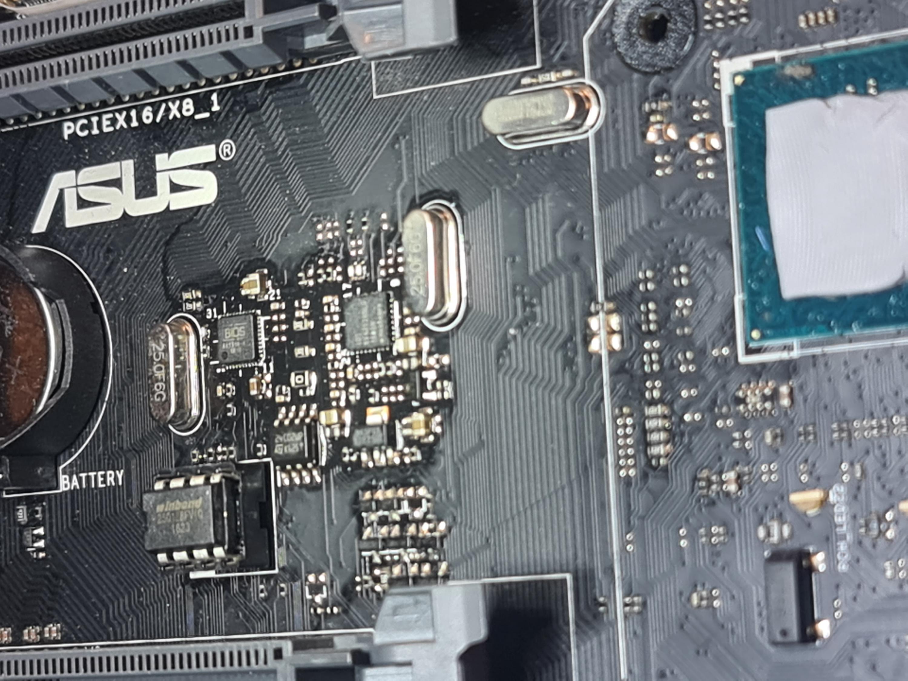

      Re: Asus maximums viii hero lga1151 rev 1.01
      The cystal is connected to 2 pins of that ic.
      There is 0v on both legs of crystal to ground.
              I'll try tonight on scope there was no output on the clock cystal connected to that ic.
              All other crystals are working.
              Board turns on cpu vrm starts and thats it I seem to have all voltages but nothing on that cystal it allows blk overclocking I think?
                Originally posted by soumya199929
                Measure both legs in diode test to ground.
                There's a reading of 0.57v to ground in diode mode on both legs of crystal.
                No wave form at all out of it.
                  Is this the RTC crystal there's 3 near one I think is pch.
                  • Davemack69
                    • Mar 2022
                    • 38
                    • United Kingdom
                    It's fixed
                    Had a ferrite bead on back of board open circuit it fed that ic.
                    Got signal on the crystal now and it's booted to bios😁
