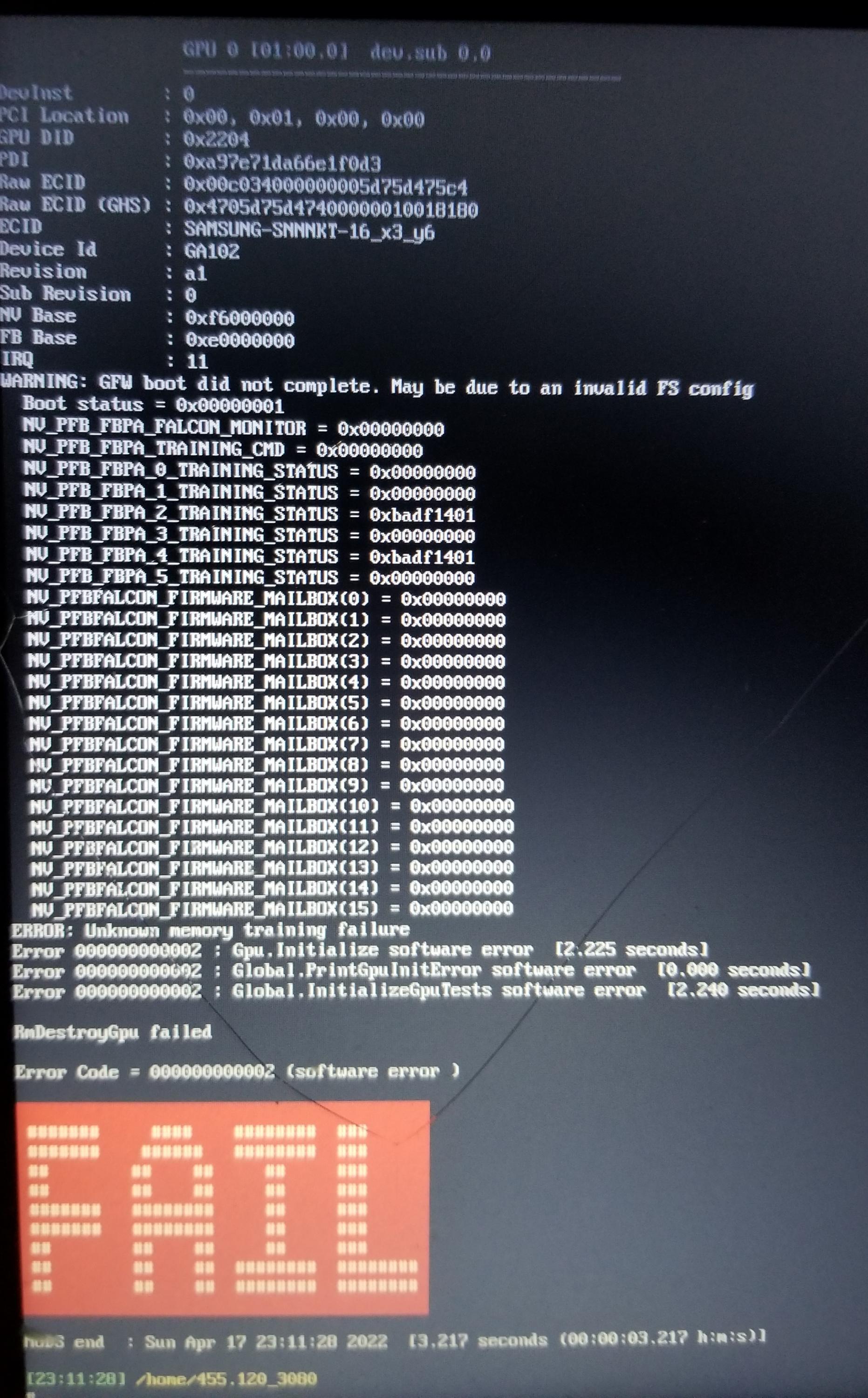

    Hi guys I have got strange case here.
    Running mods gave me result as what the photo says
    Unknown memory training failure
    RmDestroyGpu failed
    Software error
    Usually GPU with memory training error only would still be able to init and mods would be able to tell which memory bank(s) are/is faulty.
    Any help appreciated
