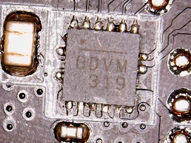

Hi need help identifying this buck convertor pic attached i need pin out there's no output tia
msi meg x570 unify,identifying this buck convertor
Re: msi meg x570 unify,identifying this buck convertor
NB503GQ-Z .There`s no datasheet available,you`ll find the pinout in the MSI MS-7B93 schematic https://www.badcaps.net/forum/showthread.php?p=1127510
