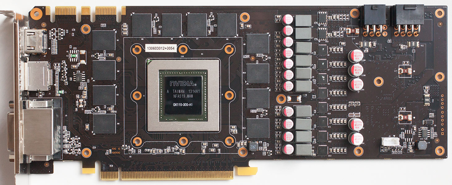

    Hi Guys!
    I have a Palit GTX 780 Jetstream card.
    The motherboard doesn't detect the GPU but fans are spinning with normal speed.
    I measured the main voltages and I found memory voltage (1,498V) and the core voltage (0,911V) and 12V, 3.3V, 5V.
    But I dont know, where could find the PEX voltage.
    Anybody can help me for that problem?
    Thanks.

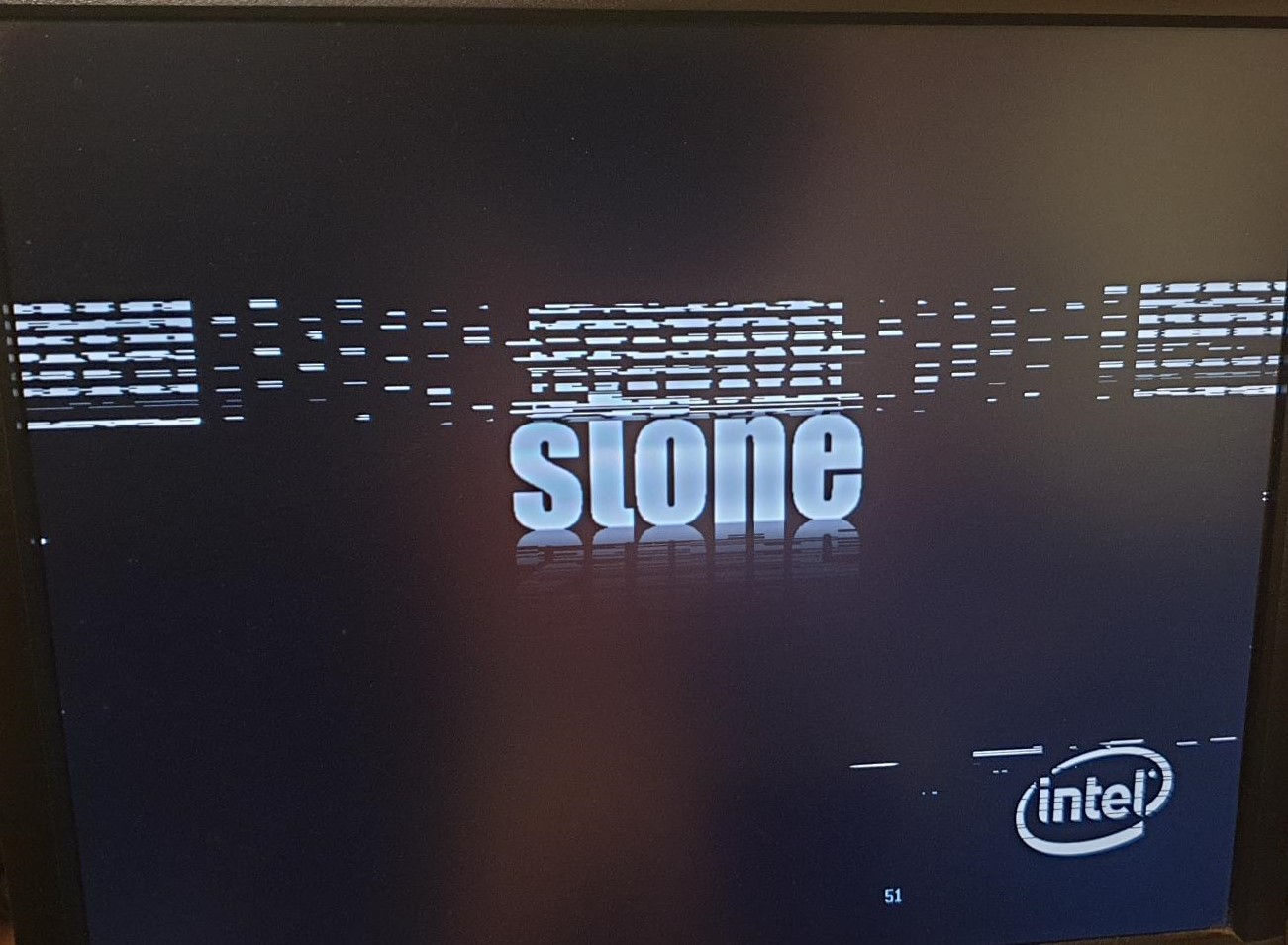

    Re: Palit GTX 780 Jetstream not detected
    I got a suggestion and I tried this GPU in x1 riser and linux is sees the card.
    But in the PCIe x16 slot the motherboard can't detect GPU.
    • Traptor
      • Nov 2021
      • 111
      • Magyarország
      I tested this GPU in the riser card as I mentioned and I took a picture from display.

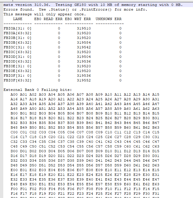

        I run MATS on this GPU and the I attached the result.
