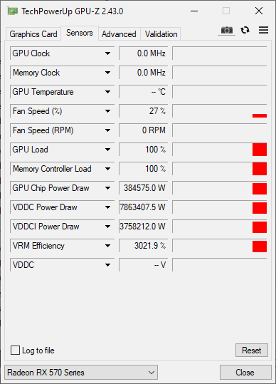

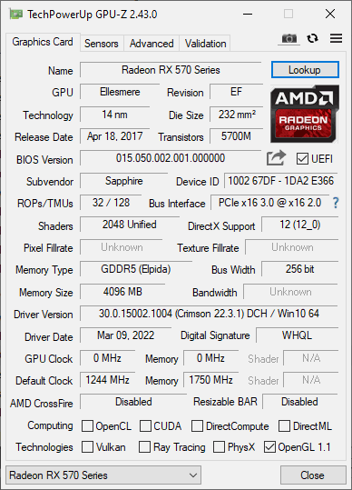

                            made some progress with this card, solved the rebooting problem by replacing the vrm controller and the pc stayed on for 12 hours without rebooting
                            card works as primary gpu for normal use no artifacts cant install drivers shows as code43 in device manager
                            in gpu-z it shows gpu clock as 0 MHZ

                              i tried flashing a new bios but amdvbflashwin doesn't detect it only the onboard graphics is detected

                                Re: Sapphire RX570 Nitro 4GB Repair Help
                                i ran another ram test with the dmgg.py script and got no bad chips
                                if its not the ram what are the other causes of code43
                                • didi79
                                  • May 2021
                                  • 80
                                  • BE
                                  Flash unpowered with something like a CH341A programmer?
