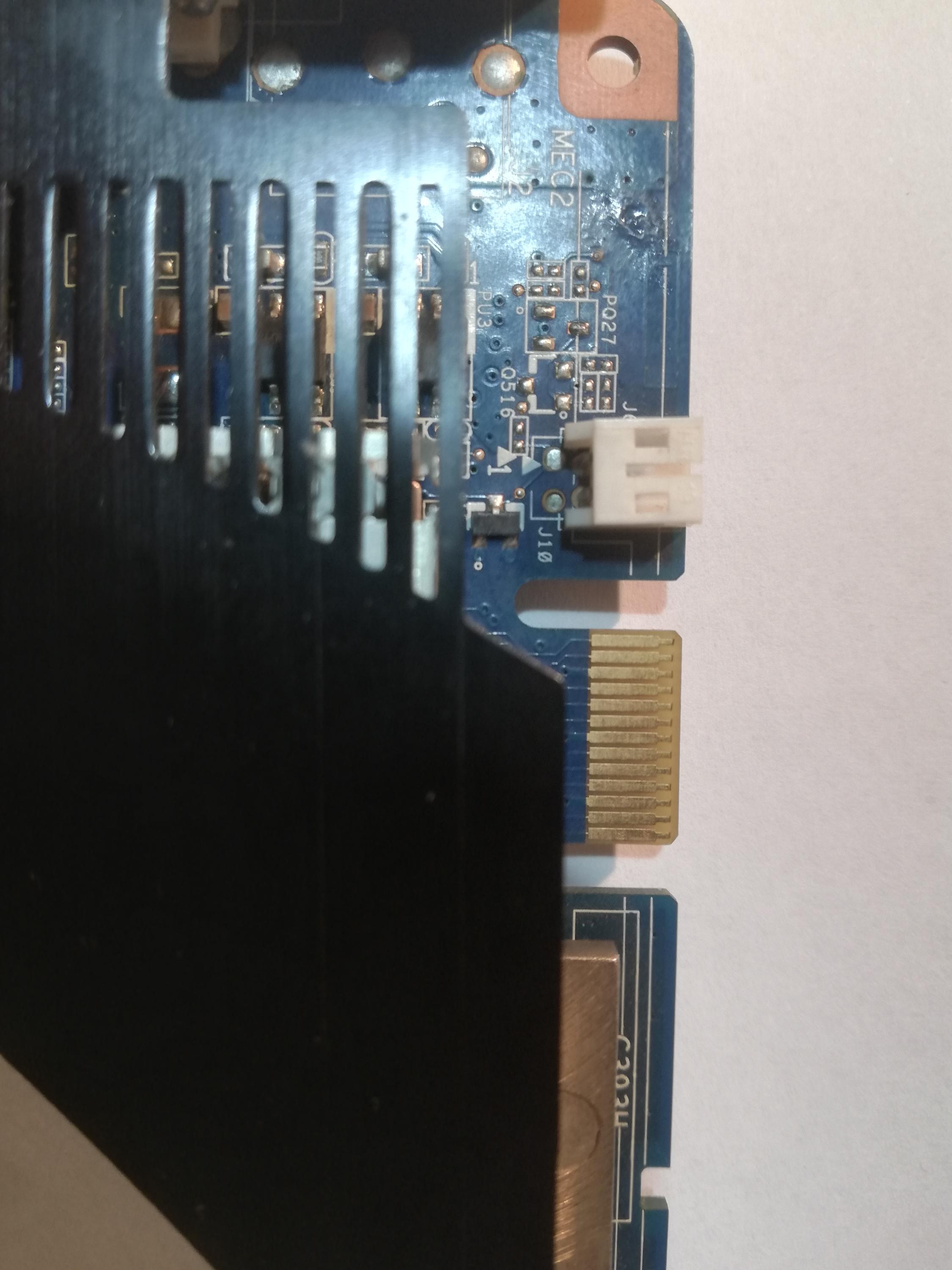

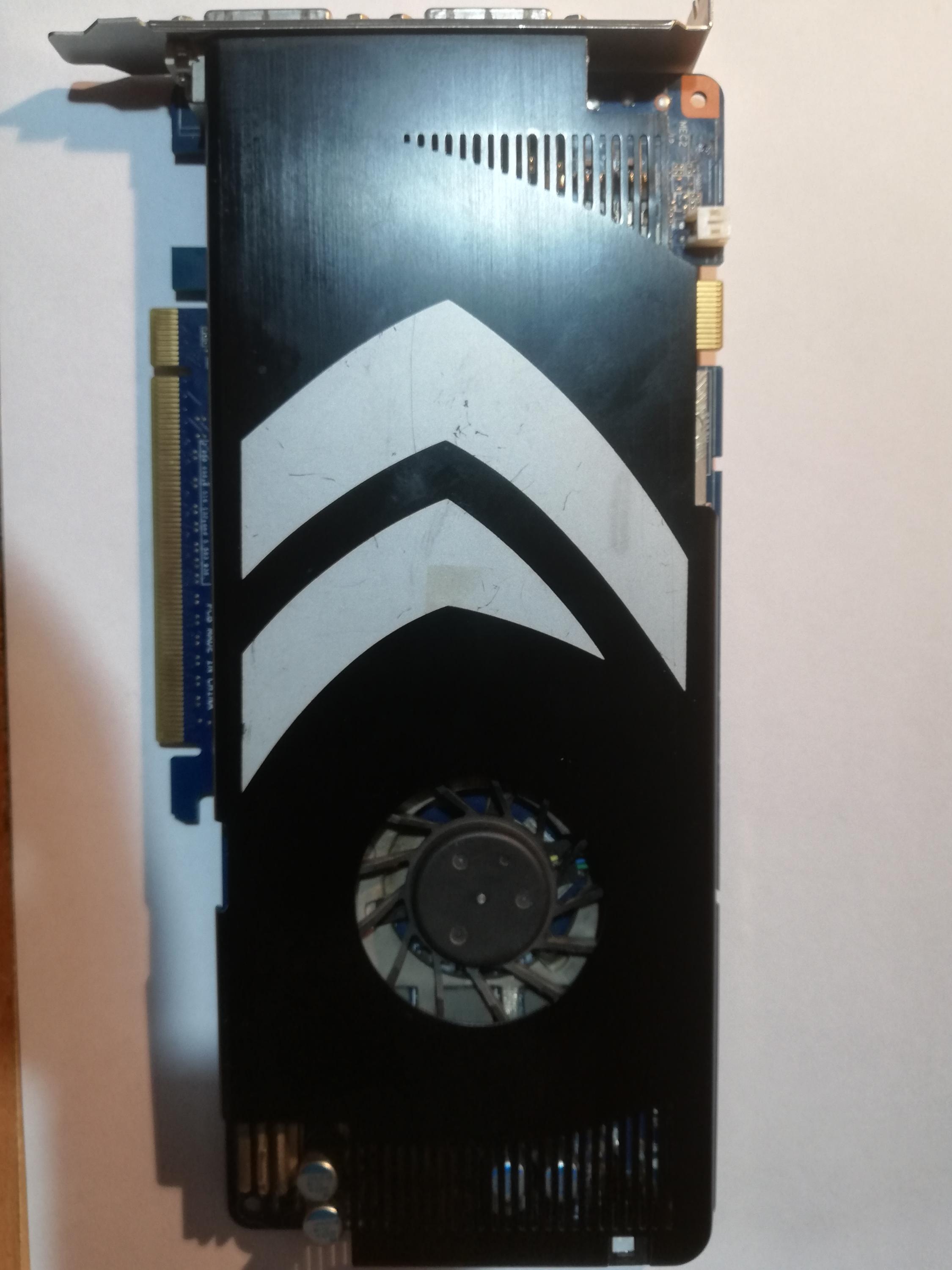

    Greetings to all. In an electronics market I found this old video card: NVIDIA GEFORCE 9800 GT 1 gb.
    The card is not detected by the pc.
    Do you know what the small white connector at the top near the output connectors is for?
    Thank you for your reply

    Re: Gpu Nvidia geforce 9800 gt
    This appears to be a common problem with GeForce 9800 GTs. IIRC, I saw this with a GeForce 9800 GT in 2009, shortly after a guy purchased it! (Apparently, the PC was only booting, because of the integrated video!)
    They are apparently known for just disappearing! IIRC, it didn't show up in Device Manager. (or Device Manager reported an error)

      The white connector is for SPDIF audio input for hdmi audio
