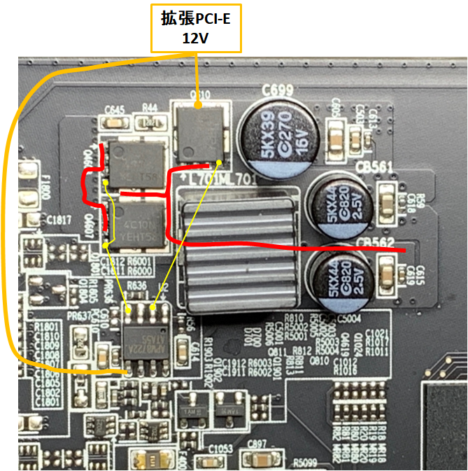

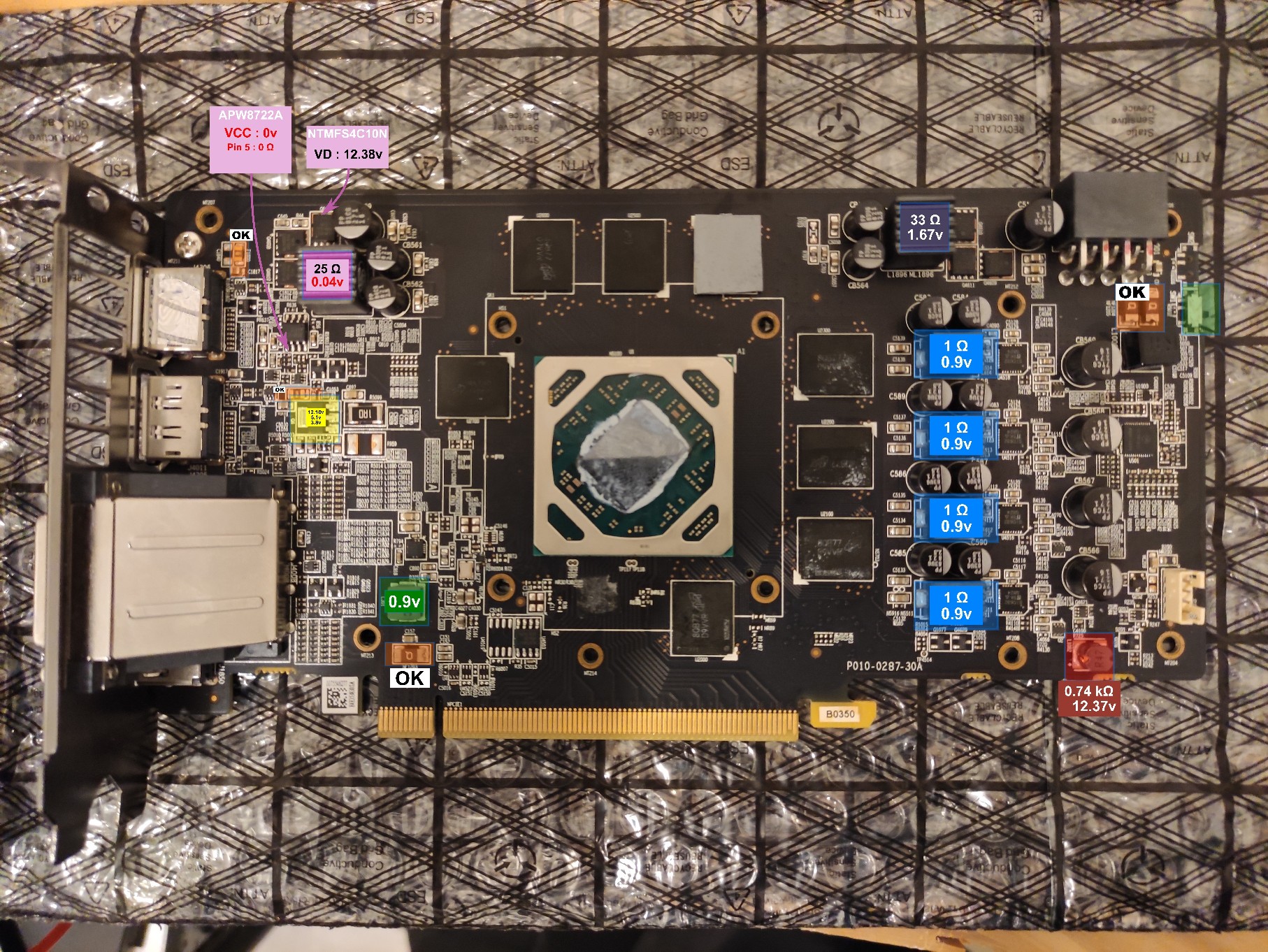

    Hi everyone,
    I've got a rx580 Sapphire Pulse stopped working while I was playing a game.
    Since then, when I turn on my computer, the fans are spinning but the card is not recognized (no display neither). The GPU core is heating when turned on. I'm a noob in electronic and I followed some youtube stuff but no luck for now.
    I wrote down what I found (see the pictures) and I got a strange behavior on the APW8722A, on the top left. The VCC pin (the 5th) has 0V and 0 Ohm when the card is powered up.
    According to the APW8722A datasheet, from a second APW8722A found at the rear on the board and from a japanese guy (from this site : https://nekosoftpc.blogspot.com/2019...-rx470-8g.html and see the picture too), I should have found 12V.
    I thought that the IC was faulty so I removed it. But when I re-measured the voltage and the resistance (without the chip) and I still got : 0V and 0 Ohm. I ordered another APW8722A but now I'm pretty sure that it's a short before this chip...
    Since I cannot find any RX470/RX480/RX570/RX580 Sapphire schematics, I don't know what to do next...
    Can someone help me further with my diagnosis?
    Thank you very much (in advance) !

    Re: Need help to repair a RX580 Sapphire Pulse
    Hello
    Effectively it would come from higher up before this regulator but without a diagram it is always more complex =S
    However the 5V arrives well at the transistor level which is supplied in 12 V.

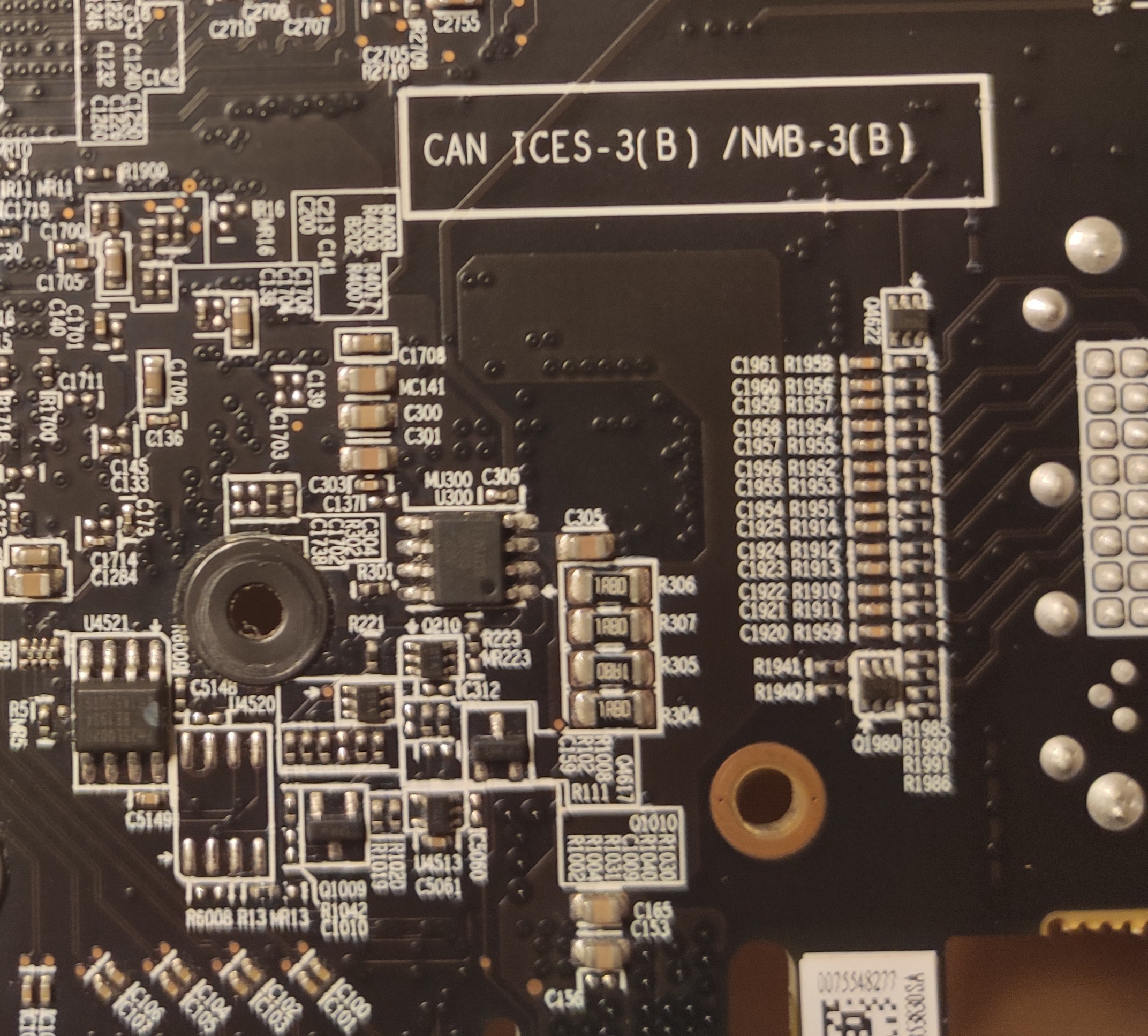

            Hi there,
            Thanks for your message. Well, I'd like to tell you what measuring points I need but I don't
            Simply because I don't what to do with these measures
            That's why I asked some guidance here. But I appreciate your help

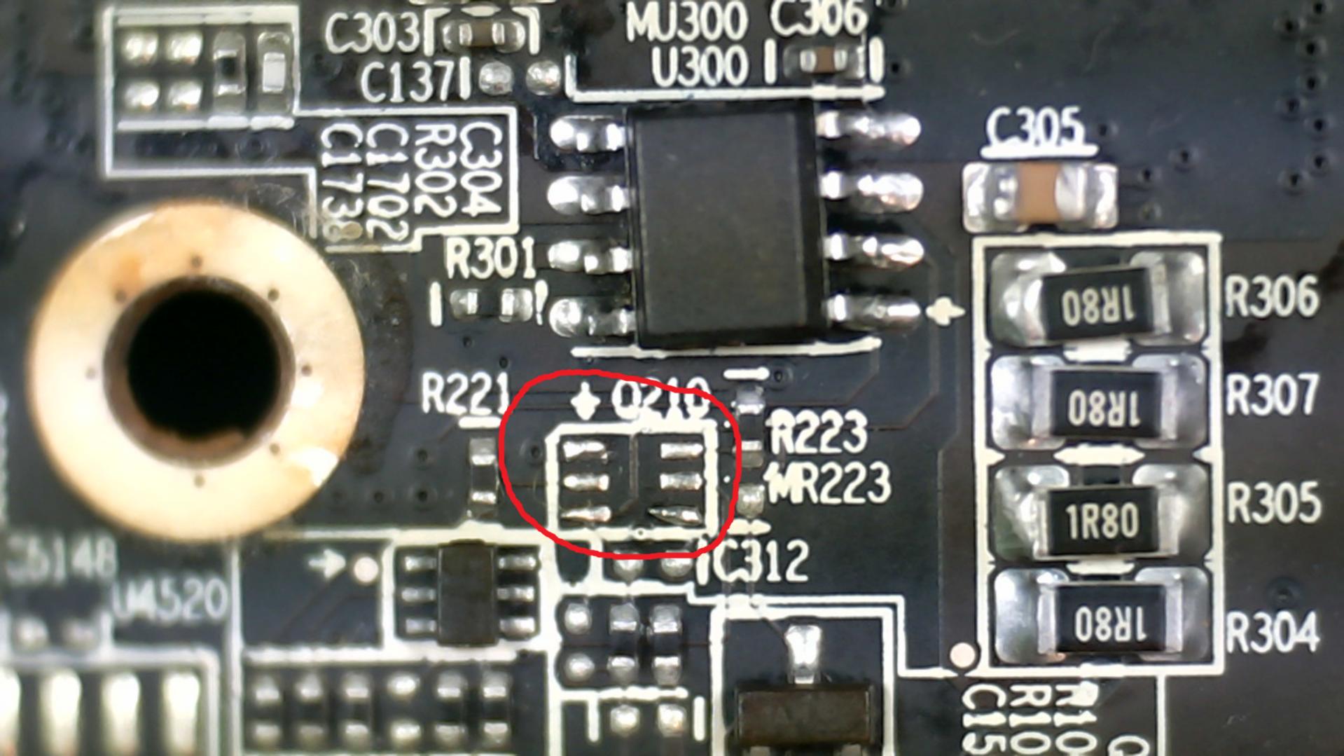

            For your missing part, here is a picture of the zone (sorry the picture was taken with my phone)
            Just fyi, the U300 is a GS7103 and the Q210's name is : S1A. After searching it, I found the ref in a russian forum (I can send you the link if you want) and it seems that the S1A is interchangeable with the K6N. The model they bought (and worked at the end) is this one : aliexpress
            Here is the Datasheet
            The package used on our cards is : SOT-363

              Thanks a lot MENGPO, very apreciated, if you can please send me the link to the russian page, my google translator is very good at russian,
              Thanks again, I hope to continue repairing that card and if I do, maybe I can help more with yours.
              It was the first GPU that I tried to repair and since I lost the component, I let it there just getting dust, so maybe now I have learned some more, I can try to fix it.

                Indeed, if this little mosfet is missing, we'll have to see what happens afterwards and I hope that the power has not been turned on despite everything?
                So the part in question is on order?

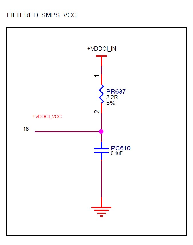

                  Hi fab13,
                  I finally found out what was wrong in the card. I'm joining two schematics extracts you gave me (the MSI one).
                  The pin 5 of the U2 chip was at 0V. As I previously said, I though (wrongly) that the responsible of this was the U2 itself. After remove it, the pin 5 was still directly to the ground when I powered up the card (short notice : as Erminba said, don't do this it could fry memory controller). So I bought another APW8722A, put it in place and I tested the other components from the +VDDCI_VCC line.
                  The PC610 condensator was the faulty one (smallest component I've seen in my life). I replaced it by another condensator (same characteristics : 100nF / 16V) and I got 6V at the pin 5. Again it was problematic since I was expected 12V. I continued my investigation and I also found out that the PR637 seemed damaged. I removed it and tested it and I measured 100 ohms instead of 2.2 ohms.
                  Finally I changed everything once again with "stronger" components : PR637 (2.2ohms 1% 125mW), PC610 (100nF 25V) and also the C610 (100nf 25V)
                  And now, my card is working again
                  I've got some temperature issue but I think the heater does not touch perfectly the GPU core... But it's for another day
                  Thanks again fab13 for the schematics and your help !
                    Wow that's great really that's what it seemed to me a resistance Hs in the lot or low value as you indicated which is not normal My diagnosis seemed good I imagine I'm happy for you that it works again as on the first day and if we can help each other between technicians. And then with diagram it is always easier. Small question how was resistance physically? If we can help with a next card that would be cool. For the GPU heating problem at this level I don't really know
                      Hi fab13,
                      Thanks again for your help ! The resistance seemed a bit burnt on the side but nothing bad (no strong decoloration or no deformation here). ... That's why I did not decide to change it at first, but I guess I was wrong...
                      Since the value of this resistance is very low, maybe any damage (even the smallest) can change it... I don't know, my knowledge here is very poor...

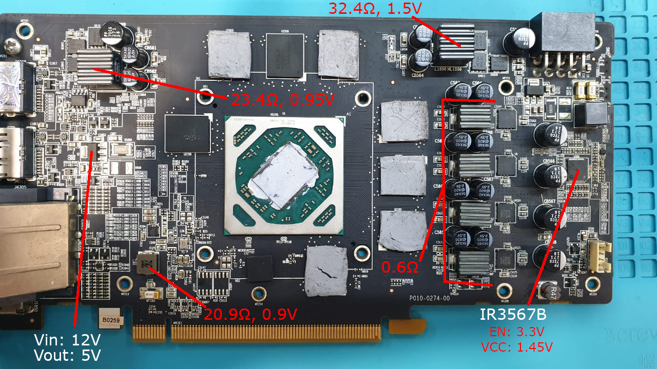

                        Hi, I have a similar card but no voltage on core. I hope someone here can guide me on what should I check.

                          Well according to the schematic IR3567B VCC comes direct from +3.3V_BUS (PCIe edge connector), so I'd check that for shorts or find out why it isn't 3V3
                          You should probably start a new thread rather than hijack someone elses...

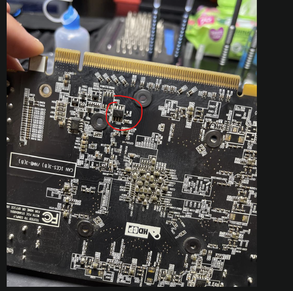

                            Hi. I'm trying to repair Sapphire Pusle Radeon RX 580 8gb and I would like to share a photo of the card area with U300 and Q210 elements, maybe it will be useful to someone.

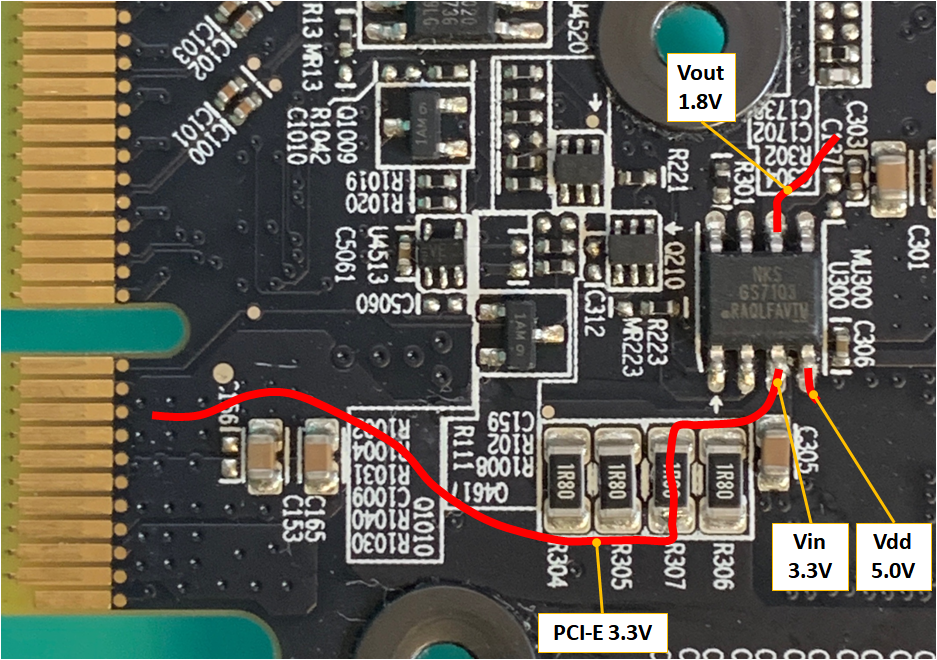

                                  Hello, I get these voltages on the GS7103. I'm not sure where to go from there. Should I just replace it?
                                  Thanks...
