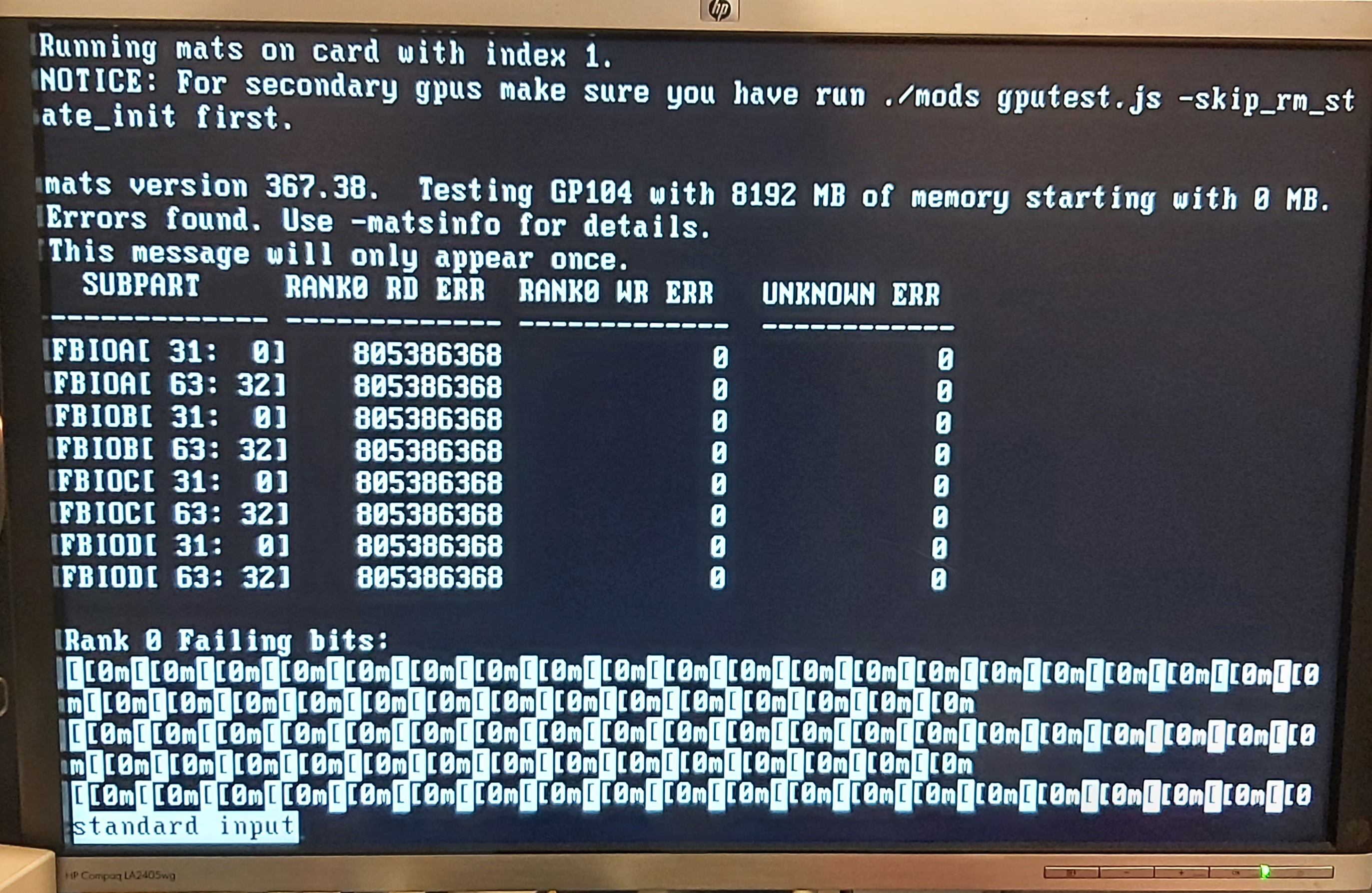

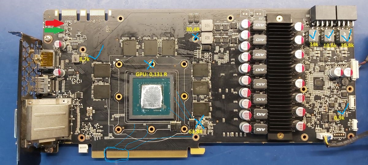

    Hi all
    I have a non-working ZOTAC GTX1070 card with 8GB RAM. No Video output, PC crashes immediately after Windows loads the NVIDIA driver and card is shown correctly identified in Device Manager. Another motherboard didn't even manage to start booting Windows and was stuck on VGA check.
    I have tested the the whole RAM of the card with MATS, and it shows 100% read errors on all chips, but no write errors (picture attached).
    Also one memory chip I had to solder on the card, because it was missing, so at least this one memory chip must be working (Micron D9TCB).
    It can't believe that all memory chips are broken the same way including the new one. Can anybody say what this means, is it a corrupt memory controller in the GPU, or is it possible that one common line eg. an write enable for all chips is broken somewhere between the GPU chip and the memory chips ?
    Does it make sense to reball the GPU and solder back on the board, or must the GPU be replaced ?
    Thanks in advance for any hint.

      Re: ZOTAC GTX1070 8GB - Read Errors on all DDR5 chips
      regarding Mods/Mats I believe that the configuration is OK, as another working GTX1070 is passign all the tests w/o a problem.
      I have tested the card both with versions 367.38.1, 400.184 with following commands (as second card, IGPU is first):
      1. ./mods gputest.js -skip_rm_state_init -mfg
      2. ./mats -n 1 -e 20 |less
      The reports are attached, but v400 does not go at all.
      I have asked also about it on another local polish forum, and the conclusion there is that the most probably memory controller of the GPU is corrupt due to the low resistances measured.
      BTW, the GPU resistance seems to be very low, but it is measured with a very precise low resistance unit working with 4 cables, so it is able to correct the cable resistance problem when measuring very low resistances. This resistance seems to be OK, beacuse I usually get such resistances on GP104-200-A1 GPU's (usually 0.13 R, sometime up to 0,2 R if luck in silicon lottery - I observed that these chips with higher resistance are usually better to overclock and consume less power). I have attached a picture of the board with resistance measurements.
      I have also another Gigabyte GTX1070 card with exactly same problem. Only the detailled report data is different, but also read errors on all chips. On this another card I also testwise desoldered all the DDR5 chips, and tested the card again, the result is completely the same as if with DDR5 chips were on the card.
      Pls let me know what do you think ?
      BTW do you maybe know what resistance a single desordered DDR5 chip shoud have on power supply (1,5V). I measured a few desoldered ones, and get ca 120 kohms , on different chips which I marked bad (don't remeber why), I measured 20-70 ohms ? I look for a way how to check the DDR5 chips one by one ?
      Regards

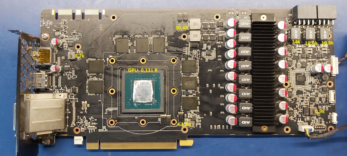

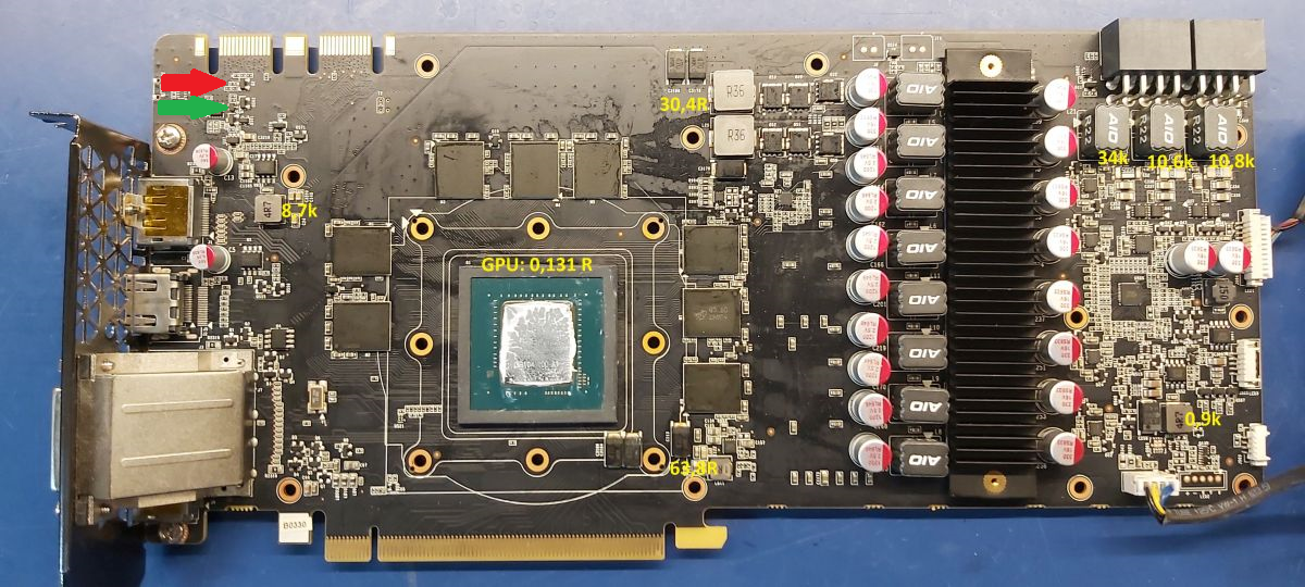

        Hello and good to hear back! As I mentioned, you may be able to help me as well so I'll add info for you and then maybe you can ID two components in the photo (red and green arrow, red a resistor and green a 3-leg transistor).
        Anyway, some info for you
        So, all measurements are fine except GPU, RAM and PEX. I marked with "X" in the photo which are bad.
        A 10-series GPU should have a resistance of about 1ohm, in my experience.
        The Micron GDDR5 should have about 60-90ohm. Samsung is usually about 30-45ohm. Anything higher or lower is usually bad +/- 5%.
        The PEX rail should be about 90ohm. 60 is not necessarily bad but should be considered a potential failure. Anything below 50ohm on PEX is a definite problem.
        As for measurements, I've added an area for you to check in diode mode on the PCIE slot. Measure the first 10 pins (those I circled). These lead straight to GPU/PEX and often denote a bad GPU memory controller (which I believe is the problem). Red probe on ground, black probe on pins, Your measurements should be something like this:
        OL , GROUND , .460+ , .460+ , GROUND, OL , GROUND , .460+ , .460+ , GROUND
        ground will show as .000-.002 volts.
        Let me know what you get back as I think your issue is a bad GPU memory controller but there is a small chance you just have a bad PEX rail.
        The other card you mentioned it 99% the GPU memory controller being bad. If all RAM removed gives same result it's the GPU, sadly.
        On helping me, could you give me a resistance measurement of the resistor marked with the red arrow and photo or label of what is on the 3-leg transistor marked with the green arrow? I just need to know what numbers/letters are printed on it.
        Thanks, good luck and let me know!

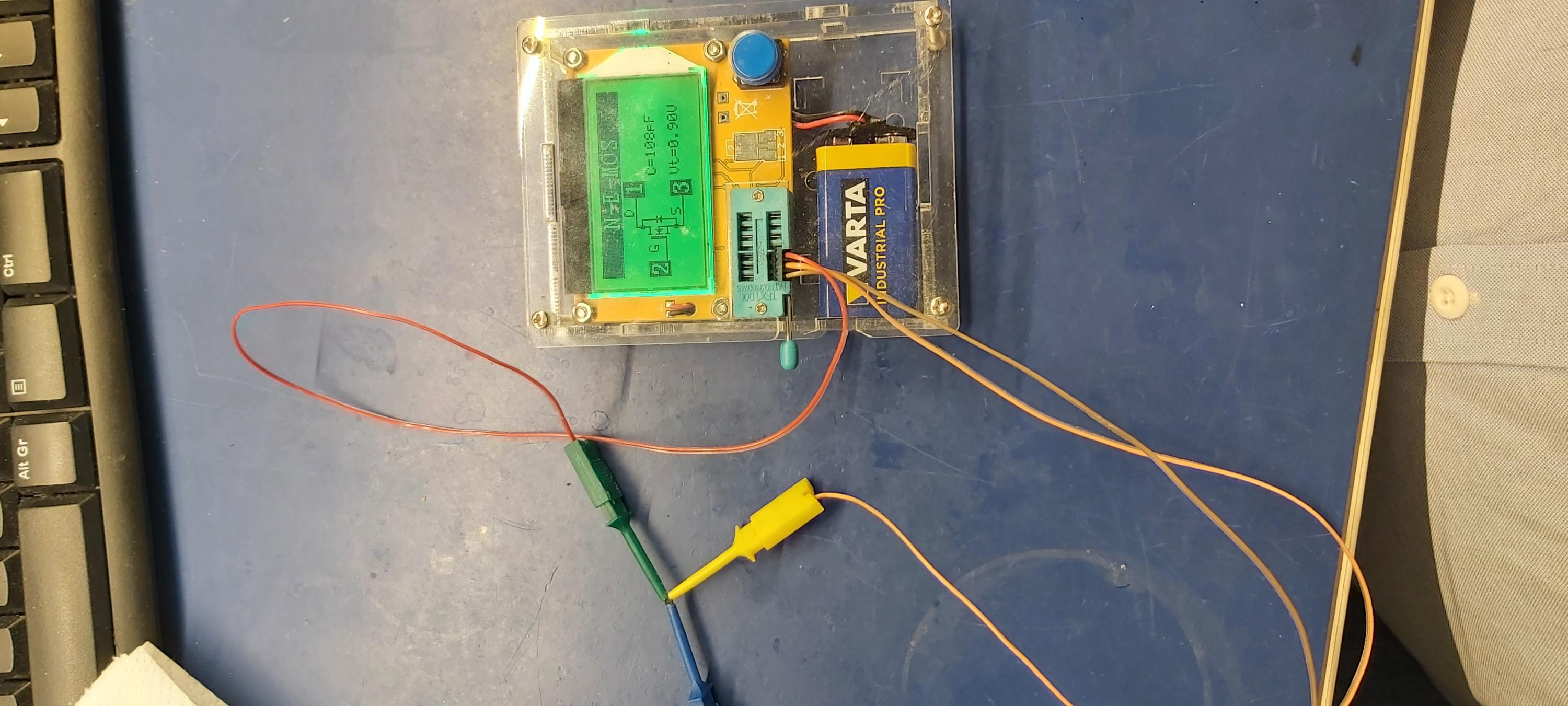

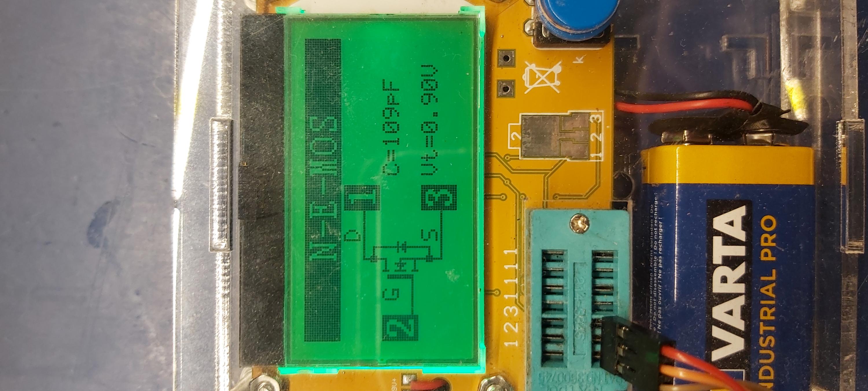

          Regarding the componets:
          1. The resistor is a 10kohm resistor, I measured it in circuit in both directions, and it shows the same, so should be the correct value
          2. The transistor has the marking "C", i have desoldered it and tested with a nice device, it shows it is a N-E-MOSFET, pls find attached two pictures from the test. The cables are 1 - blue, 2 - yellow and 3 green (probably, as I am slightly color blind, nethertheless the last one). You can see the transistor on the picture clamped with pins down as on the PCB, on one side blue (the side with the single pin), and on the other side yellow and green.
          I hope this will help you. Let me know should you need more help.
          Regarding the CPU from the card I have just desoldered it, before reading your answer, and after desoldering I have the following readings on the card:
          RAM_FBVDD 42,7 ohm
          PEX_16,6 kohm
          Rest did not change
          So it looks like the RAM's are definitely broken, at least some another ones of them.
                Originally posted by DynaxSC
                OK. Thanks for reply, pls note I have edited my previous post with some additional information. BTW, should you need a Gigabyte GTX 1070 boardview, I can send you one, just give me your pm.
                Yes, I use a basic Fluke so if you have very precise measurement tools I'd say it's entirely possible the resistance of the chip *is* good. I consider 1ohm but I do have to account for my instruments likely not being as precise as yours. I agree with you there.
                Also, based on the new measurements after you removed the CPU itself, it does seen possible that it is good and it was a rare case of massive RAM failures!
                Yeah, a boardview of that card would be great. Just click my name and choose to send a private message. I think that should work.
                    Hi, I just removed one RAM, and only the one I have soldered in the beginnig on the card in the missing place. I turns out, that just this spare RAM is broken, as the resistance after desoldering went high over 260 ohms. It seems I assumed my spare RAM is good, but it was not. How stupid one must be not to check this before soldering the part on the card, and then desoldering also the GPU. Lessons learned.
                    However I need still to reball and resolder the GPU back on the card. Probably during the weekend. I'm very curious what will be the result.
                    I also suspect, that my Mods/Mats image is still somewhat wrong. I have read on some russian site, that people had similar problems with the image and did correct something. But I do not have time now to make a dissertation on Linux. I will just try the easy way, and if it will not work, then I will try to see how to get this corrected image from the russian site - probably I must register there, but my Russian is no good.

                                      Hi Folks
                                      I exchanged the borken RAM, reballed and resolderred the GPU on the card, and voila, the card works again. I assembled it back toghether and do a load test now with Furmark, but it seams everything is OK for now.
                                      So this means, the guy who sold the card was not lying, it was only the one RAM, but I was too stupid to make it right . But It's really difficult to trust these sellers, as they usually do not tell the whole trough, ar even lie, but this time I had luck.
                                      This also means my Mods/Mats image does work correctly only if the card is OK, when RAM is broken it does not do its job and shows rubbish.
                                      If you could tell me where I can downlod the images you wrote about, I'd appreciate that. I'm not and linux expert at all.
