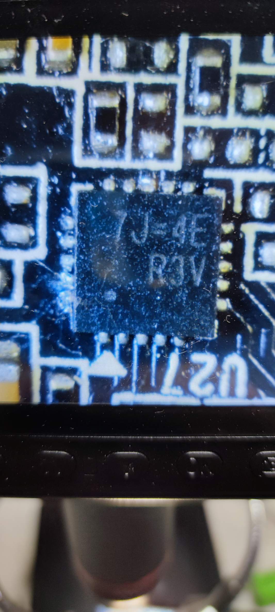

    1070ti Identify Component 7J=4E R3V
    I have a Zotac 1070ti, it has main voltage rails, 5v, but nothing on memory rails, mosfets have no input, possibly to do with this chip? on the other side of the board but i can't find any info about it, it has 12v in the area around it, some caps also have no voltage around it.
    20 pin 7J=4E R3V
    • 21857
    Re: 1070ti Identify Component 7J=4E R3V
    Its a Richtek RT8816A
