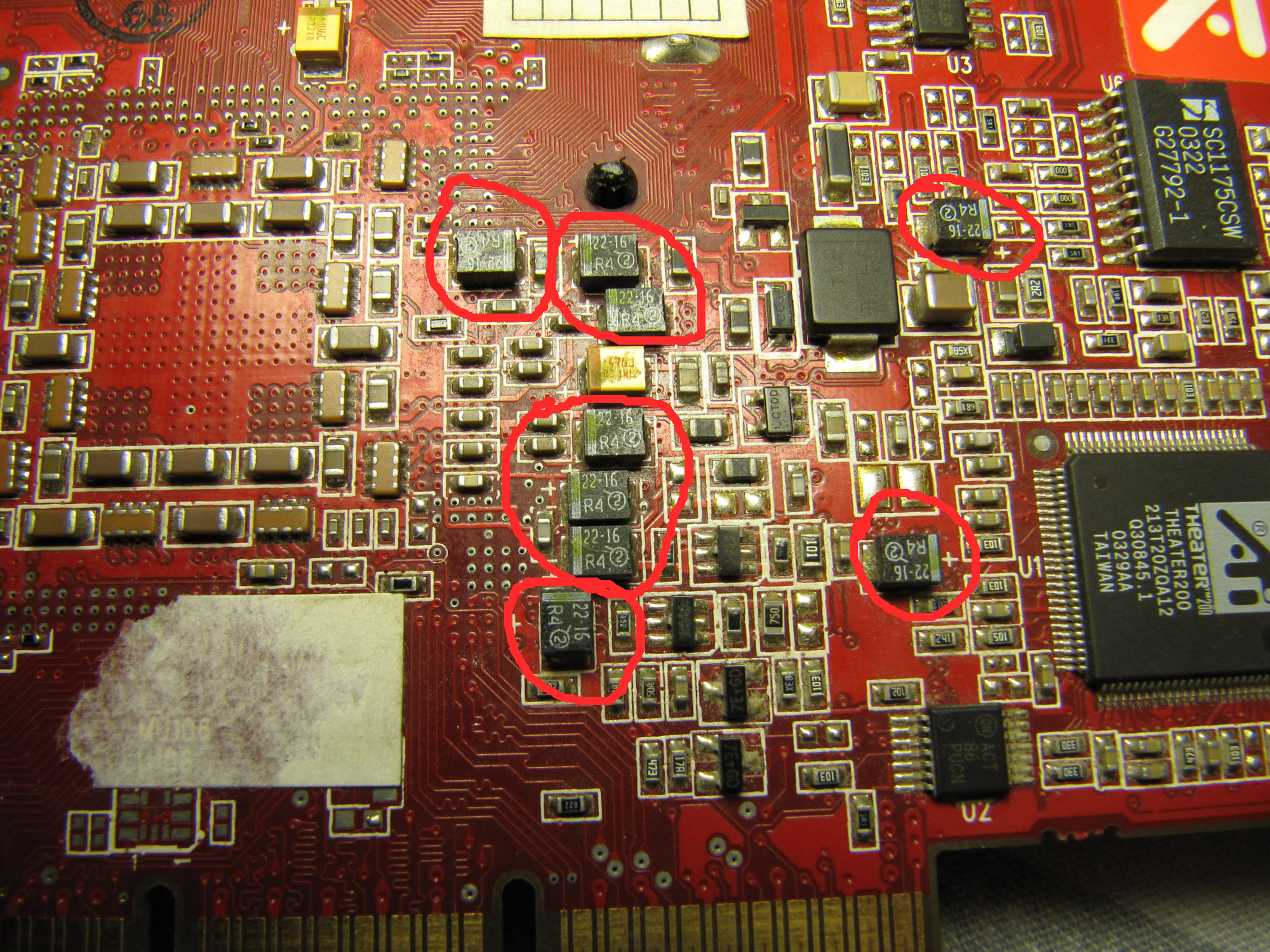

    What is this part?
    what is the part in the red circles?
    The card is an Ati All In Wonder 9800 SE
    • 31248
    Re: What is this part?
    tantalum capacitors - same as the yellow ones.
    22uf 16v

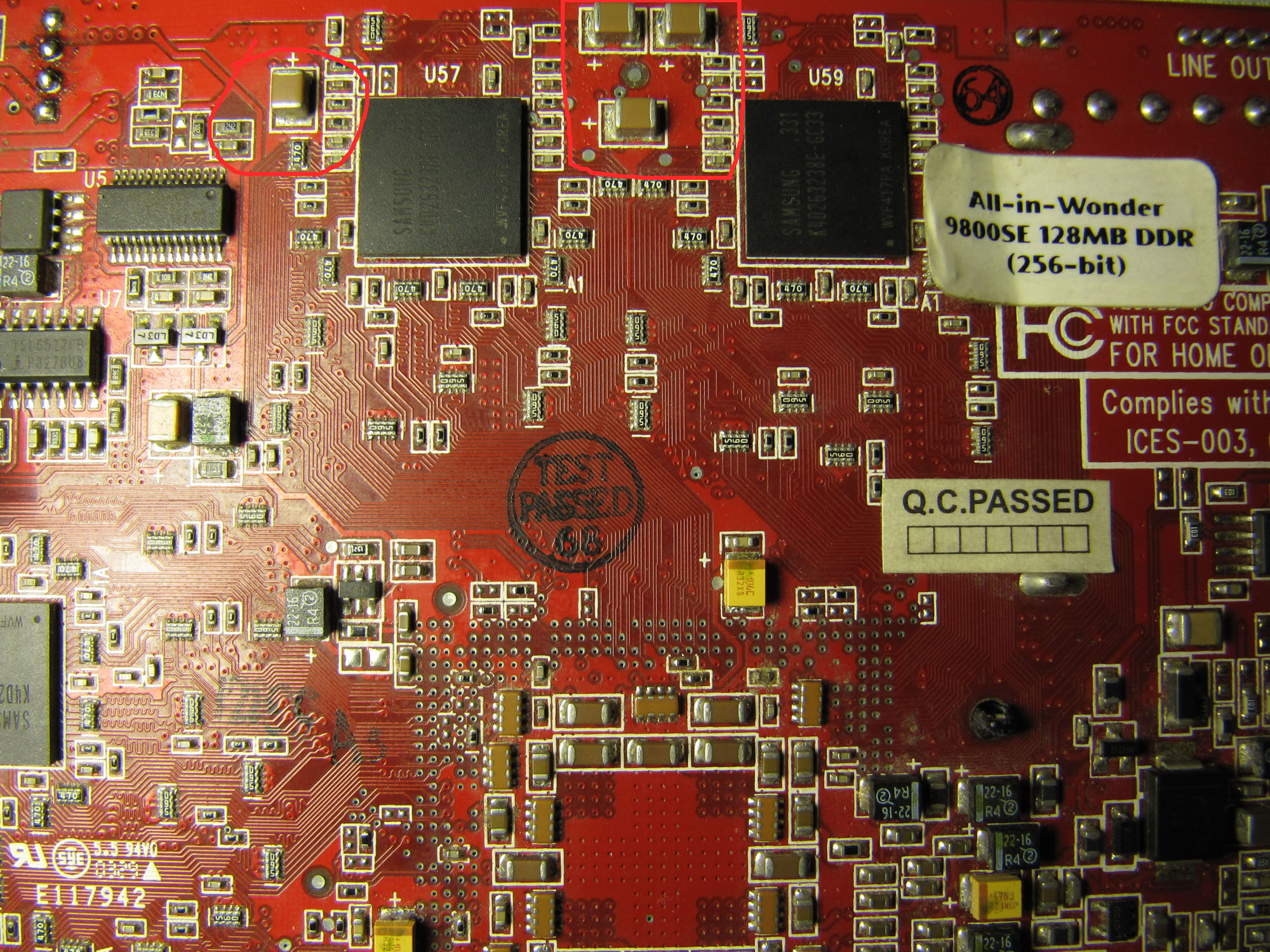

      Thanx! I didn't know anything about that capacitor type.
      May I ask one more question?
      The parts spotted in the photo are tantalum capacitors too?
        • 31248
        those are ceramic capacitors.
        and forget the "+" on the board - they go in either way.
