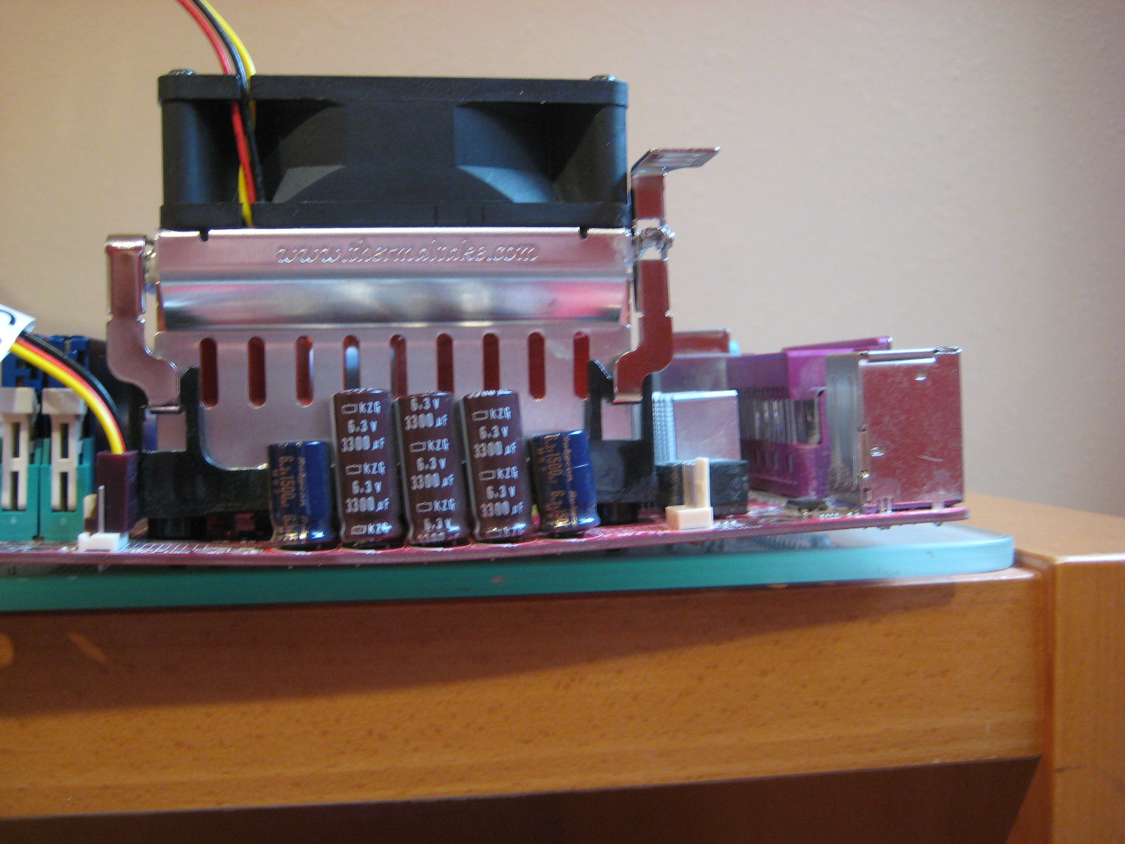

    anyway, I got this motherboard used,It came with a P4 1.8 cpu @400MHz and it works great everything seems fine,but when I upgrade to a 2.8 cpu @ 800 MHz it won't post.I've tried everything I can think of.even bought a new 600 watt PSU.there are a row of 5 caps along the cpu, 3 are the KZG 3,300uf 6.3v that I've been reading about on this board, one has a little bulg.that's why I think it's somethink electrical.any thoughts or ideals would be welcome because I would like to get it fixed and I'm not interested in doing it myself.

        the one on the left is the suspected cap (KZG)

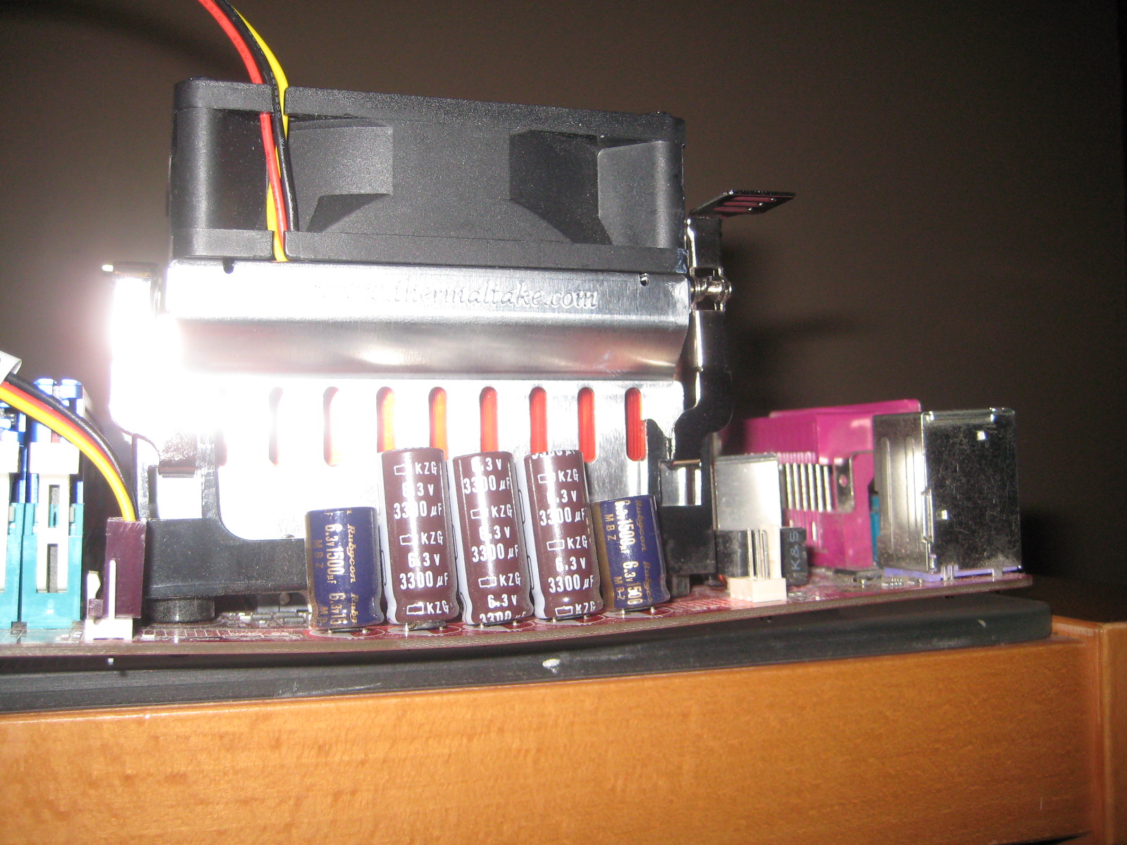

          • sedlik
            • 13
            Re: MSI PM8M-V 7104 won' post after cpu upgrade
            this is it
              • 31248
              that's bad i think - i'd change the set together.

                  • 31248
                  it actually looks like the bung may be coming out of the base.

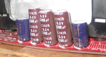

                    • sedlik
                      • 13
                      is this better?
                      • kaniki
                        • 514
                        from those it actually looks like all 3 are starting to blow from the bottom..
                        also, from those pic's i noticed one other thing too.. I would take a good check over that board. I don't know if you noticed or not but that board is warped. It bows down right where the CPU is. last time i checked, motherboards were flat, not bowed.
                        • seanc
                          • Nov 2008
                          • 1319
                          It's probably bowing because of the heatsink. I see it on brand new LGA775 boards all of the time.
                          • shadow
                            • Feb 2007
                            • 732
                            Agree with seanc here. It can also be observed with the older Pentium 4 motherboards...Socket 478. It did seem weird that even a stock heatsink would bow the motherboard until I found out that it was done intentionally.

                                • 1319
                                The failed capacitors cannot handle the extra requirements of the new processor compared to the older one. The fact that it works at all is a bonus, at least you know you're not fighting a lost cause.
                                You need to replace those capacitors, then it should be fine.
