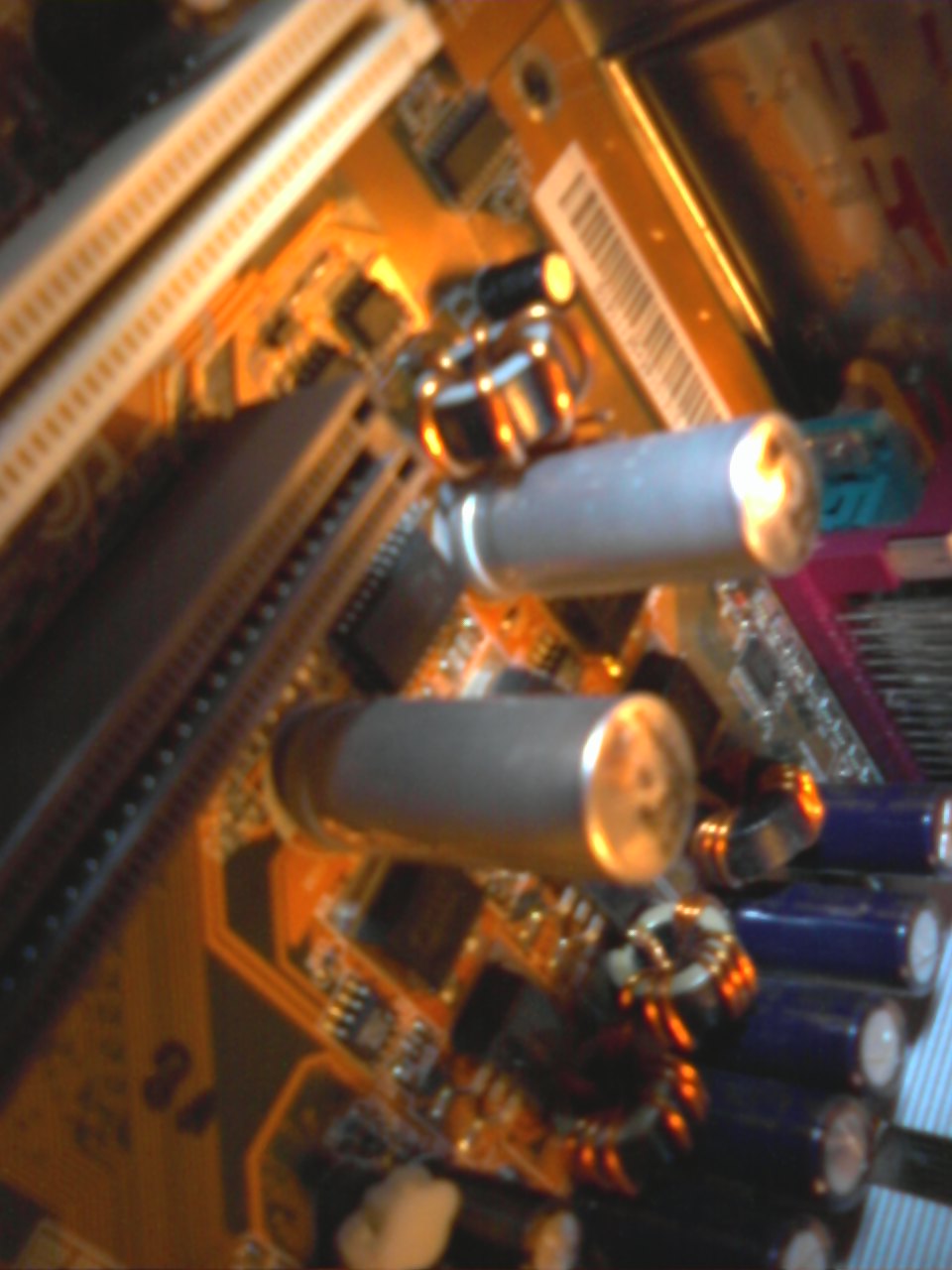

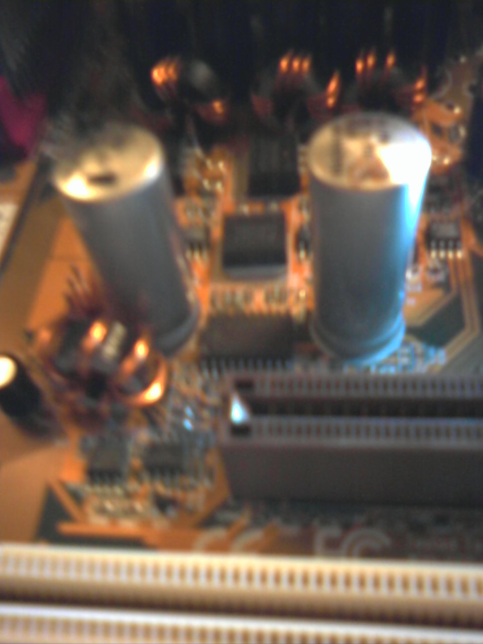

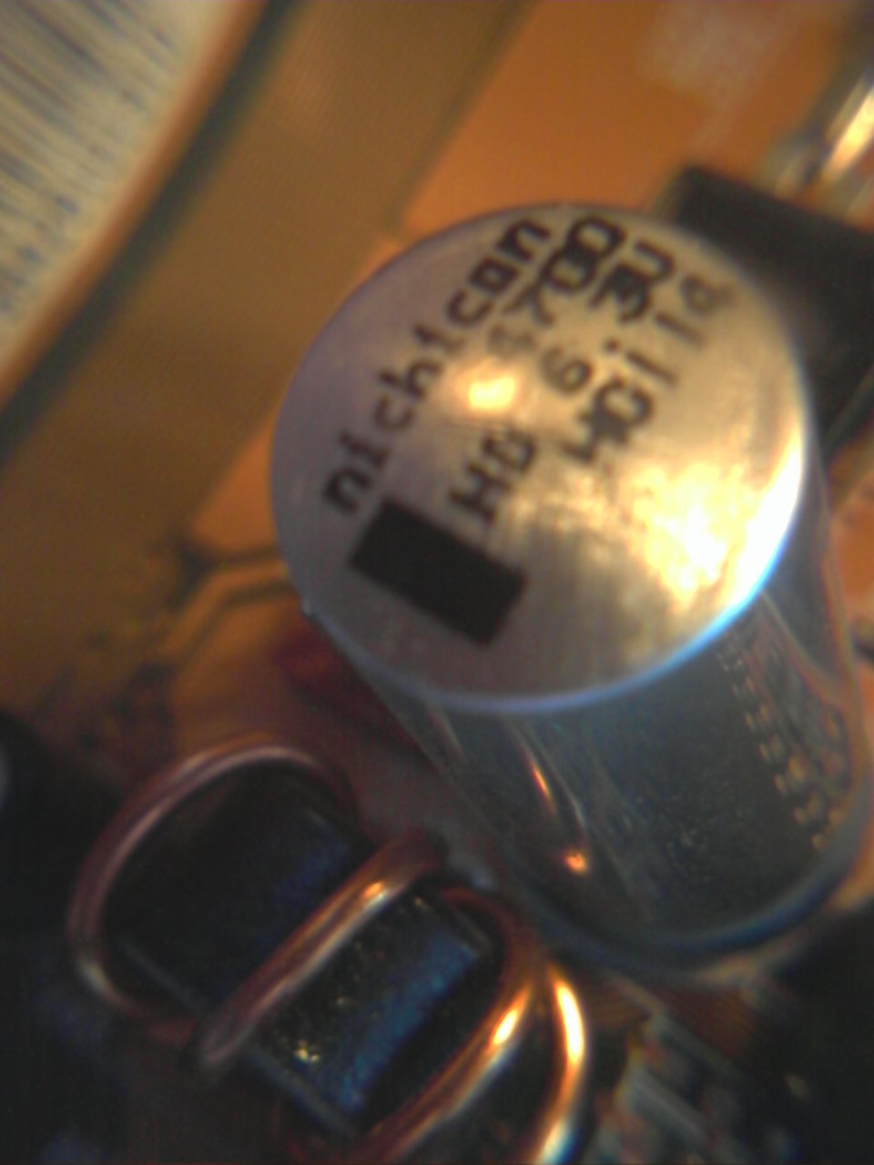

    Hi guys, i just joined, need some help i cant find these caps anywhere or anything close. they are the large silver caps located near the agp socket. the caps poped and oozed out so i asume there goners. so im looking for some replacement caps, they dont have to be exact as far as i've read. thanks

    4700uf 6.3v HD series i suppose.
    nothing speacial other than the diameter maybe - how wide are they?
    http://www.nichicon.co.jp/english/pr...p_catalog.html
    hmmm - cant find HD series.

      Re: Abit KG7 special Caps?
      like he said, you should be able to switch them out with either of these
      https://www.badcaps.net/store/produc...products_id=29
      or
      https://www.badcaps.net/store/produc...products_id=55
      before you order any though, Dont forget to make sure that all the other caps are, or at least look fine so you dont have to putt the board off twice.
        Thanks Guys ill give it a shot
