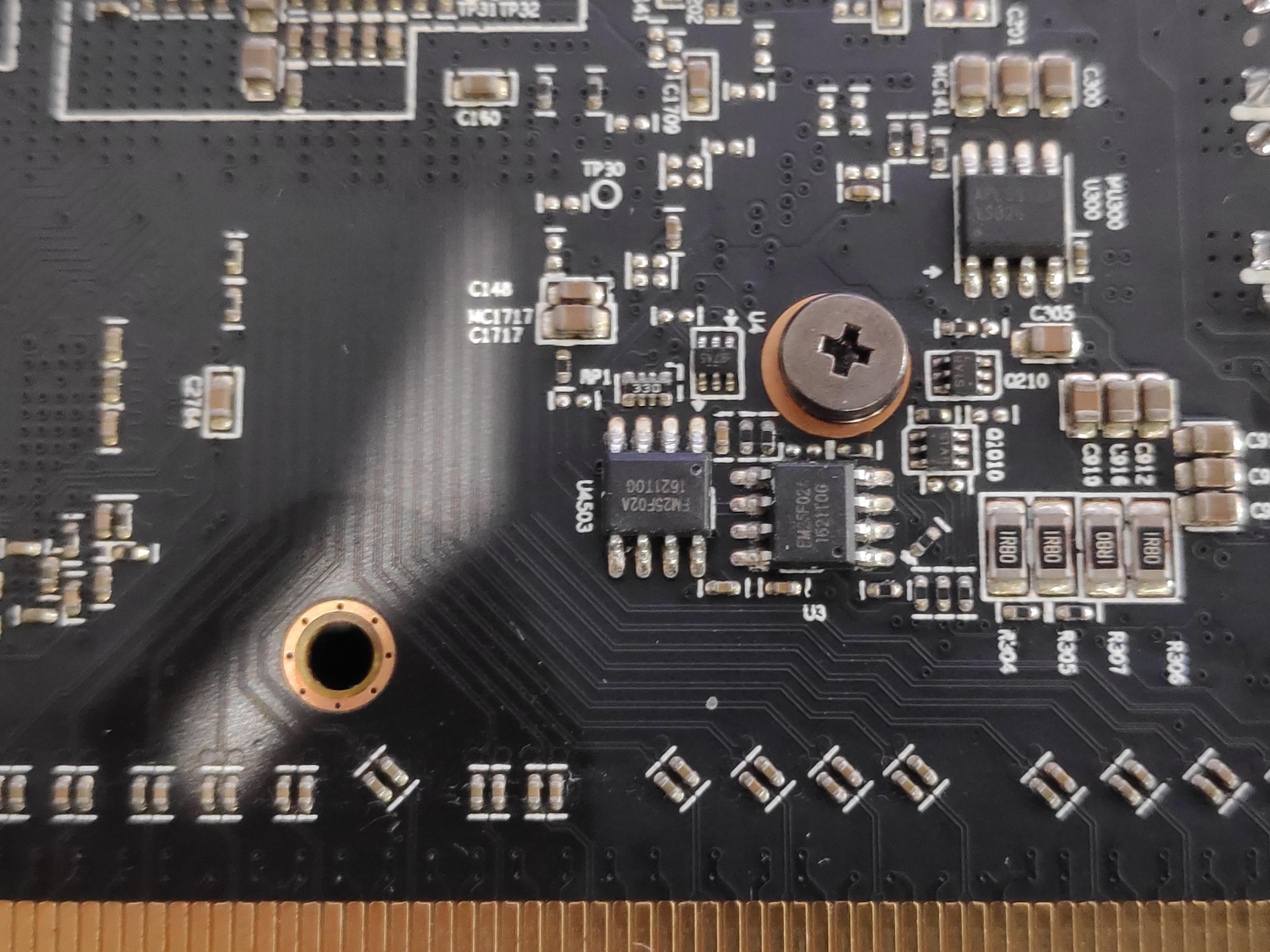

XFX RX 580 8GB GTR Black Edition 8gb OC+ - no display
  • wtracz
    • Dec 2020
    • 4
    • nor
    XFX RX 580 8GB GTR Black Edition 8gb OC+ - no display.
    No short circuits, fuses is OK. Resistance to the ground and voltage like a photos. The card graphics is after the miners.
    I have two IC flash 2x 2xfm25f02a. I reprograming external programmer both 2xfm25f02a this dump
    https://www.techpowerup.com/vgabios/...80-8192-170323
    But still no display. I tested on HDMI and DP
    Best Regards!

    Re: XFX RX 580 8GB GTR Black Edition 8gb OC+ - no display
    Does your computer POST when card is connected?
    Are all voltages present/does the GPU get warm?
    • wtracz
      • Dec 2020
      • 4
      • nor
      Probably not, the buzzer does not make any sounds.
      GPU is warm
      With other GPU card (good), PC is turns on.

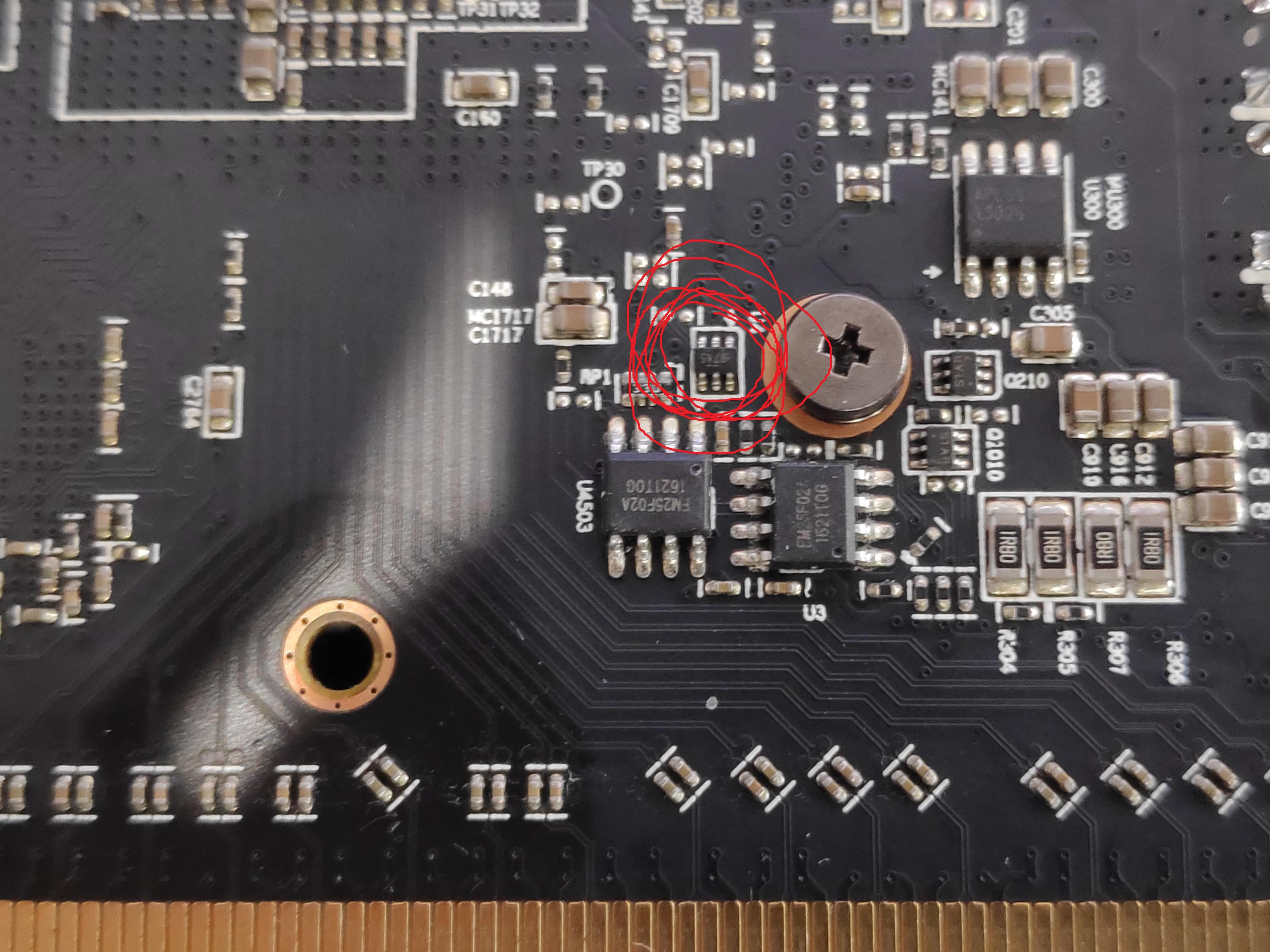

                    hi guys, could somebody help me to identify the component marked in red on this card
                    • mkiani
                      • Aug 2022
                      • Iran
                      I am not sure but I think it is the following IC (LMP8640/-Q1/HV Precision High Voltage Current Sense Amplifier):
                      https://cdn.badcaps-static.com/pdfs/...76ec408034.pdf
                      Check it out.

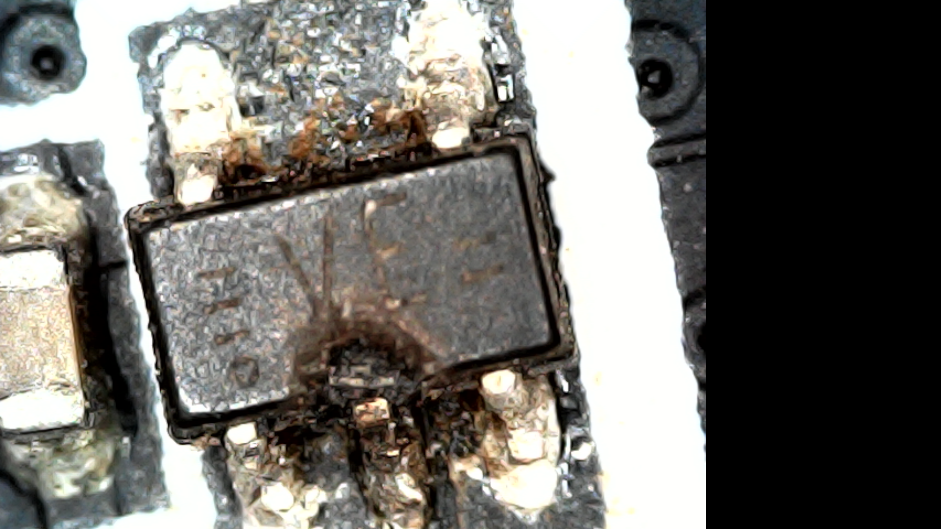

                        Originally posted by frazerxavier
                        It does not get detected as a secondary card. I will check the resistance on PCIE pin A11 in the evening today and post the findings.

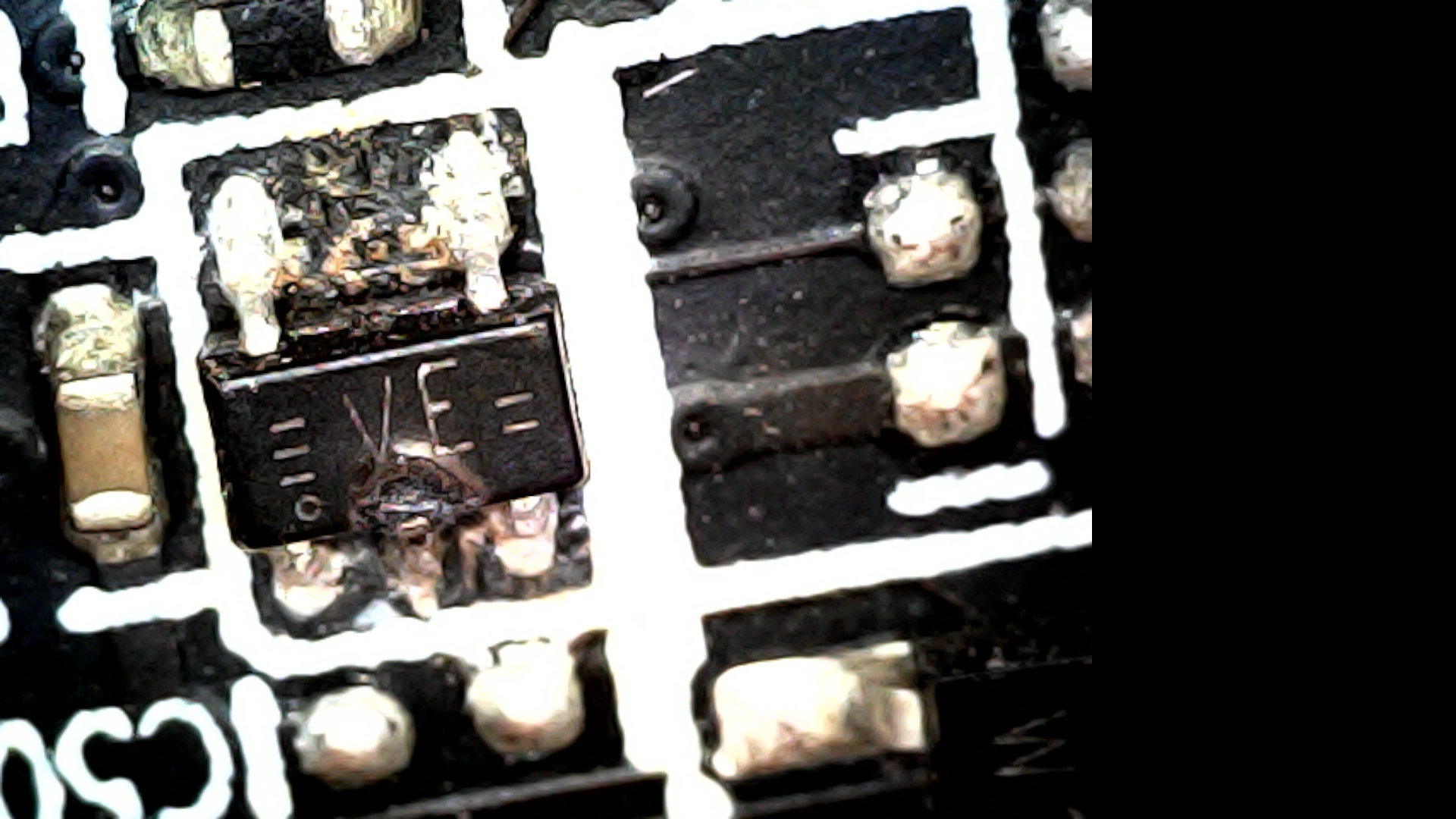

                        If the card is not detected in device manager and you have all voltages, try to change U100 , is this a logic ic marked usualy VE

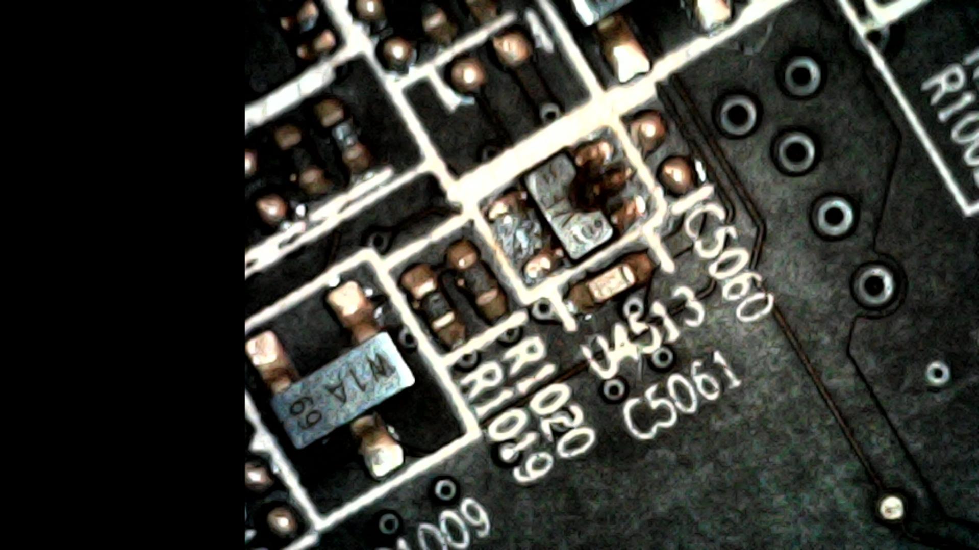

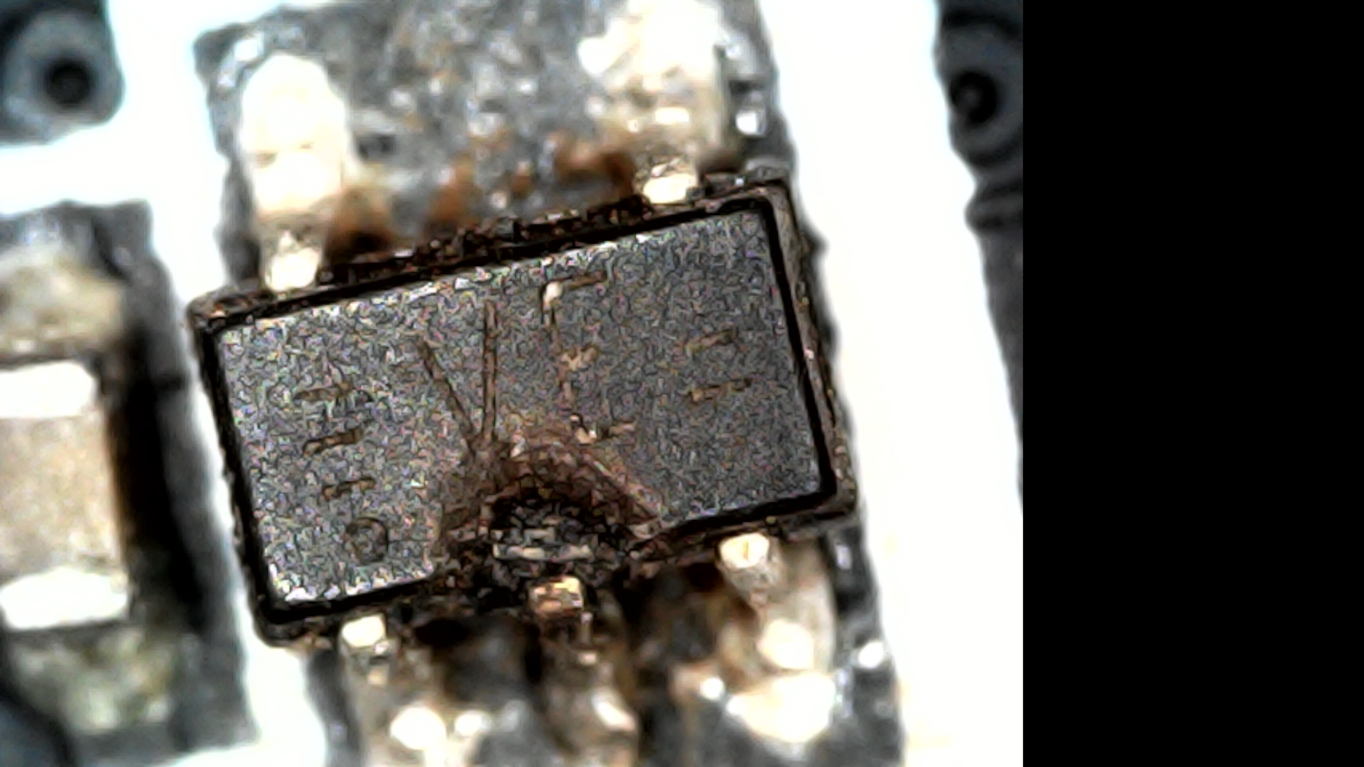

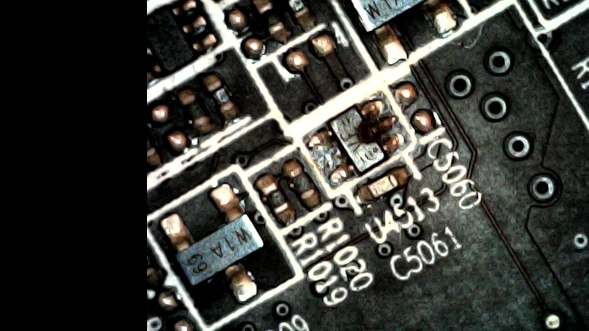

                          Hello i have RX 580 Sapphire Nitro +
                          and instead of U100 i have u4513 and it looks blown any idea how to get a replacement
                          its a 74LVC1G08 with 5 legs it appears on the pictures as "VE"
                          and what can cause that to blow
                            • 31247
                            you can buy single gate logic from all the main suppliers
