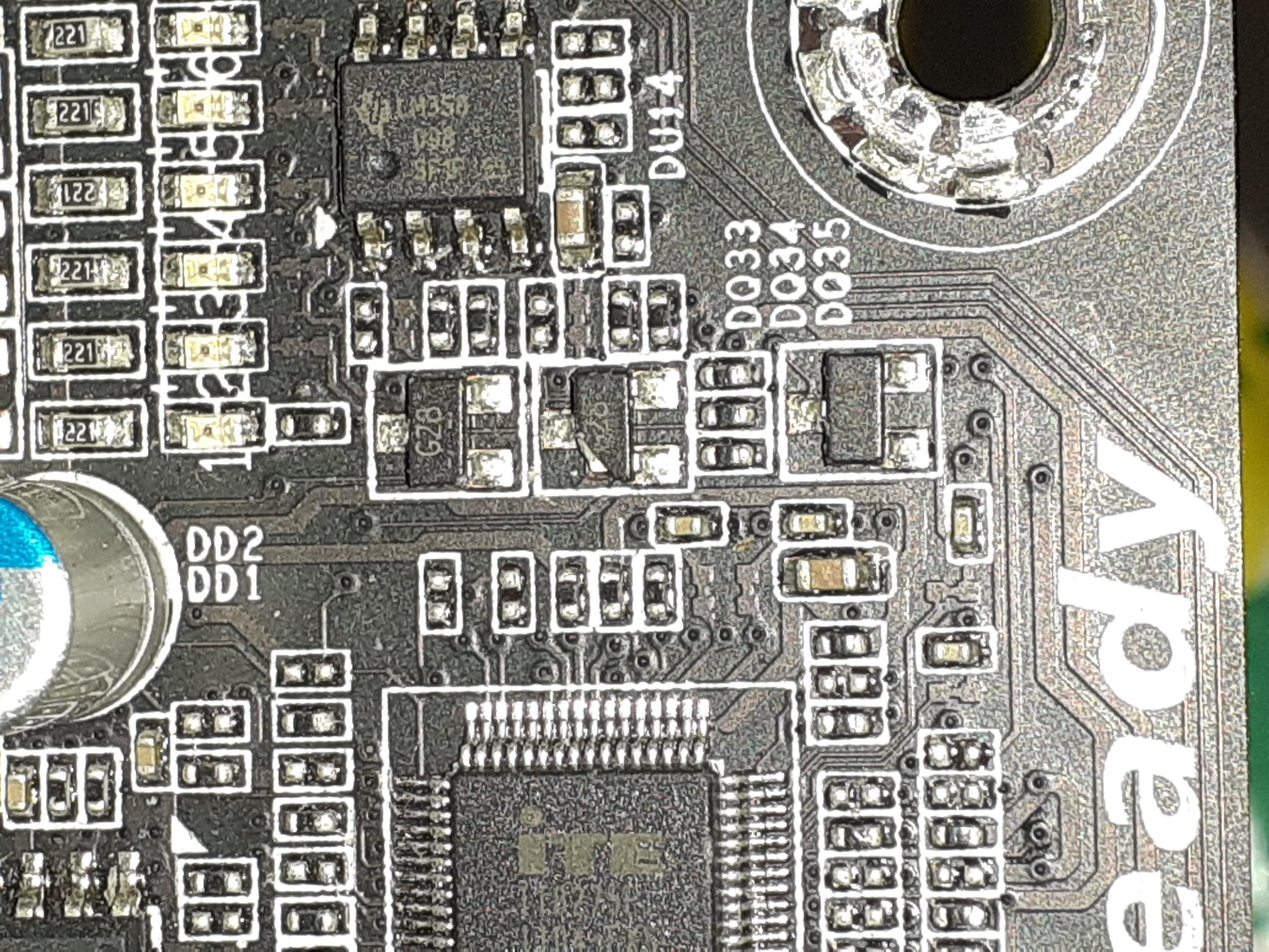

    Hi All,
    This is the second MB I have to repair.
    Given to me for free. I have no history on it.
    It came with an i5 processor and 8Gb RAM. It doesn't boot. The CPU fan LED is inconsistent in its operation.
    All 6 Stage LED's light up.

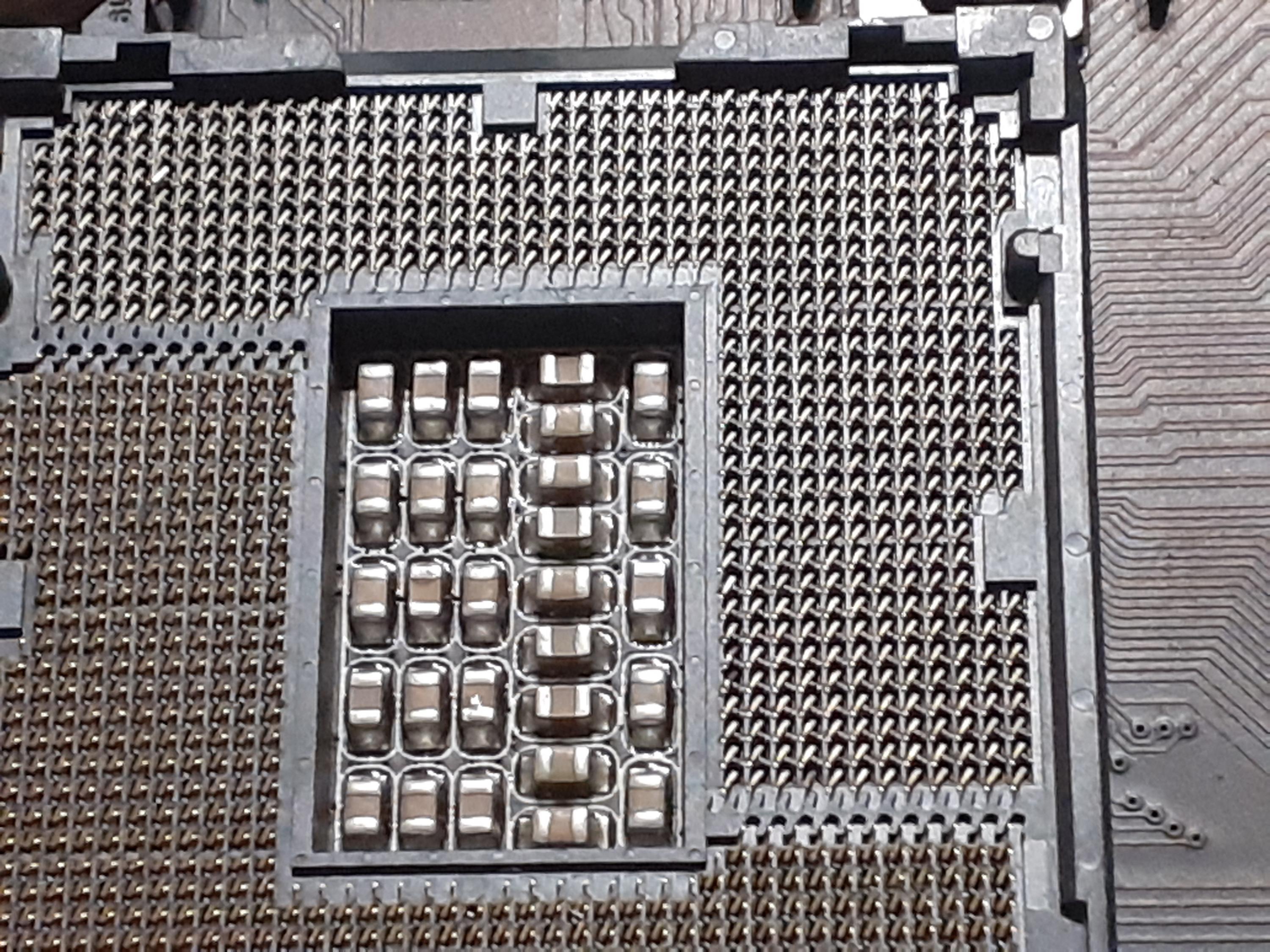

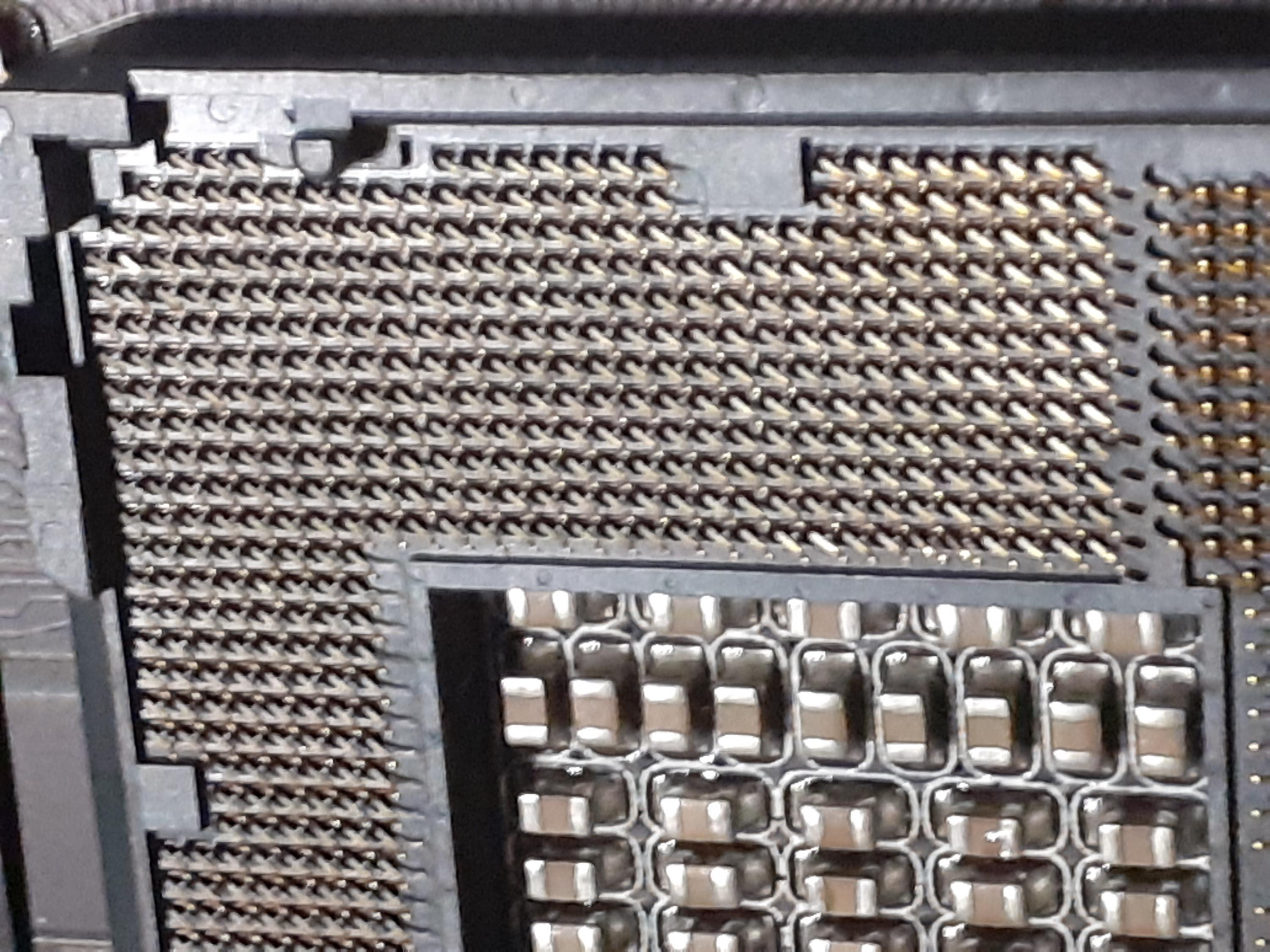

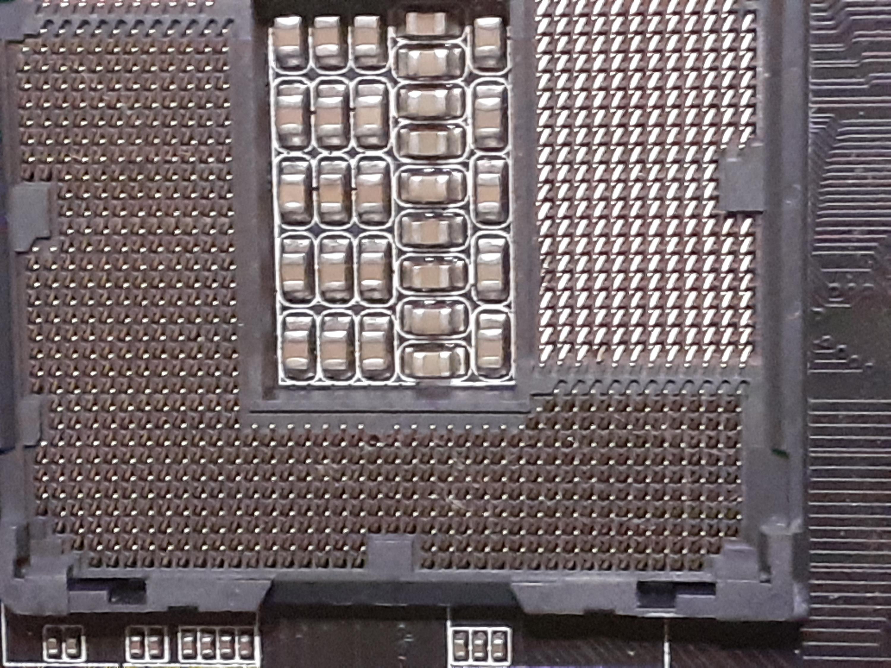

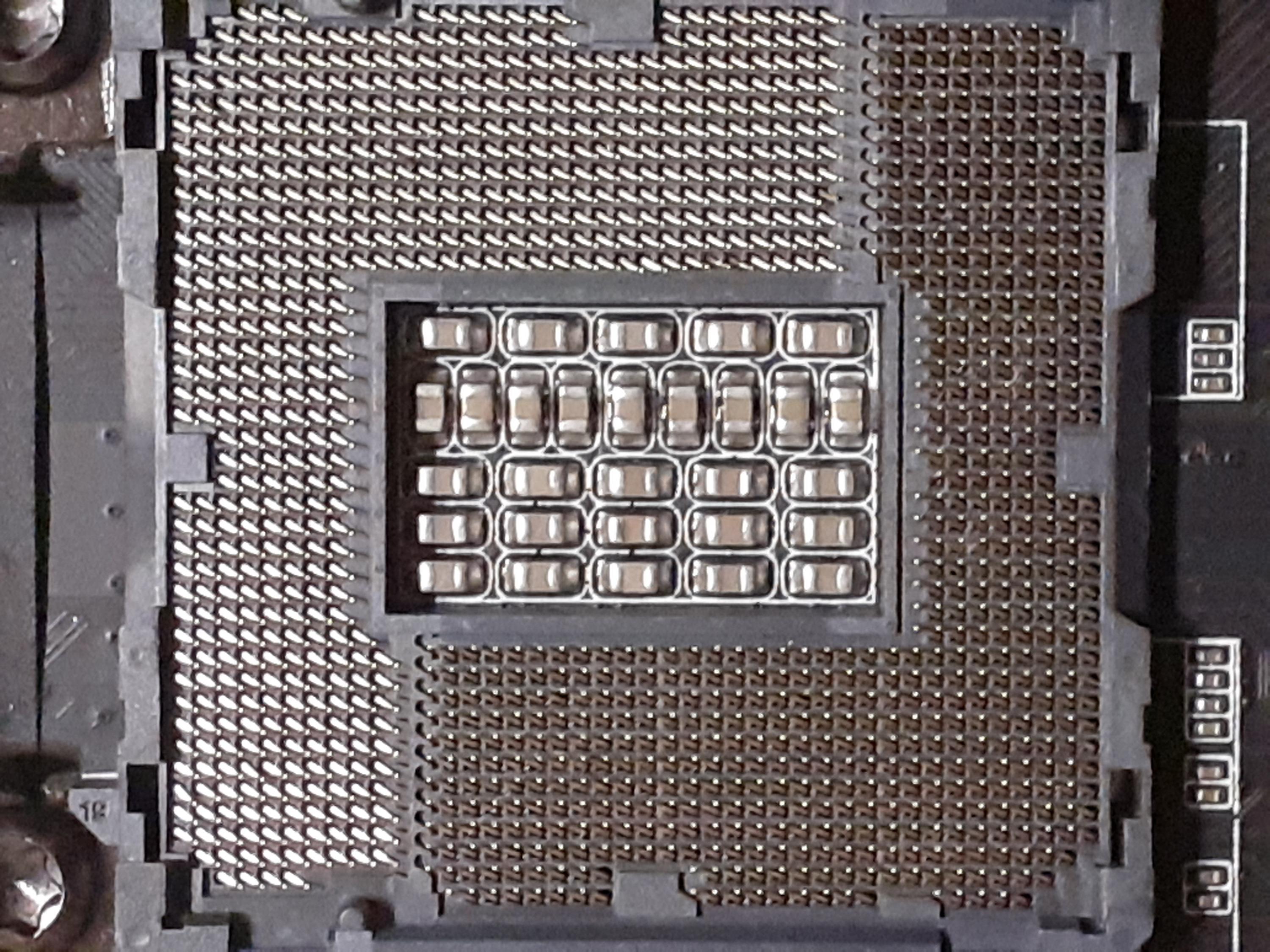

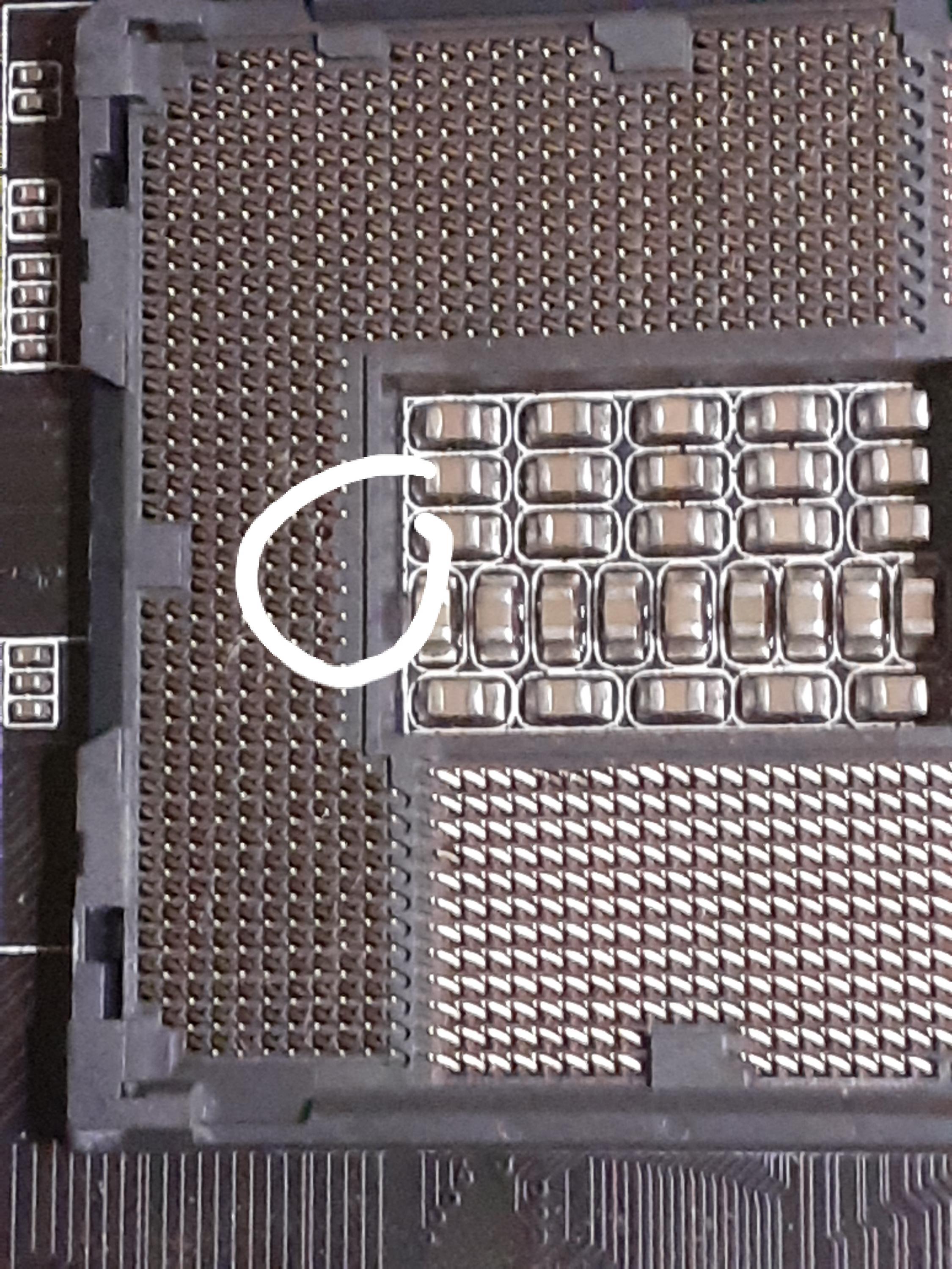

    I examined the CPU socket and there were some bent pins, which I managed to bend CAREFULLY back. I found one had snapped already, but this appears to be a VCC pin, so shouldn't affect operation (so I am advised).
    Pictures attached.
    I haven't checked VCore, VRAM or 3.3V rails yet. All capacitors are high reliability types (not the usual electrolytic types), so fingers crossed!
    I did find DQ34 transistor had some physical damage, but it seems to check out with my tester (it gives the same readings as other identical transistors on the board)
    I haven't got a PCI Port80 tester - yet
    Any thoughts on the socket pins anyone?

    You are correct about a broken Vcore pin, it should't cause a problem. Are you 100% sure that pin is Vcore? Measures resistance from the broken pin to the VRM coils?
    I would be tempted to change that broken transistor - or at the very least unsolder it and test it out of circiut
    I've seen a lot worse LGA sockets than that, which were still working. So the board powers up when you press the ATX power switch, but does not boot? if you then hold in the power button does it shut down? Yepp?

      Are you 100% sure that pin is Vcore? Pretty Sure from the CPU layout diagram I studied.
      Measures resistance from the broken pin to the VRM coils? Not Checked as cannot I get on to the broken pin to check continuity.

        Hmm OK in my not totally vast experience - this type of problem is often a fault with the SIO or more likely the Northbridge (PCH or whatever they like to call it these days) or it could be related to that broken pin in the LGA socket.
        As you can't easily get to the pins around the NB, I would suggest have a look at the pins of the SIO that are related to the sleep states (S3, S5 that sort of signal) and see if it is turning Vcore and the ATX PSU on and off
        The board view file should help here - do you know how to use that? if not I can guide you and promise it will be a revelation! It's worth experiencing board view even if you don't fix this one. It will also tell you if that broken CPU pin really is Vcc
