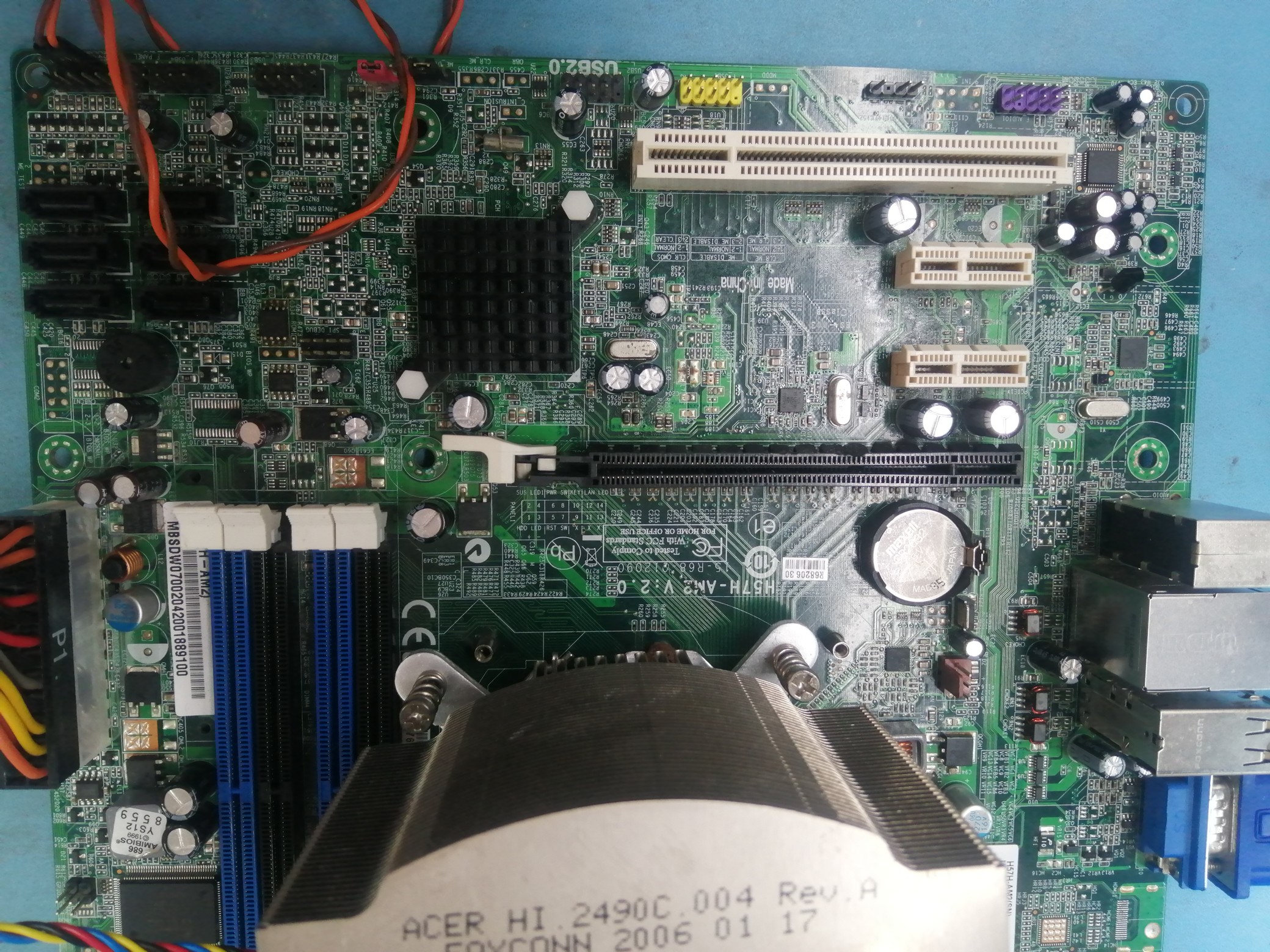

    Hi guys
    Do any of you have a datasheet for this chip RS4180BL ? I have a motherboard which has a short circuit somewhere in this area. It's an Acer H57H-AM2 V2.0. I can't find a boardview for that either.
    Does anyone have any other boardview that uses this PLL chip? That would probably help me at least identify the pins where I am seeing the short.
    I only really think there is a short as I have an MLCC capacitor right by the PLL that reads short directly across it, it's not the capacitor itself that is short, but both sides are short to ground and I don't see any logical reason for fitting capacitors to the board with both sides connected to ground.

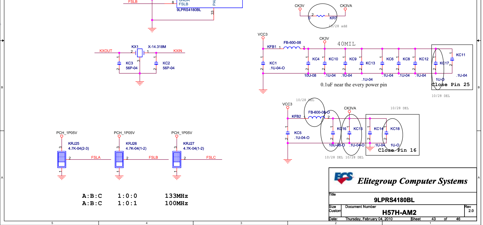

    Hi. Maybe the attached will help?
    • mon2
      • Dec 2019
      • 14660
      Re: Does anyone have a datasheet for RS4180BL PLL Chip?
      Looks to be a standard 32 pin QFN package with pin # 33 = middle ground pad (belly).

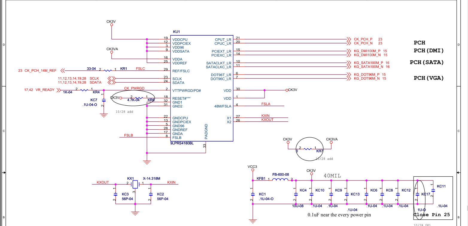

              Looking at the RS4180 I now have CK3V and CK3VA at 3.3V. The Xtal is oscillating but I have no clock signals generated. The other pins seem to make sense all bar one which is at 1.06V
              Here is what I have (Low - 0V, High = 3.3V)
              26 / 27 X1 X2 - Oscillating
              29 REF/SLC - Low
              23 SCLK - High
              2 SDATA - High
              2 PWRGOOD - High
              18 RESET* - HIGH
              8 FSLB - Low
              4 48M/FSLA - 1.06V (is this wrong???)
              All clock outputs LOW
              6 / 7 (PCH/VGA)
              10 / 11 (PCH / SATA)
              14 / 15 (PCH / DMI)
              20 / 21 (PCH)

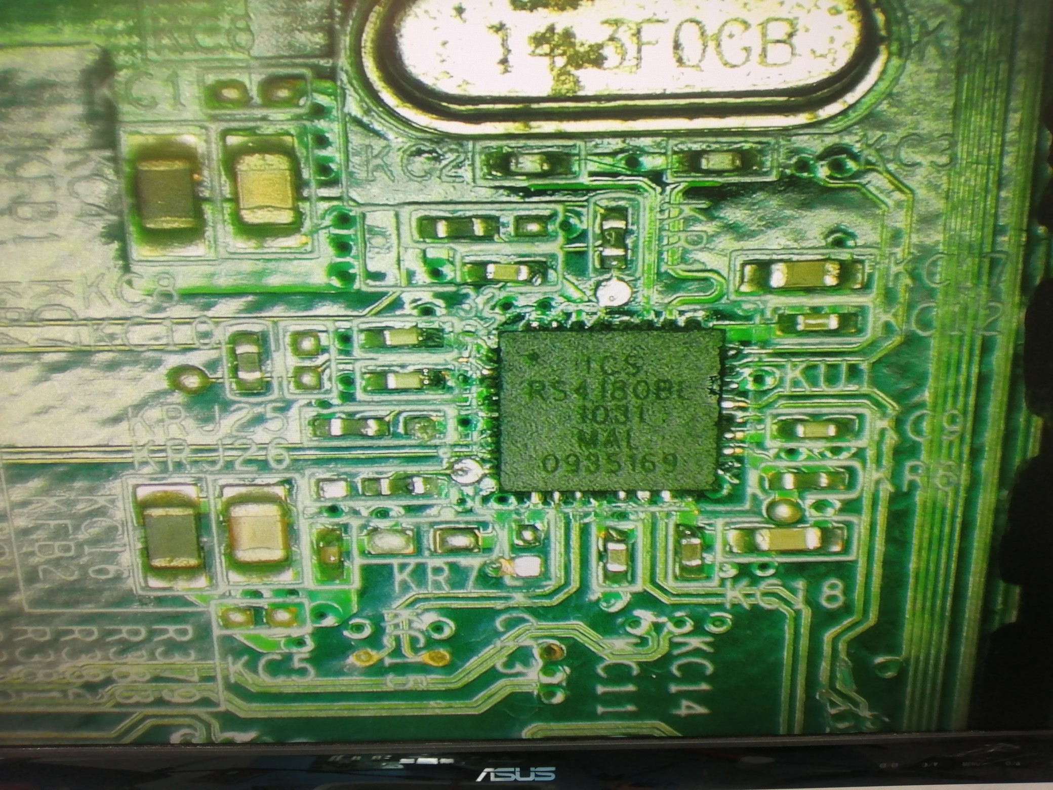

              I think my soldering is OK, please see pics and check it.
              I need to know where that FSLA signal on pin 4 is coming from or going to, what it is, and whether 1.06V is incorrect. The schematic you gave me for this chip is taken from the correct motherboard H57H-AM2. Do you have the rest of it?

                OK I can answer my own question here
                Those signals FSLA, FSLB, FSLC come from jumpers on the motherboard that set the Bus speed to 133MHz/100MHz
                The jumpers select between Ground and PCH_1P05V.
                On my board I can't see any physical jumpers for this so I guess it must be hardwired but anyway
                My CPU is i3-530 2.93GHz = 22x 133MHz
                Jumpers
                1 0 0 = 133MHz
                1 0 1 = 100MHz
                FSLA 1.06V FSLB 0V FSLC 0V = 1 0 0 so it all makes sense.
                PWRGOOD = High
                RESET* = High
                26/27 Xtal oscillator is running
                All the other pins are either 3.3V power, Ground or clock outputs, apart from two.
                Those two are 23 SCLK and 24 SDATA - Now this is an assumption but it seems possible that these clock data into internal configuration registers in the RS4180BL and thus enable the PLL. I had a look on my scope but I can't see anything happen at power on - they just go from low to high and stay there
