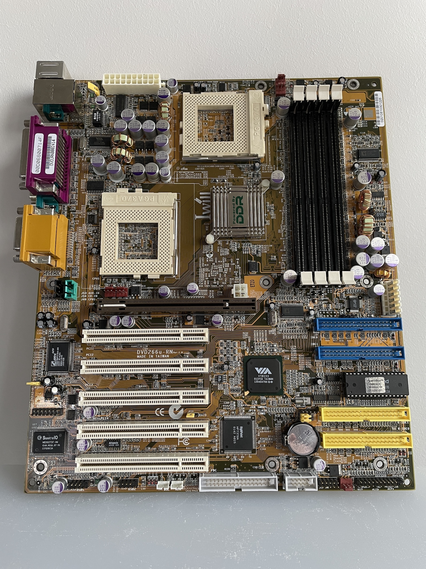

                Hello, Topcat
                I know this is an ancient post , but .... I recently purchased a Iwill DVD266U-RN board from Japan.
                just have 2 questions if you can give any advice,
                1 ...... the caps are obvious dead, I am going to recap them, I prefer using solid caps ( sanyo, coz no need to do it again for ever i believe ) , but most solid caps dont have same value as electric caps (unable to find and no need to i think).
                1. for 13 dark green 6.3v1000u caps (in PCI AGP area) , i'll use 6.3v560u
                2. for 9 purple 6.3v1500u caps (in ram area ), ill use 6.3v820u
                3. for 4 blue 6.3v4700u caps (cpu area) , 4 blue 10v2200u (cpu area) and 2 dark green 10v1500u (ram area), i'll have to use 16v1000u (this is the biggest one for sanyo solid caps)
                are they feasible ? coz this is my first time to recap ....
                2... a silly question, on the back of the mb, the melding point terminal of some caps is quite close to its surrounding metal area, just a hair of tiny gap, what if they connected/touched if my welding job is not good enough .... , will the cap shorted ?
                any suggestions will be appreciate.
                Thanks.

                    Hi Topcat,
                    happy to hear from you.
                    I saw that post as well. can you also please share the back view of the motherboard , just want to see the terminals of those caps.
                    thanks.

                        Hello topcat,
                        i have finished the recap and all good , but has 2 probs.
                        1. i plugged 2 piii-1.4s, but can only detected 2x700Mhz.
                        2. i cannot boot with 4G ram, even with 3G, sometimes it's stuck on ram checking. (i am using corsair 4x1G dedicated ram)
                        can you share any reasons?
                        thanks a lot.

                          Originally posted by Matt_Li
                          Hello topcat,
                          thanks a lot.
                          You need to set the FSB speed. It's default @ 66 (locked multiplier of 10.5), which is why you're only @ 700MHz. It sees both CPU's....good sign. You have to manually key it in, set it to 133, CPU's will show the correct speed then. If you're feeling frisky, you can try setting it higher....150 wasn't unheard of with these boards with good RAM & cooling....and of course chips that were friendly...but before venturing there, get it running correctly first.
                          I never was able to get 4GB to run right in this board either; it's not 'officially' supported by the chipset either even though some claim it can do it. I've gotten it to run on 4GB (boot reliably), but it was never really stable. 2GB seems to be the happy place....and on a 32 bit system running XP or Win2k, it's really plenty. I'm running 4x 512mb Micron modules in mine and don't have any memory related issues that this chipset was notorious for.

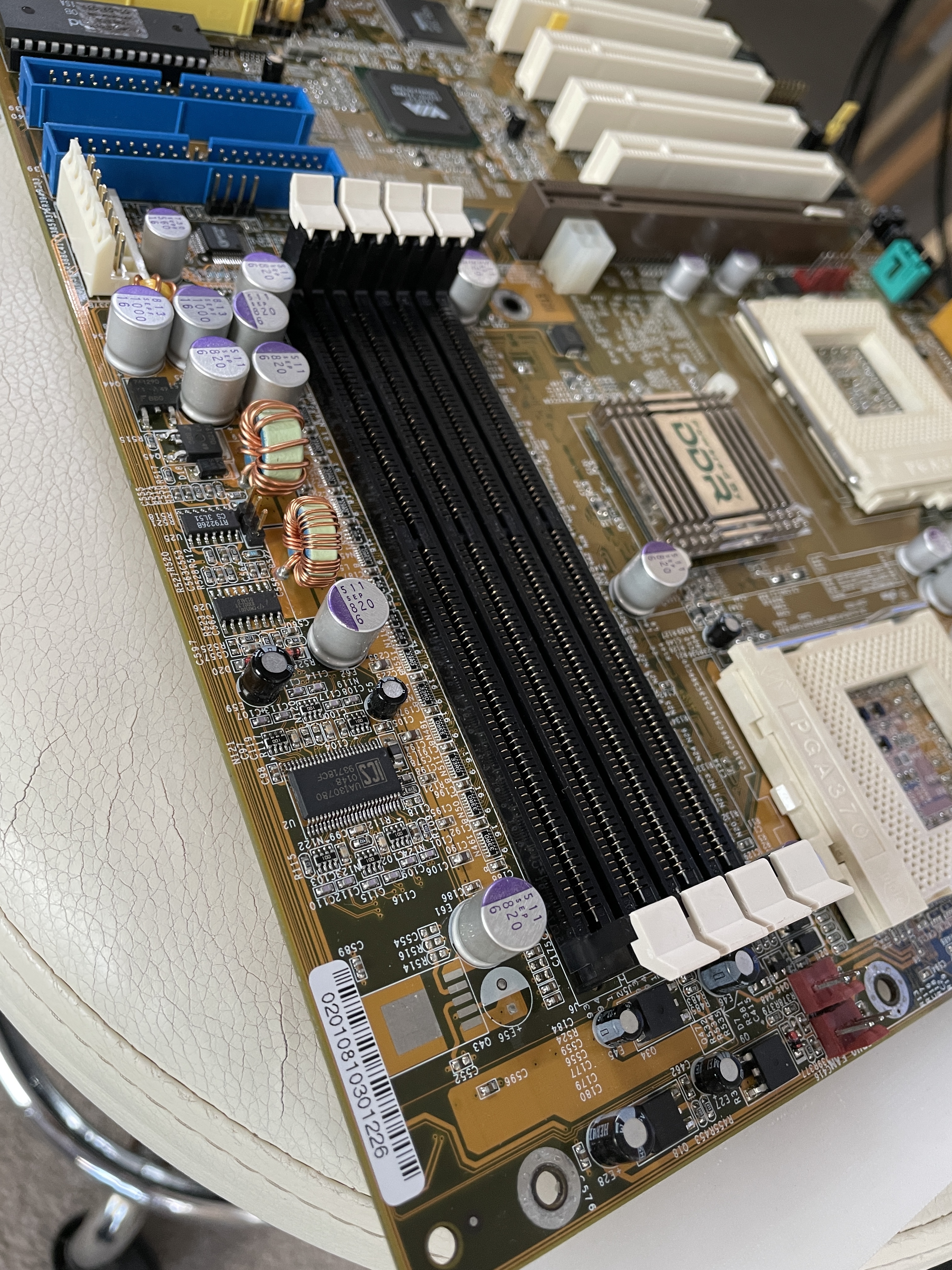

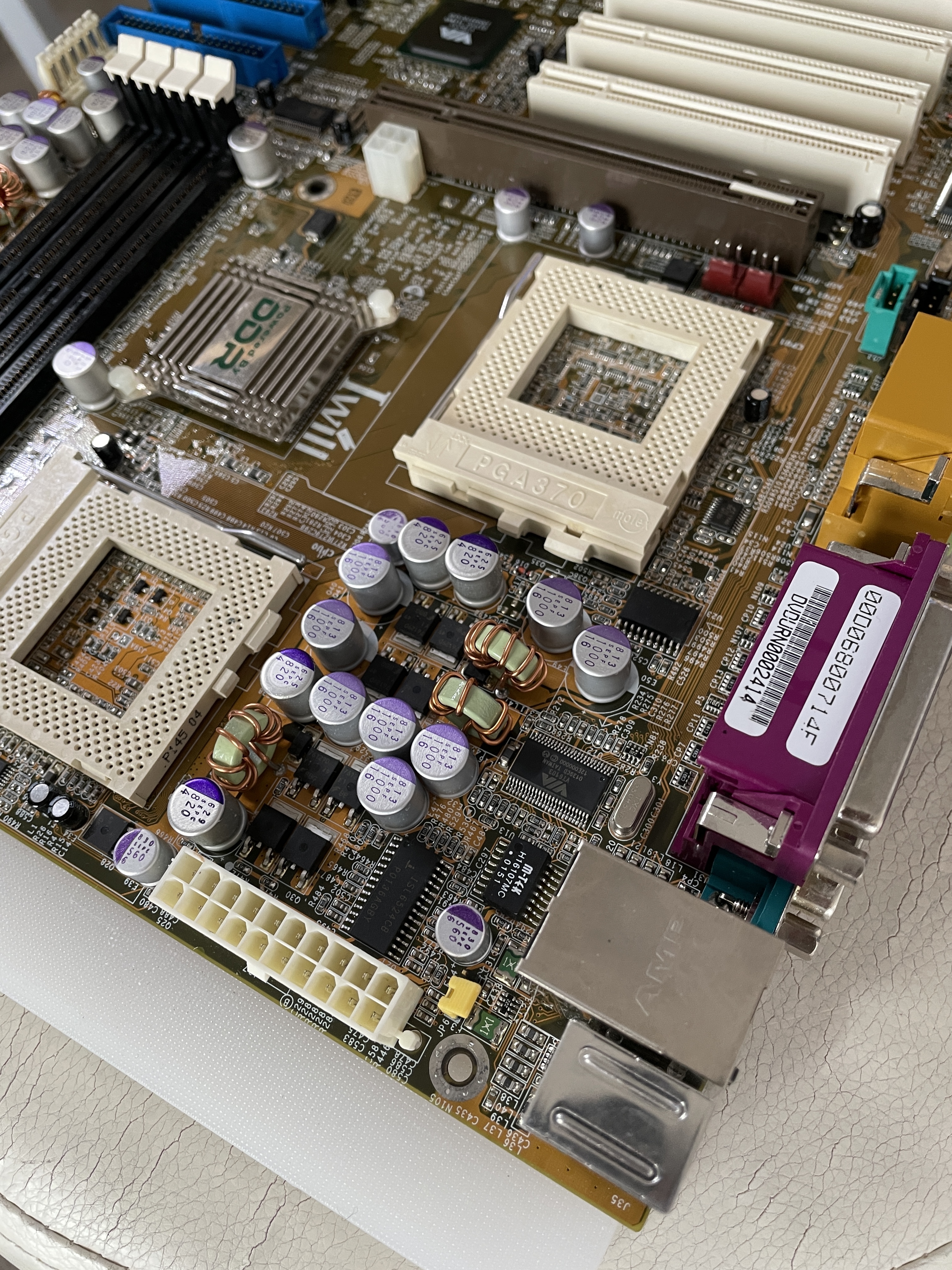

                            Hi very happy to see your comment.
                            it's correct, i've checked the 'iwill smart setting', and the default is 66mhz, not sure why, i had a supermicro P3TDDE, which can by default let PIII-1.4s run at 1.4GHz, and can use 4x1G pc-133 rams without issues. thus i guess this dvd266u-rn can do as well.
                            the ram info, i checked it from here : https://theretroweb.com/motherboards/s/iwill-dvd266u-rn there is the official pdf , at page 15, with a section mentioned max system memory up to 4GB.
                            and fyi, i please check my shared post-recap photo , i think it's a beauty , haha.
                                Looks good. I still have a P3TDDE as well. It's a sdram board versus the DDR of the u-rn...both nearly impossible to find these days. Now to grab yourself a voodoo5 for yours. The perfect icing on the cake GPU for one of these.
