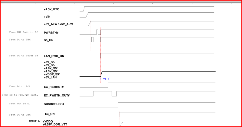

    Hi, have an AIO from HP model hp 20-c005nt with no power-on and blinking led problem.
    Power led blinks 7 times and repeats in a endles loop.
    +1.5V_S5, +1.8V_S5, +3V_S5 and +5V_S5 are present.
    LAN_PWR_ON and EC_RSMRST# are low.
    I know that EC_RSMRST# should be high but it doesn't
    Bios chip and IT8987E/BX has been programmed whith good data. (I think)
    Can someone help with this board?
    Board is a Quanta N91C.
